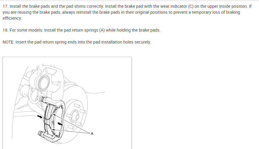

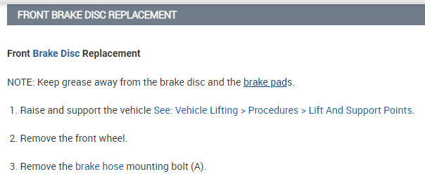

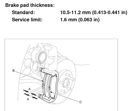

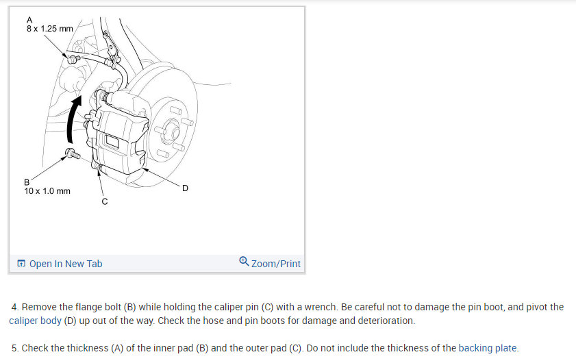

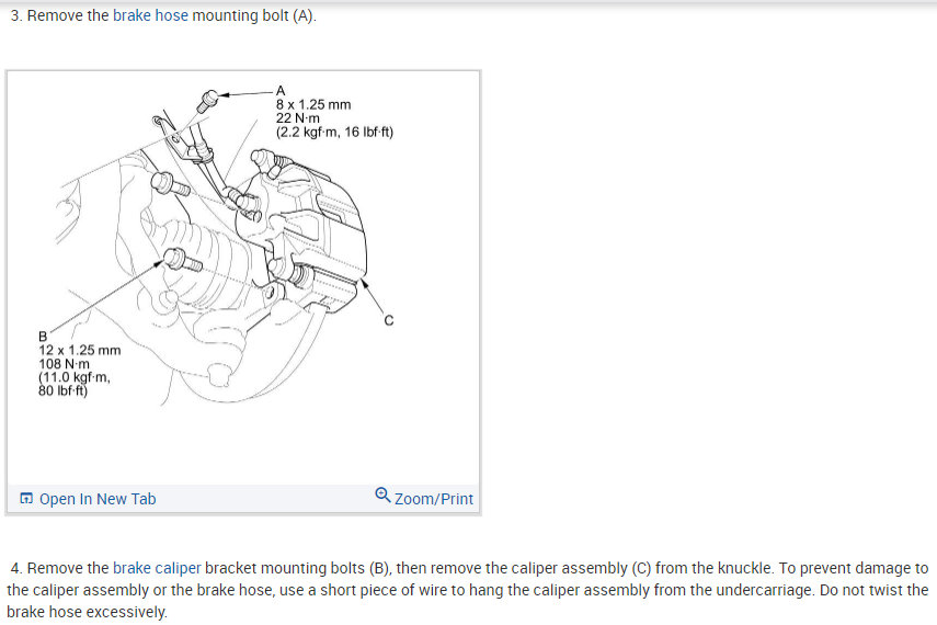

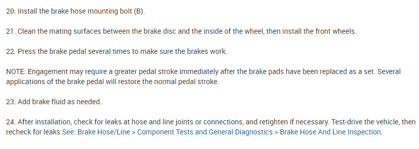

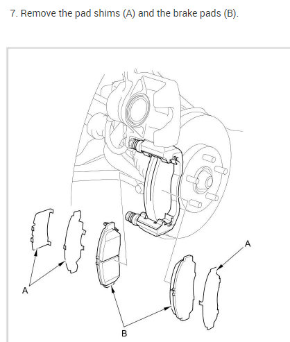

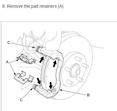

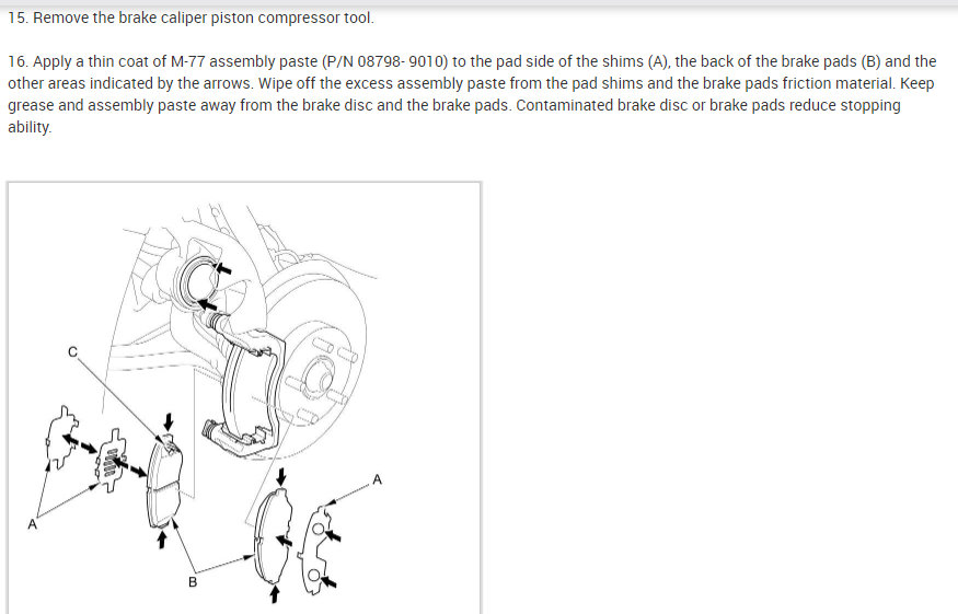

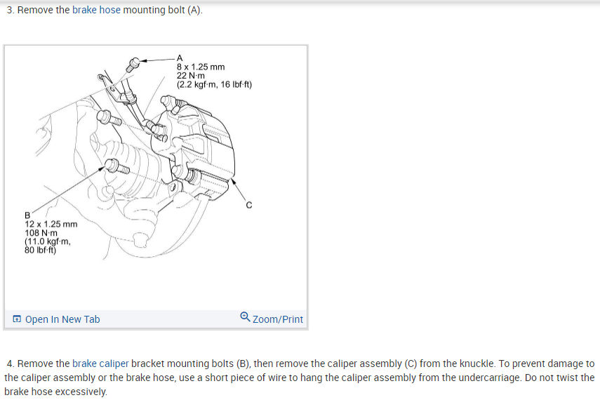

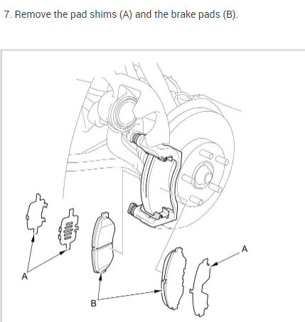

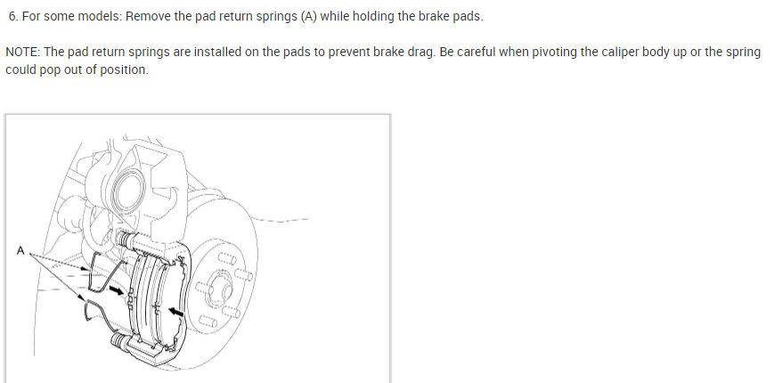

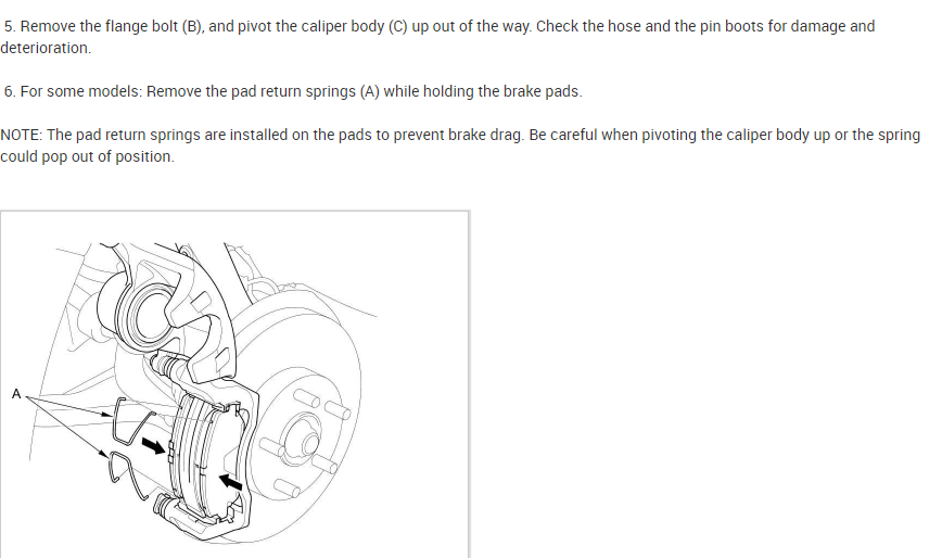

Okay so here's the situation. On my way out of the car I out some things down to get them all in my bag. I left the driveway and noticed the brakes were grinding
Aug 12, 2015 at 8:45 PM
DANNY L
  • 5,648 POSTS

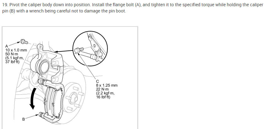

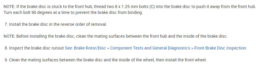

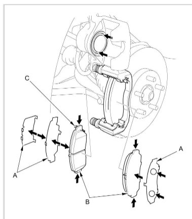

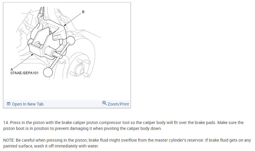

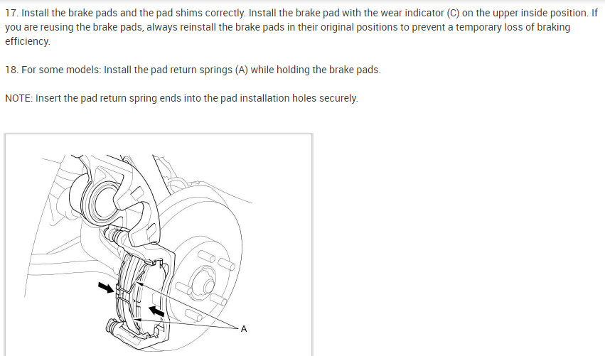

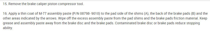

Hello, I'm Danny.

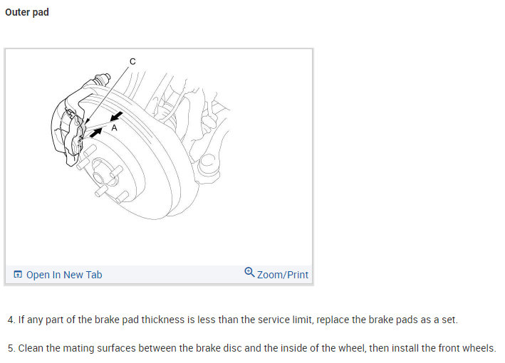

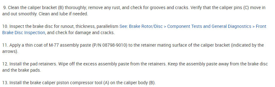

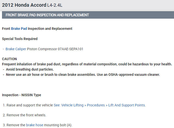

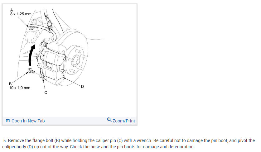

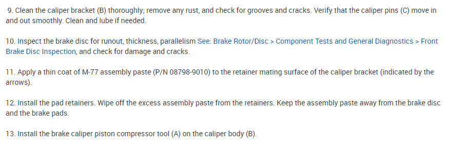

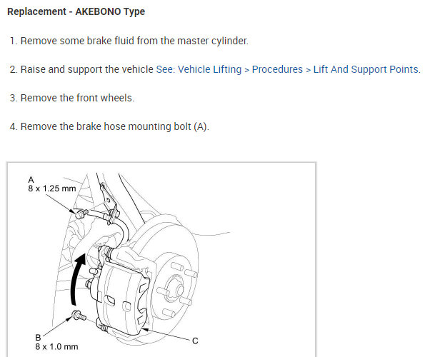

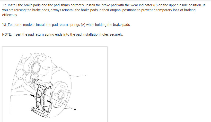

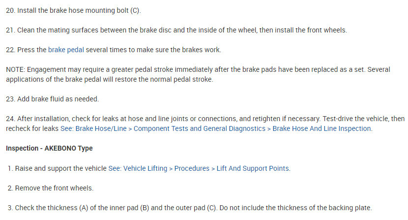

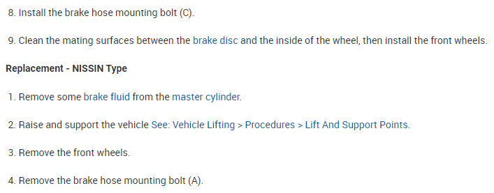

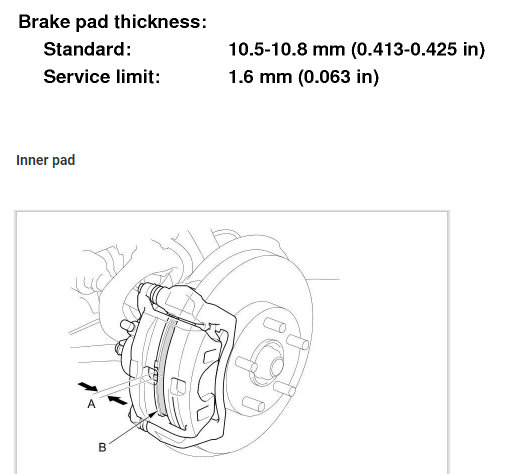

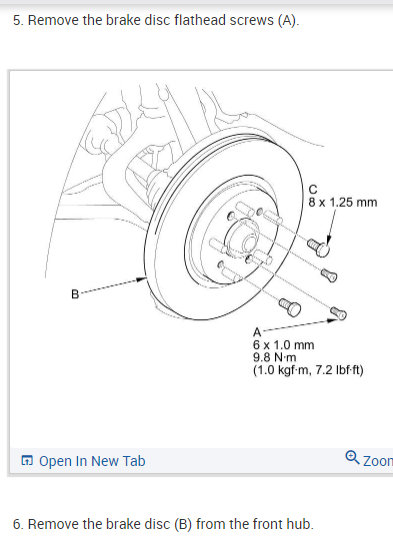

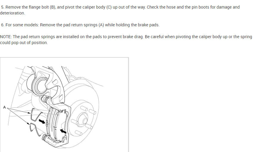

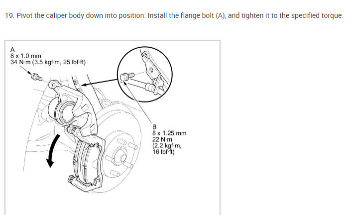

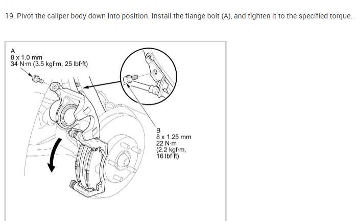

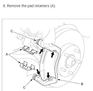

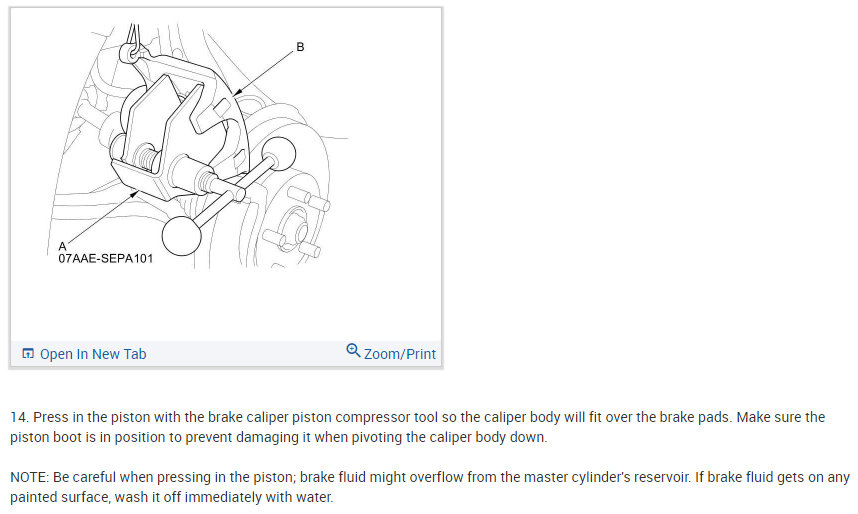

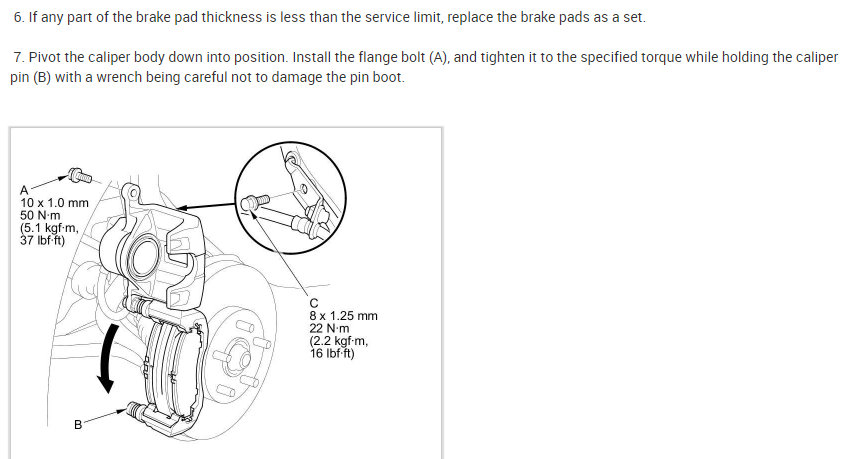

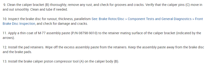

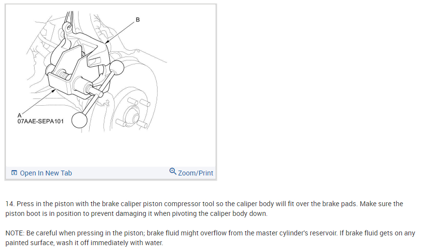

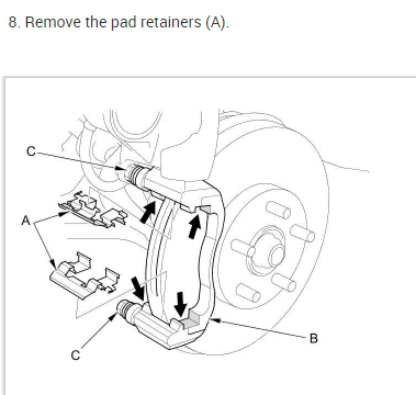

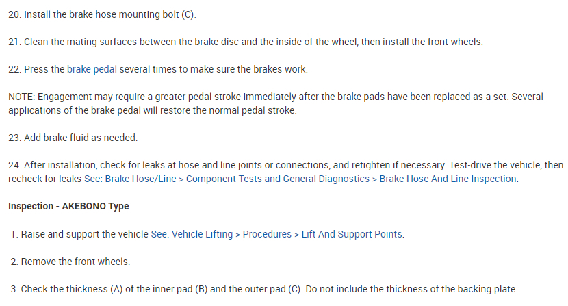

Here is the information you requested. This is a tutorial showing what is involved on how to change front brake pads and brake rotors:
I've attached picture steps below on how to change the front brake pads and rotors on your car. Hope this helps and thanks for using 2CarPros.
