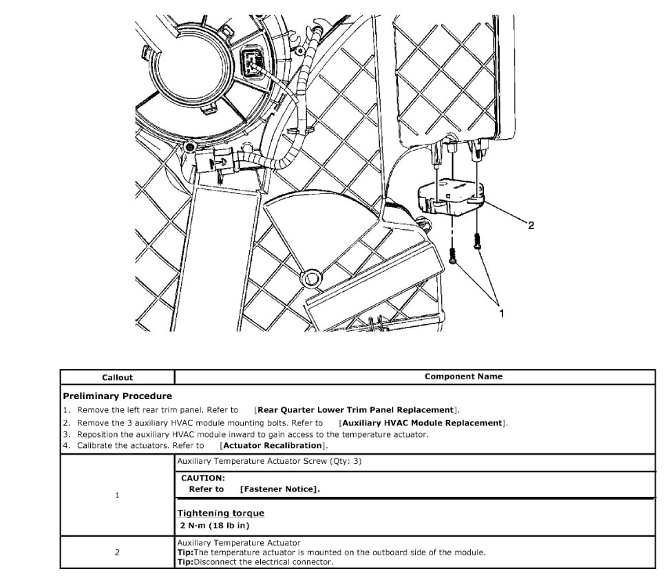

The rear A/C stopped working a few years ago. The front works great! I think an actuator door is stuck. Can you tell me where to find the rear climate control actuators and fan? And how to get to them if they are behind a panel of some sort?

Yes, here is a guide to help you see what you are in for when doing the job with a diagram below of what it will be like for your car:

Thank you. This does not show the rear system. The front system works fine. The rear system functions separately from the front. Where might the rear system actuator doors be?

CHRISTOPHER MICHAEL

That is the rear system they call it auxiliary. Please let me know what happens.
