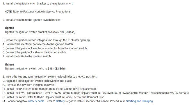

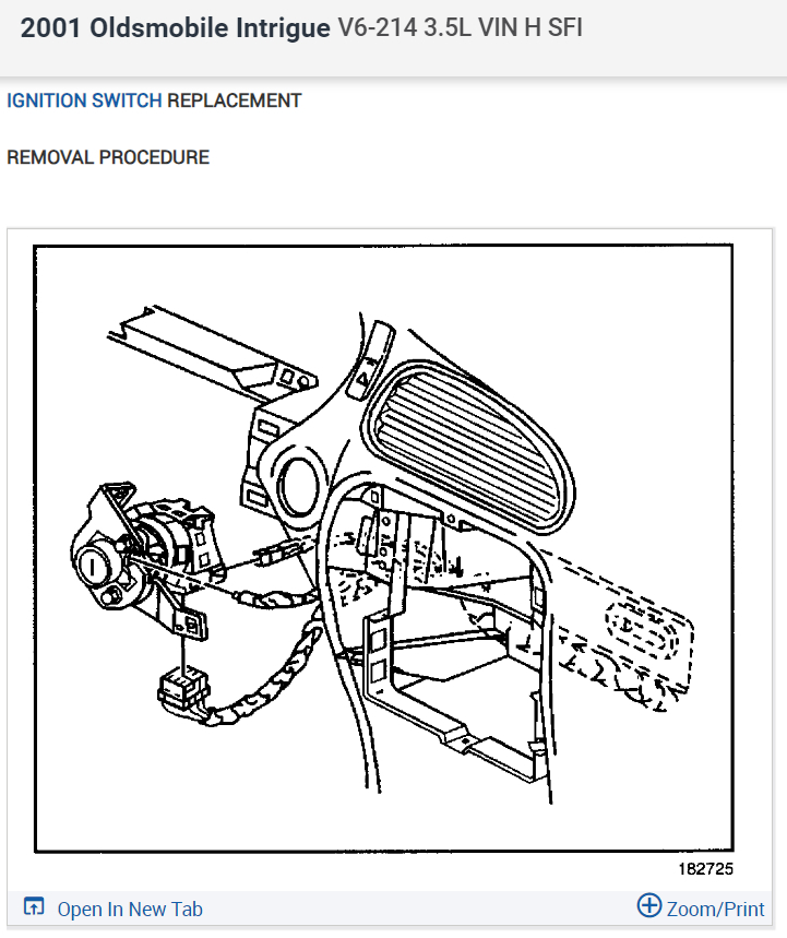

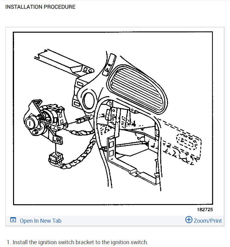

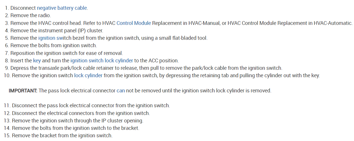

To me it sounds like the ignition switch is bad, to be sure check for power at the starter trigger wire when the ignition switch is in the crank position, this guide can help:
Check out the images (below). Please upload pictures or videos in your response to any problems so we can see what to help you with.
May 13, 2024 at 1:03 PM

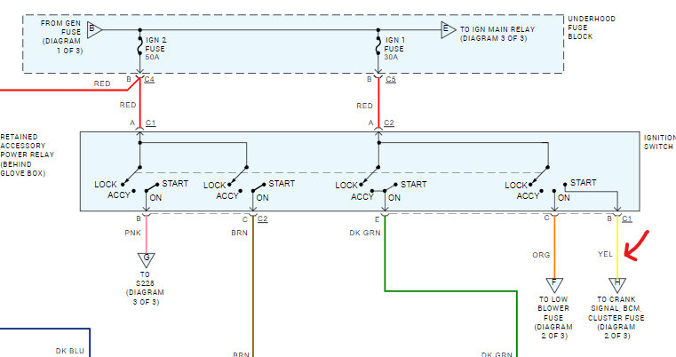

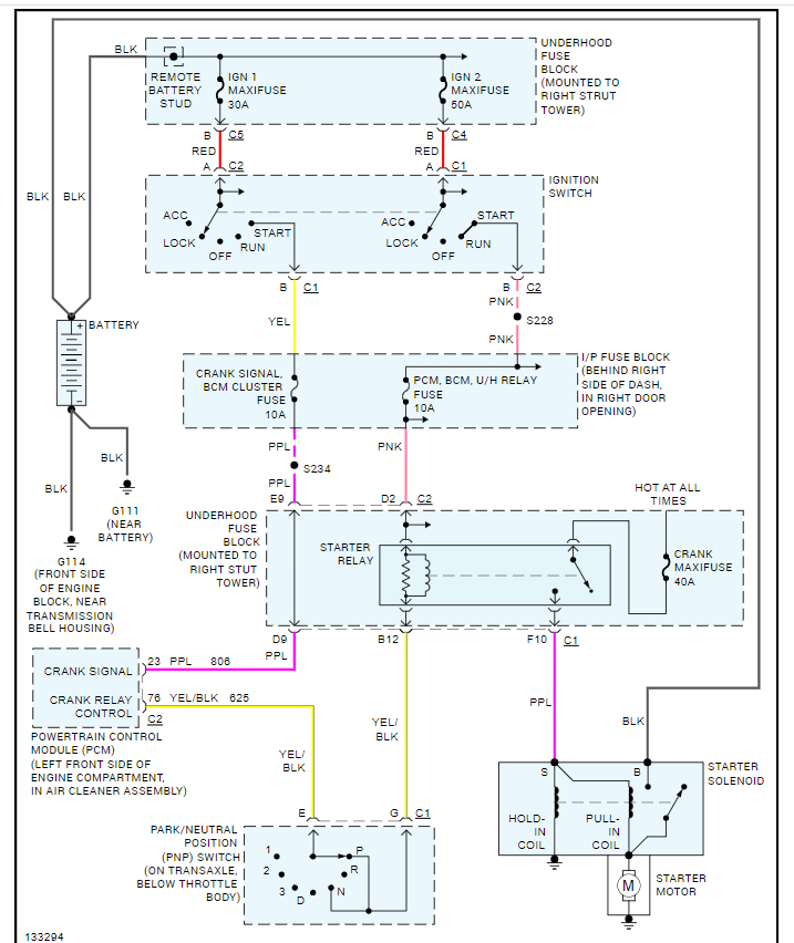

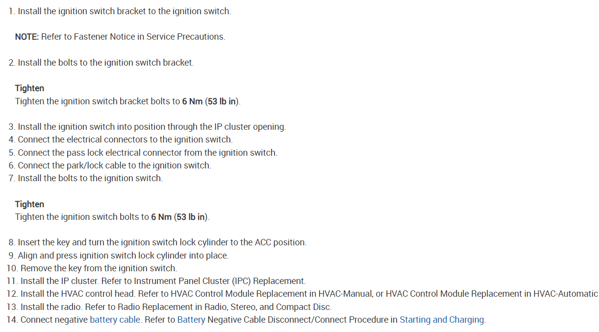

Thanks for the video. It looks like one of the legs of the ignition switch has gone bad, to be sure let's use this guide and the wiring diagrams below to check for power at the yellow wire when in crank:

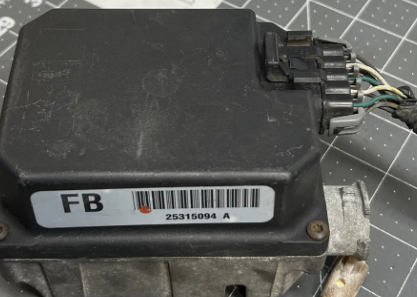

So, you remember I told you there was two things clicking when you hit the switch the thing underneath the passenger side dash and then there was a little box of the black cover underneath the hood that would click and wouldn't let me upload the picture, but there is the number on it. I don't know if you could look it up tell me what it is capital letters top left corner FB below is the number 25315094A. I haven't had a chance to test the ignition switch out I've been really kind of busy but I'm going to try to get around to that this evening and I will let you know something shortly after.

The part number is for a cruise control servo module. See pic below. Is that what you are seeing?
See pic below.

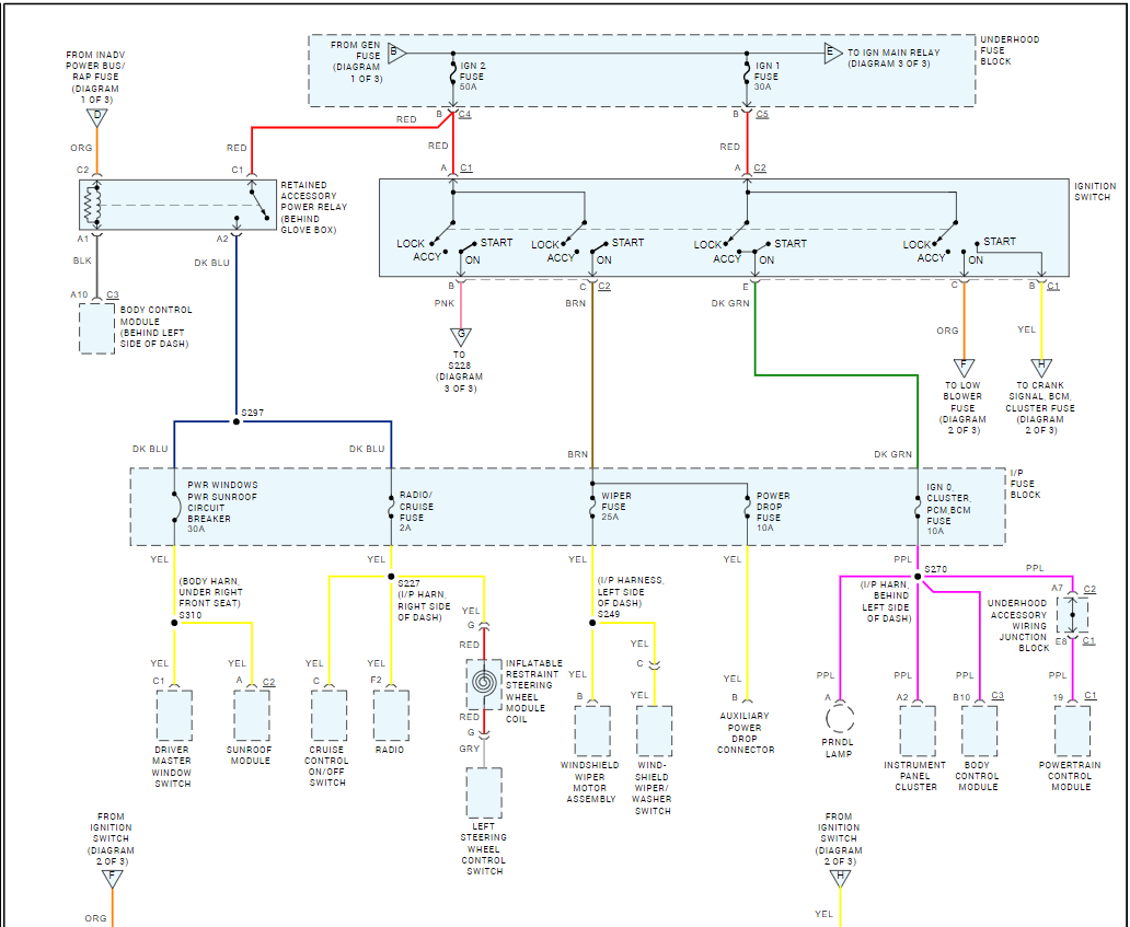

Nice work, here is the complete wiring diagram for the ignition switch and I included the starter motor wiring diagrams as well. Check out the images (below). Let us know how it goes.

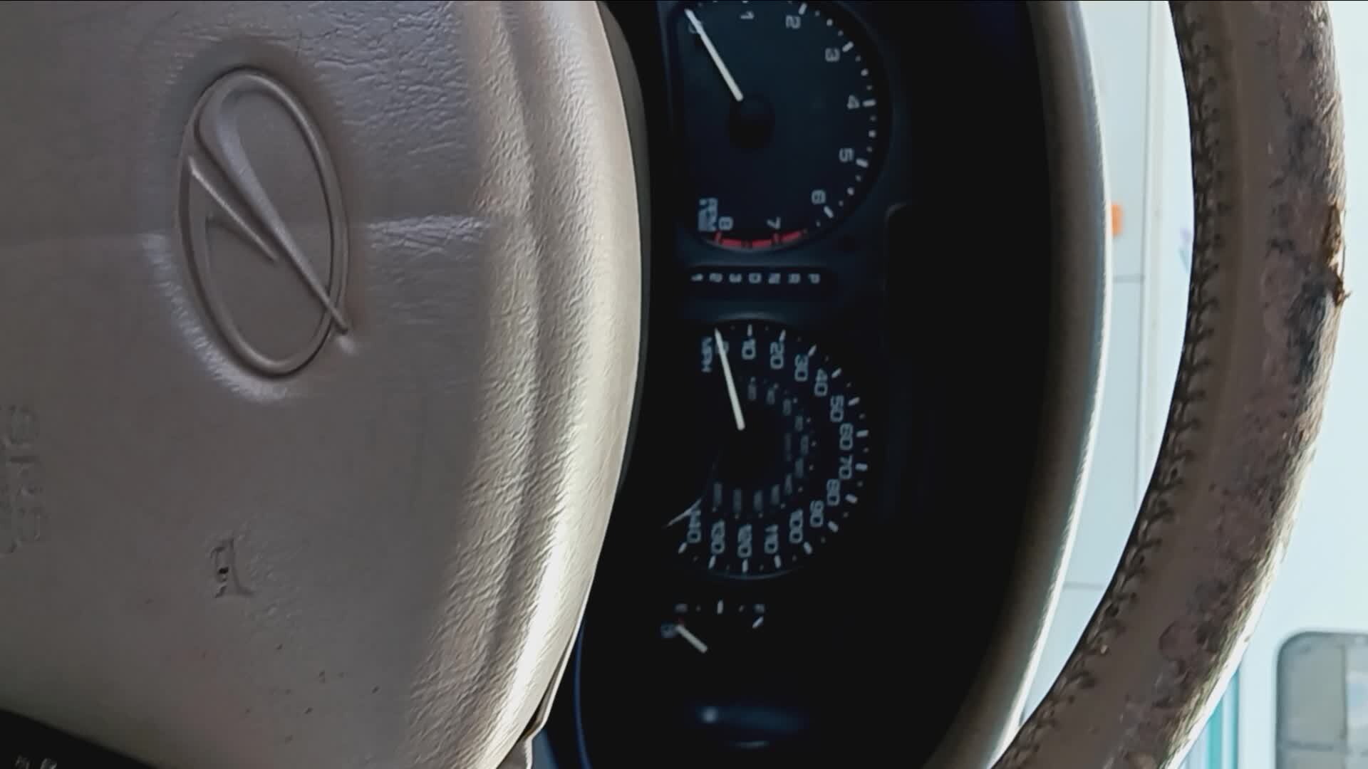

This is a different video I took it was actually acting kind of decent to that on that day but still acting like a piece of junk.

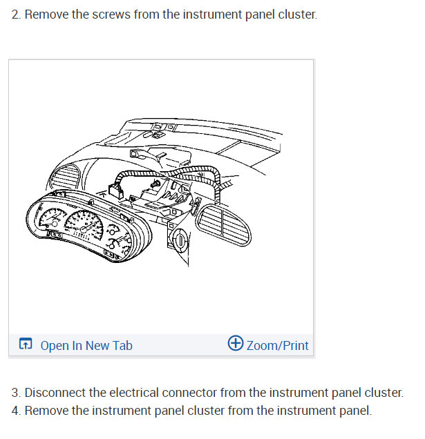

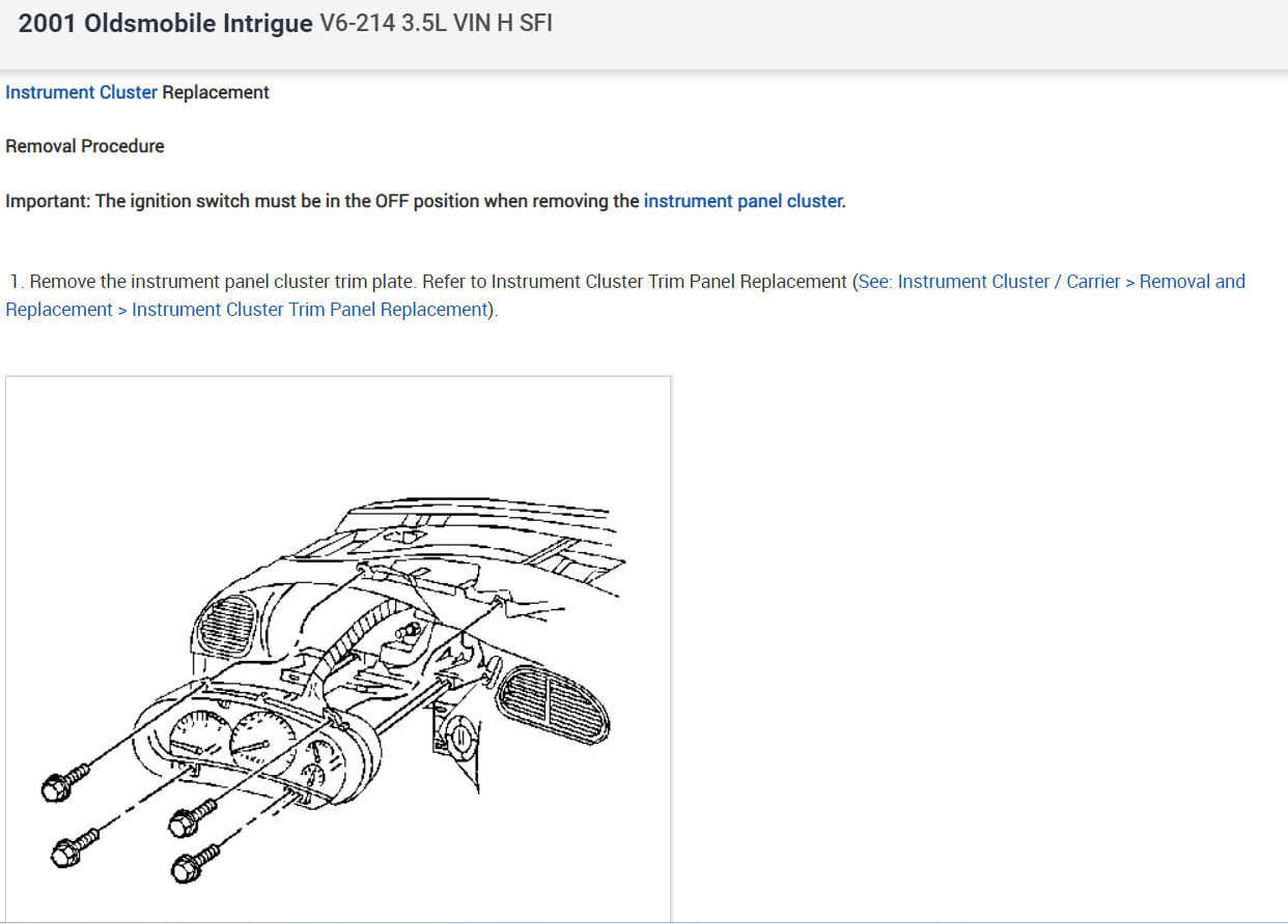

Yep, it looks like the cluster is going out, I would search google or Ebay to see if I could find a rebuilt unit, here is how to swap the cluster out, thanks for the video, it helps. Check out the images (below). Please let us know what happens.
