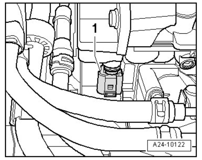

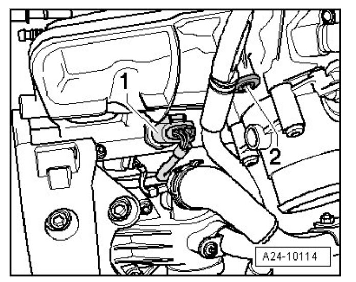

The P0190 is specific to the fuel pressure sensor. The P0343 is for the camshaft position sensor. I attached pics below for both. Check to see if everything is properly connected.
Next, can you describe the sound? Does it change with engine speed? Is there anything you can do to change it? Also, if possible, record and upload it for me to hear.
Pic 1 CMP Pic 2 FPS
