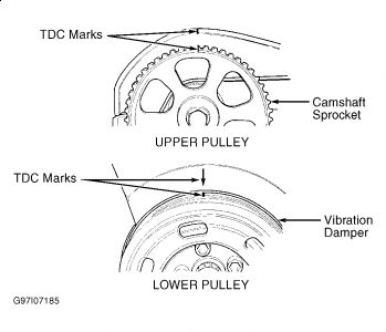

Timing belt tensioner was bad, timing marks not aligned. I replaced Timing belt, tensioner, water pump, ect. Realigned timing using mark on crank pulley and mark on cam gear with valve cover case. No compression, engine won't start. I pulled the valve cover off to look at cam gears/chain. No marks on rear cam gear.
Where should the cams be positioned in relation to TDC of crankshaft?
Nov 28, 2009 at 8:03 AM
DAVE H
  • 13,384 POSTS
Hello .. thanks for the donation .. much appreciated Timing Belt Installation CAUTION:To prevent pistons from hitting valves, make sure crankshaft is NOT at TDC for any piston before turning camshaft. Place timing belt on crankshaft sprocket (if reusing belt, observe direction of rotation). Install lower part of timing belt cover. Install vibration dampener. The hole in the vibration damper must be located over the raised part on the crankshaft timing belt sprocket. Tighten vibration damper/pulley to specification. See TORQUE SPECIFICATIONS . If necessary, align camshaft sprocket-to-cylinder head cover positioning marks and vibration damper-to-timing belt cover positioning marks. See Fig. 14

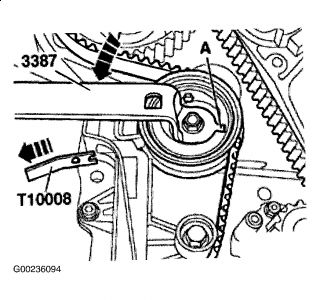

Install timing belt in this order: water pump, tensioning pulley, camshaft sprocket. NOTE:If the timing belt tensioner has not been restrained and is at its travel limit, it must be pushed back in the installed position together with the pulley. This procedure can take up to 5 minutes. When compressing the tensioner, excessive force can damage the tensioning pulley. Push pulley on counterclockwise in direction of arrow with a socket head wrench using even (but not excessive) application of force until tensioner piston can be locked with Locking Plate (T10008). See Fig. 15 .

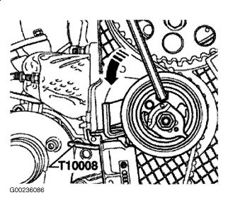

Turn eccentric bolt counterclockwise in direction of arrow using special tool (3387). See Fig. 21 .

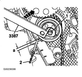

Hold eccentric bolt in this position and remove locking plate. Turn eccentric bolt clockwise to right in direction of arrow until a gauge with dimension of 8 mm (e.g., drill bit) can be passed between tensioning lever and tensioner housing. See Fig. 22

I familiar with all the procedures for replacing a timing belt. I just want to know before I put my vale cover back on, how to verify the precise position of the cams. Should both key slots on rear cams be at the 12 O'clock position to ensure both cams are in tune? Are there any hard to locate timing marks on rear cam gears?

Hold eccentric bolt in this position and tighten pulley nut to specification. See TORQUE SPECIFICATIONS . Turn crankshaft two complete turns by hand in direction of engine rotation until crankshaft is at TDC again. Mark on camshaft sprocket and mark on crankshaft must be at TDC cylinder 1. See Fig. 14

My check engine light was on for "cam position sensor". I was informed it meant that cam was off by one tooth. I screwed up and move the cam with the belt off trying to find the sweet spot. Now my car won't start! was asking if you could tell me by looking at the valve train (valve cover off) are there any distinguishing marks to verify the dual cams are in tune with crank at TDC. If the cams are not timed, would that be the cause of my low compression problem. Is there a procedure? Is the cam mark on outer wheel with valve cover my only way to verify correct timing?

The only way of verifying the cam and crank are timed correctly is using the marks on the pulley's .. you cannot tell by just looking at the valve train ..incorrectly set cam and crank will give low/no compression as the valves will be open at the incorrect time ! NOTE :- trying to start the car with incorrectly set timing of valves in relation to crankshaft can cause damage to the valve's !! The check engine fault code for "cam position sensor" was telling you the SENSOR was bad not that the camshaft was out one tooth unless this code only came up after you had adjusted the cam/crank in which case it could be out more than one tooth !! ... the CMP picks up a signal from the camshaft's which tells the PCM/ECM (computer) when to fire the injector's/spark ..if the timing is out it picks up late/early signals ... when the CMP sensor gets worn/dirty/faulty it picks up late/early signals !! You stated in your first post that the tensioner went bad causing the timing marks to be out !! did the belt slip/jump on the pulley's ?? .. If the original cause of you commencing this repair was the fact that the timing marks were not aligned due to tensioner failure ? .. I would be suspecting there may be valve damage as this is an interference engine ? Could you please tell me your original fault before you commenced work ? ie. was the car not starting/running rough etc. etc. .. the more details you supply the better we can diagnose ? Hope this helps
