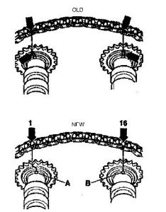

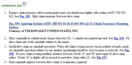

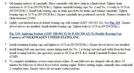

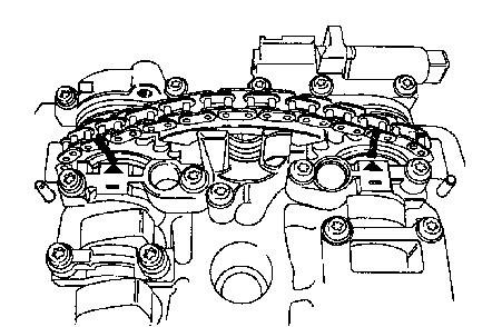

I needed to replace the timing belt an camshaft drive chain tensioner. I took everything off, and forgot to mark the position of both camshafts. I have the Haynes manual but it doesnot tells what is the right position for the camshaft. can you help me with this? Please

Hello Thanks for the donation Below are the instructions for installing a the camshafts. The diagram will show you the position of the camshafts for using the old chain or new chain.

FIG. 107
https://images.2carpros.com/forum/automotive_pictures/261618_Noname3_9.jpg
FIG. 108
https://images.2carpros.com/forum/automotive_pictures/261618_Noname_51.jpg
Let me know if this helps. Thanks for using 2carpros.com!

Your answer was very helpfull. Thanks again!
