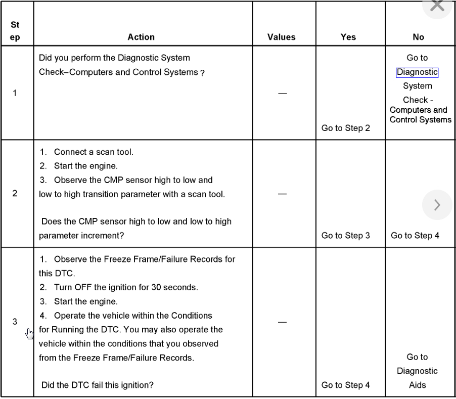

Sometimes my car starts up no problem really easy and sometimes it takes a long time. it was shutting off just randomly did you start back up like nothing wrong especially at an idle for a long time.

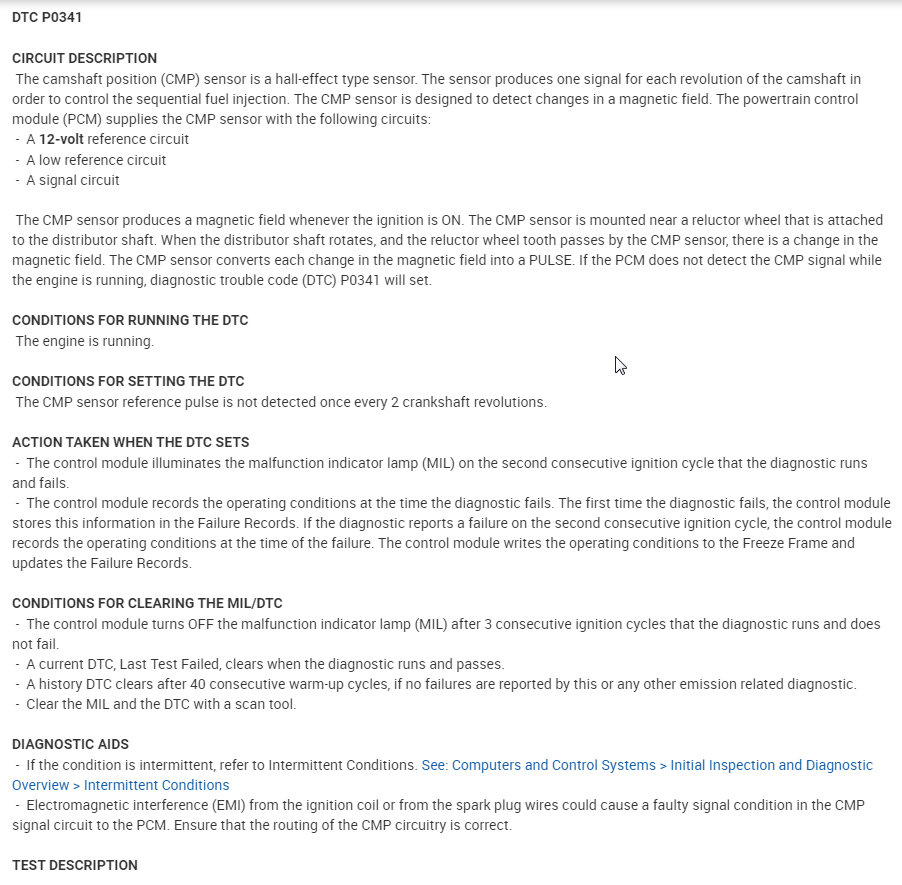

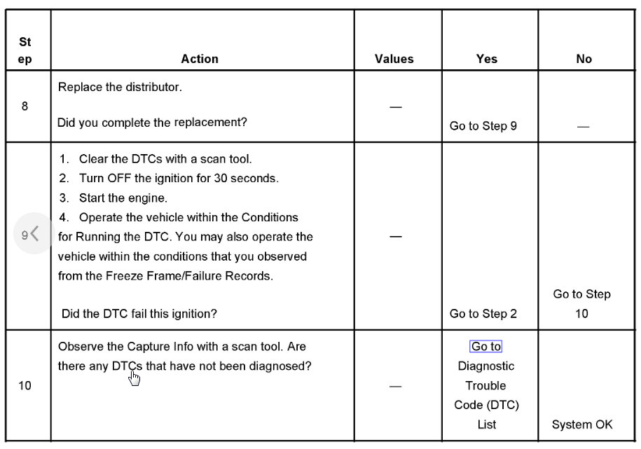

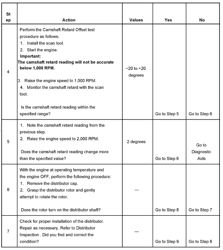

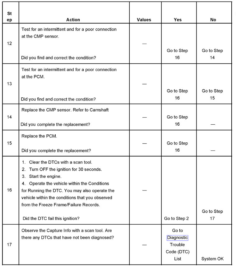

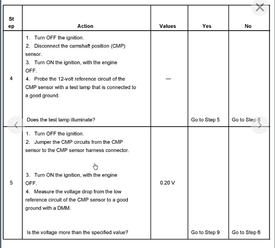

P0174 P0016 P0171 P0341 are the DTC,s I'm getting which led me to believe it was the mass airflow sensor sadly was not the culprit .
Oct 14, 2019 at 7:49 PM

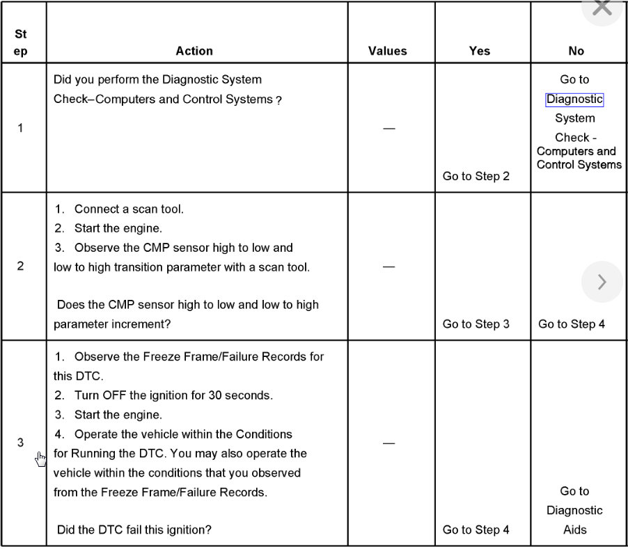

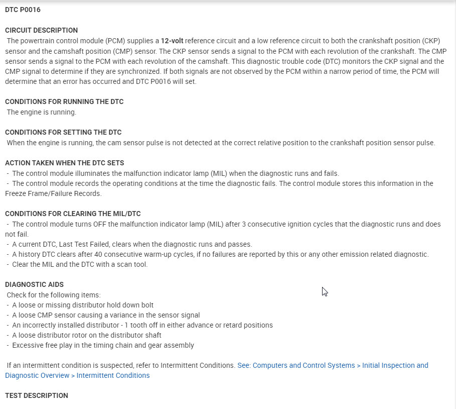

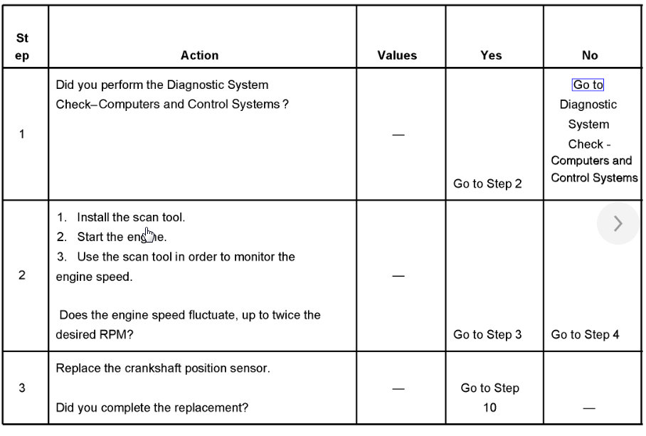

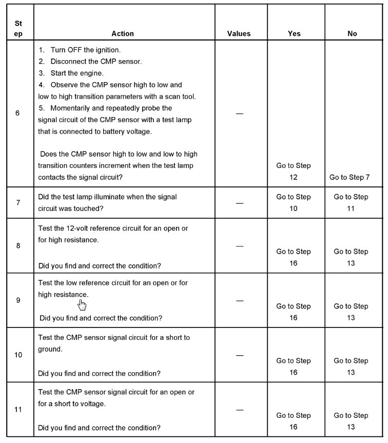

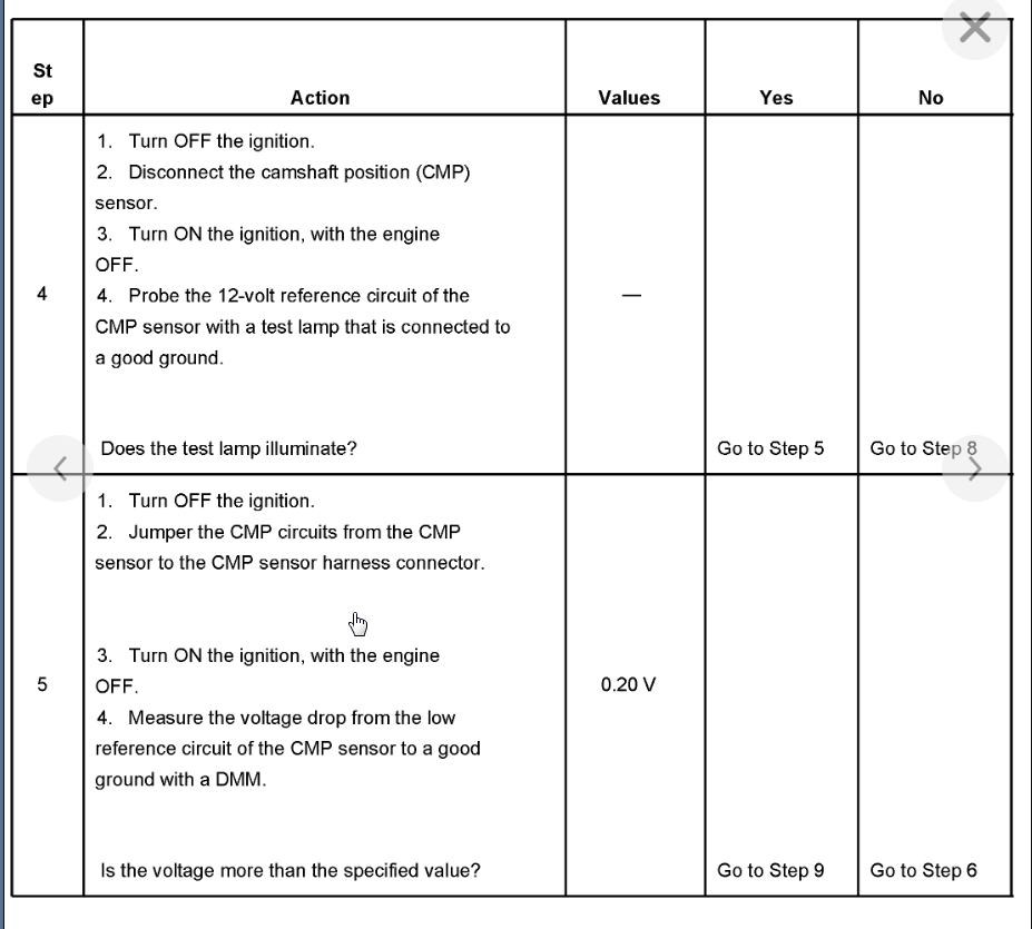

Okay. The P0171 and P0174 are lean codes saying that you have more oxygen in the exhaust then expected. Below is a guide going through the detail on this.
P0016 is a cam and crank misalignment code.
P0341 - is a cam sensor fault.
I would suggest running through the P0341 then the P0016 diagnostic because the lean exhaust could be a result of these.
I know you put a cam sensor in it but that is not the only cause of these codes. You will need to perform the tests that are detailed in order to find the cause. Unfortunately, if we don't we will just be guessing.
