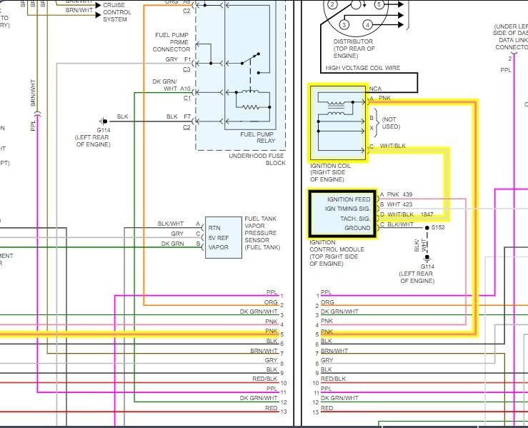

Hi, I have a 1999 Chevrolet Blazer with 121,000 miles on it. It has a 4.3 liter engine, automatic transmission and 4 wheel drive.
I was driving home one night from work and got about 10 minutes into my journey and all of a sudden just shuts off of no where. No chugging or rough running just quit running. Pulled over tried to start it cranked fine, but nothing. I have checked the fuses (that I know of), replaced the fuel filter, and have also listened to the fuel pump to see if its turning on, turns on fine. When I replaced the fuel filter it did give it a lot more pressure then what it was giving before, I don't have a pressure gauge, just kinda eyeing it : ) I never had any problems before with it always started up fine and no chugging on the road.
Thanks any help would be greatly appreciated.

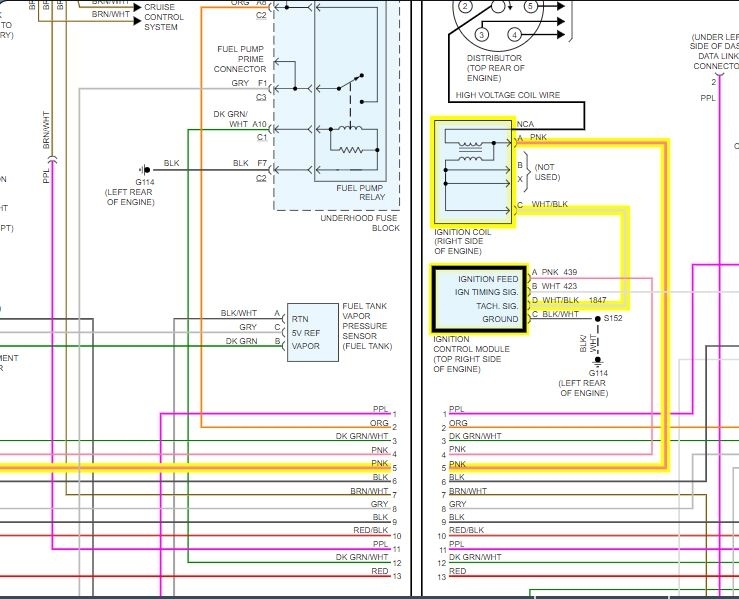

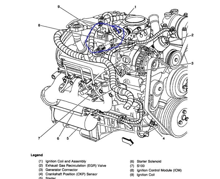

  • 52,797 POSTS
Good evening,
This sounds like a loss of spark.
Is the check engine light on? If it is, do you know the code?
I doubt it is the crank sensor since the fuel pump runs. If that sensor was bad, the fuel pump will not run.
I think you have either a bad coil or module for the ignition system.
You need to test for power to the coil positive with a test light. Then go to the negative side and have someone crank it. The test light should flash.
If it does, the coil is bad, if it does not the ignition module is bad.
