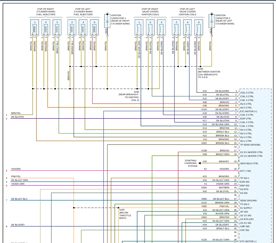

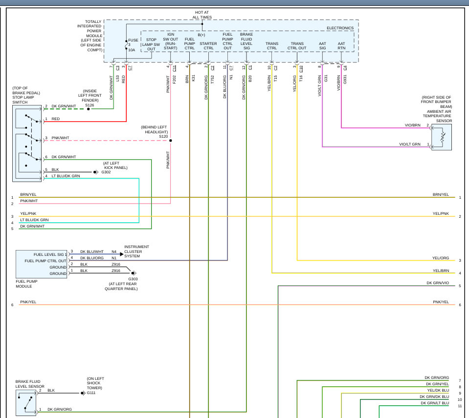

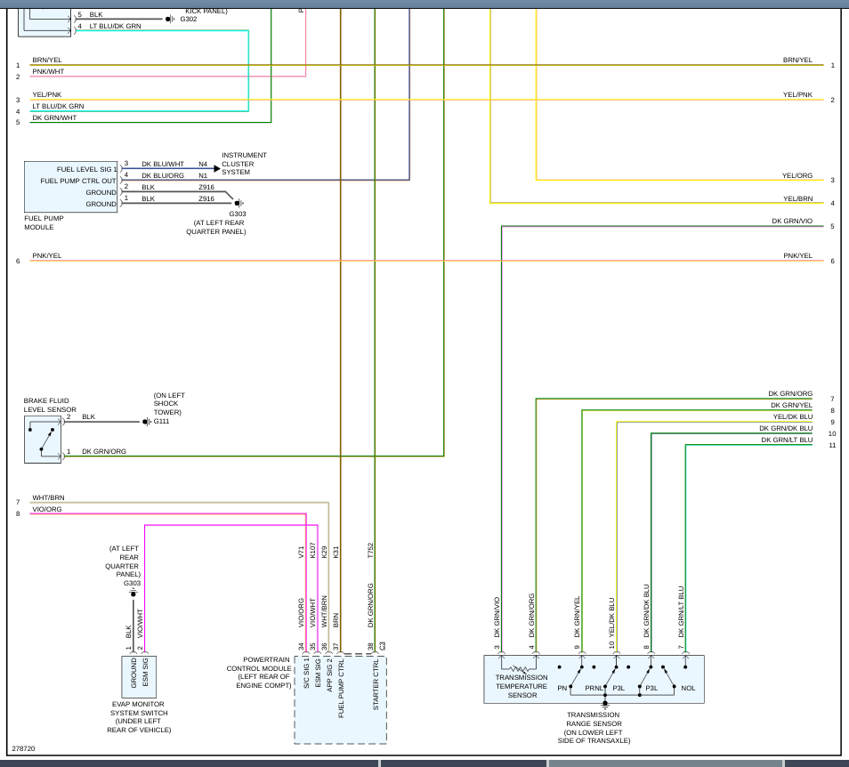

Hi there, I’ve been trying to fix the misfiring going on with my car listed above. In the beginning I had misfires and open circuit on 5 and 6 code for torch converter, random misfire but when resetting, 6 didn’t always come back. I’ve had it throw all sorts of codes at me in the process troubleshooting down the line. So far I’ve replaced the PCV valve and hose, all spark plugs, all boots, and injector 5. In the process I did also switch injectors 2 and 6 to see if the codes moved but they didn’t so I put those back. After doing all this the car was running great for a day and check engine light actually went off but then day 2 it started misfiring again. It’s now got a bunch different codes. Random misfiring, misfire and open circuit on 2, 4, and 6, and torch converter. Injectors 1,3, and 5 are under manifold but I tested ohms on 2, 4, and 6 injectors and 4 and 6 were 14.2 but I couldn’t get a good reading on 2 because it was bouncing around and jumping up past 16. I felt like that injector on 2 was really loud too and I could touch the rail and really feel that thing kicking harder then the others.
What would you do next? Any help is so so greatly appreciated! I am new to all this so I know I’ve made things harder on myself then necessary due to the lack of experience. I’m hoping I can get some direction on what to do next so I don’t take the long drawn out route like I have been. I’m in dire need of figuring this out because I’m missing work for over a week now. Help!
Dec 29, 2019 at 2:34 PM
SCGRANTURISMO
  • 4,897 POSTS

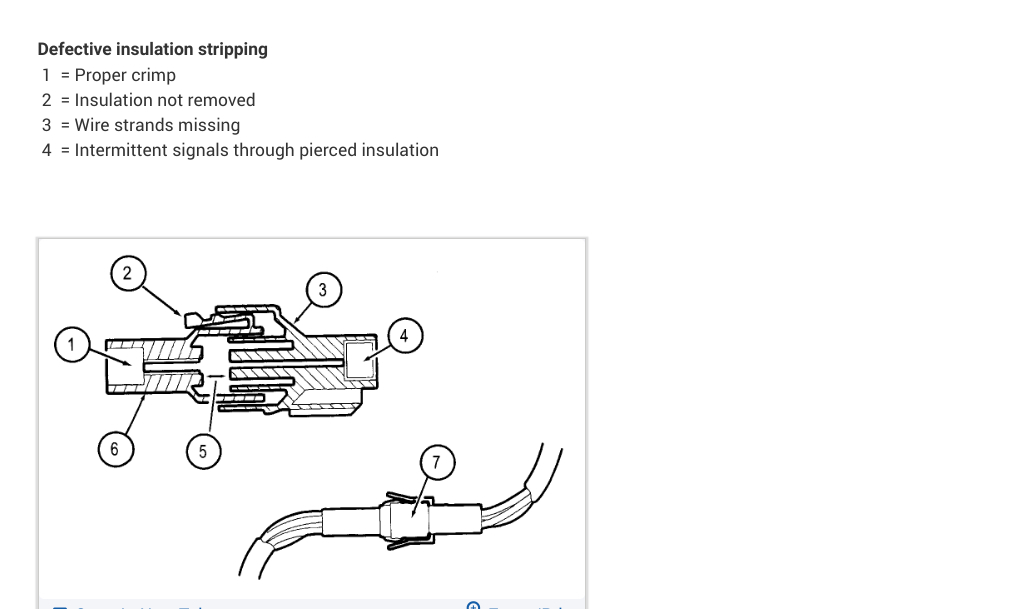

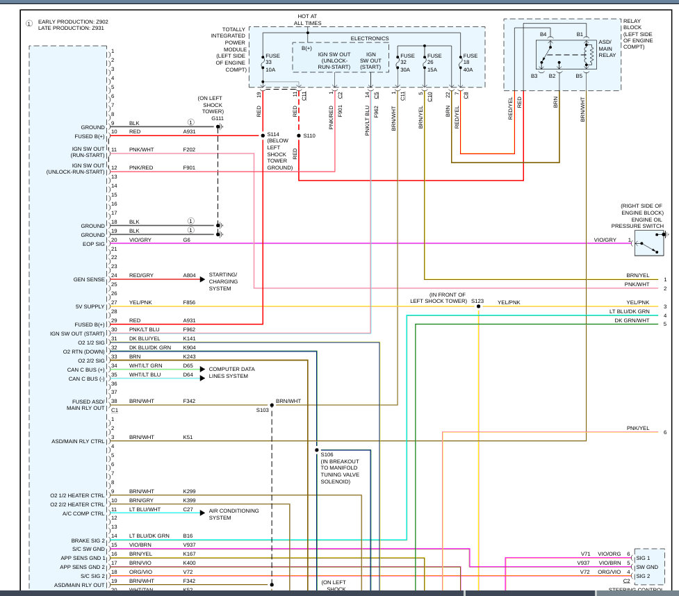

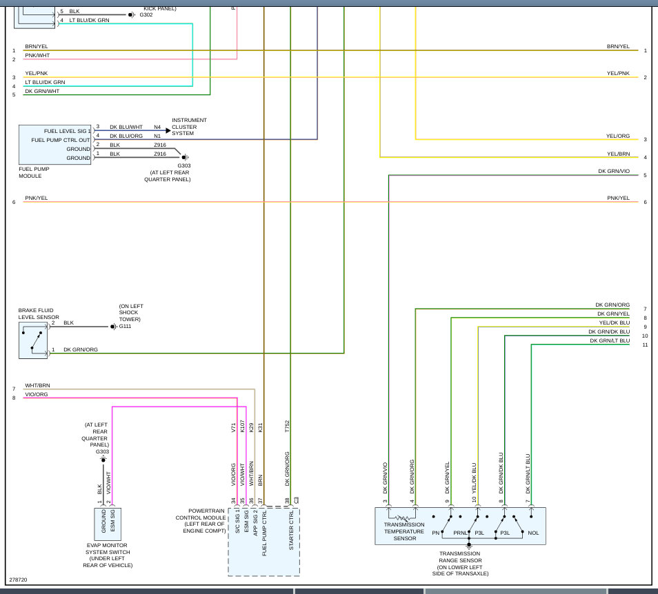

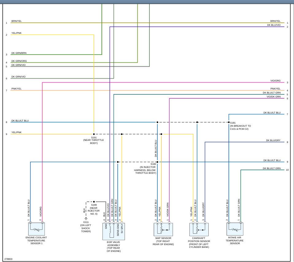

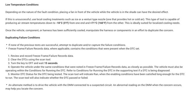

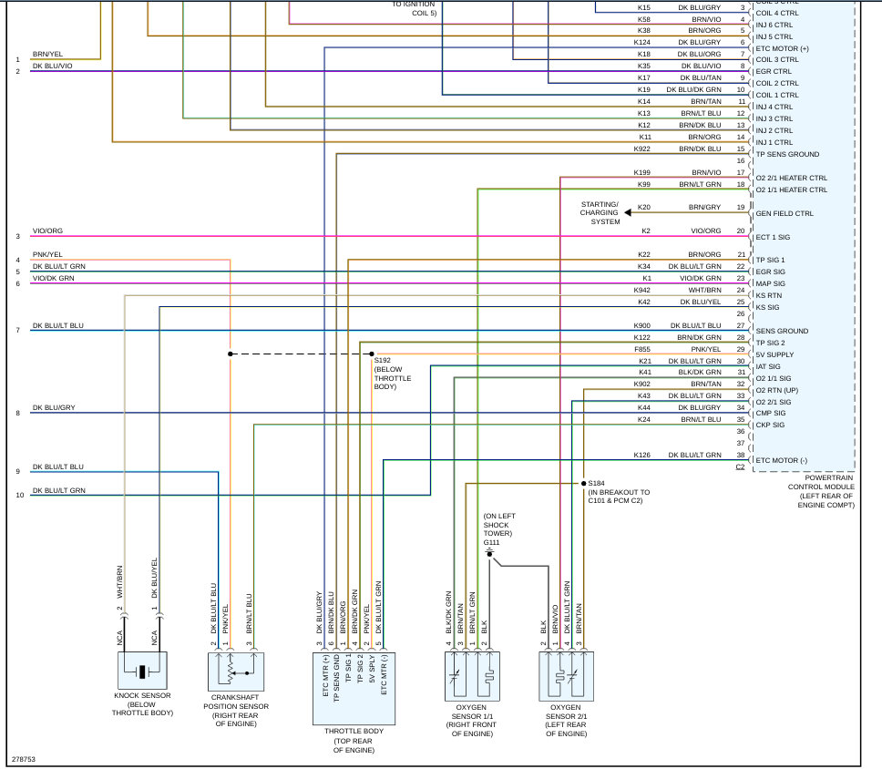

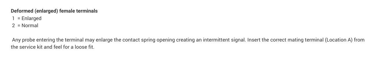

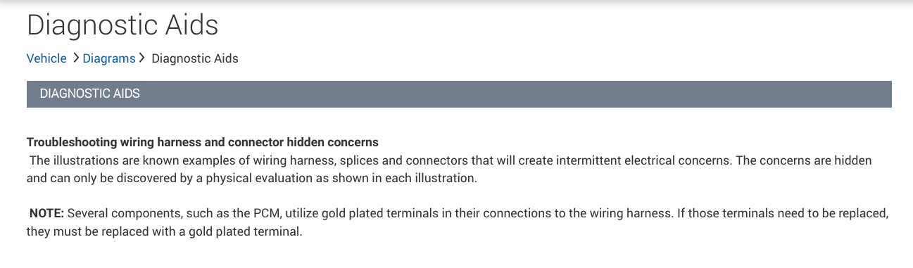

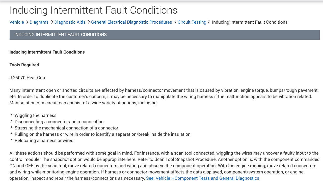

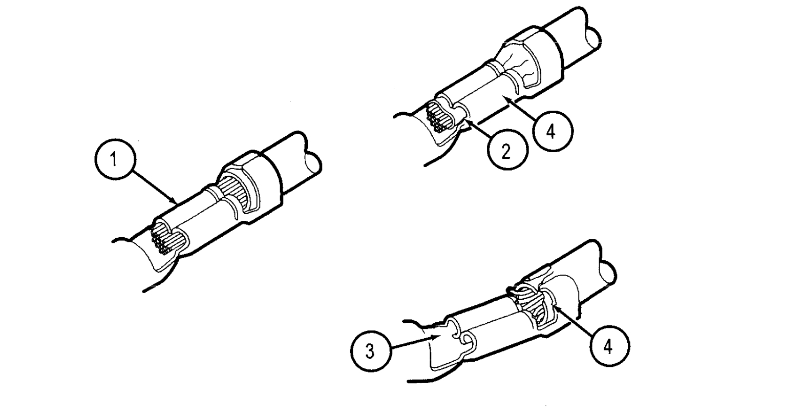

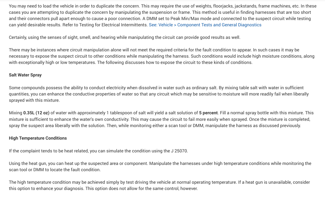

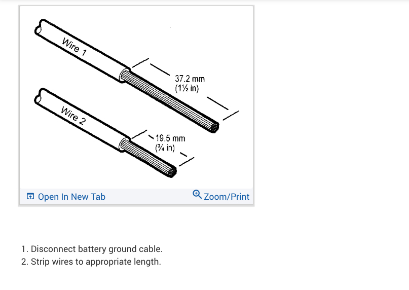

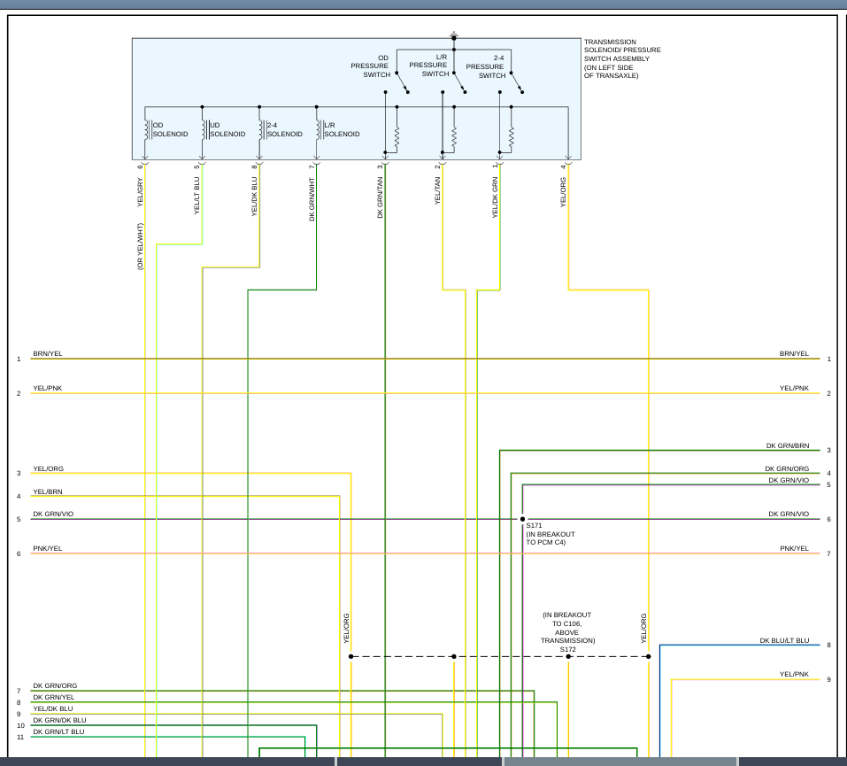

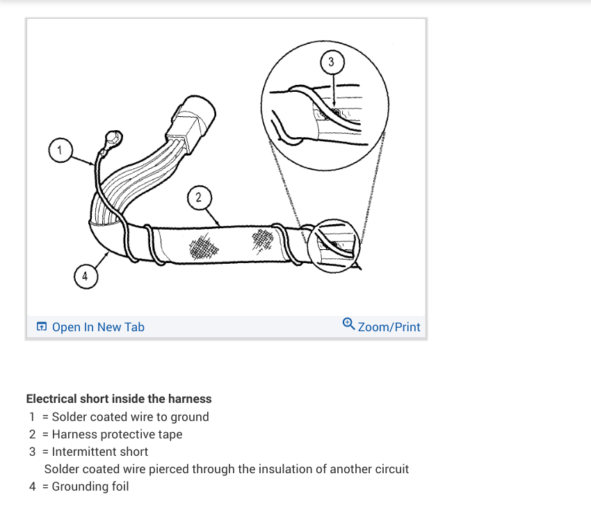

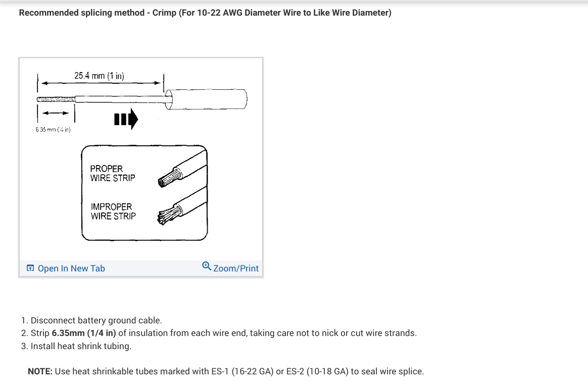

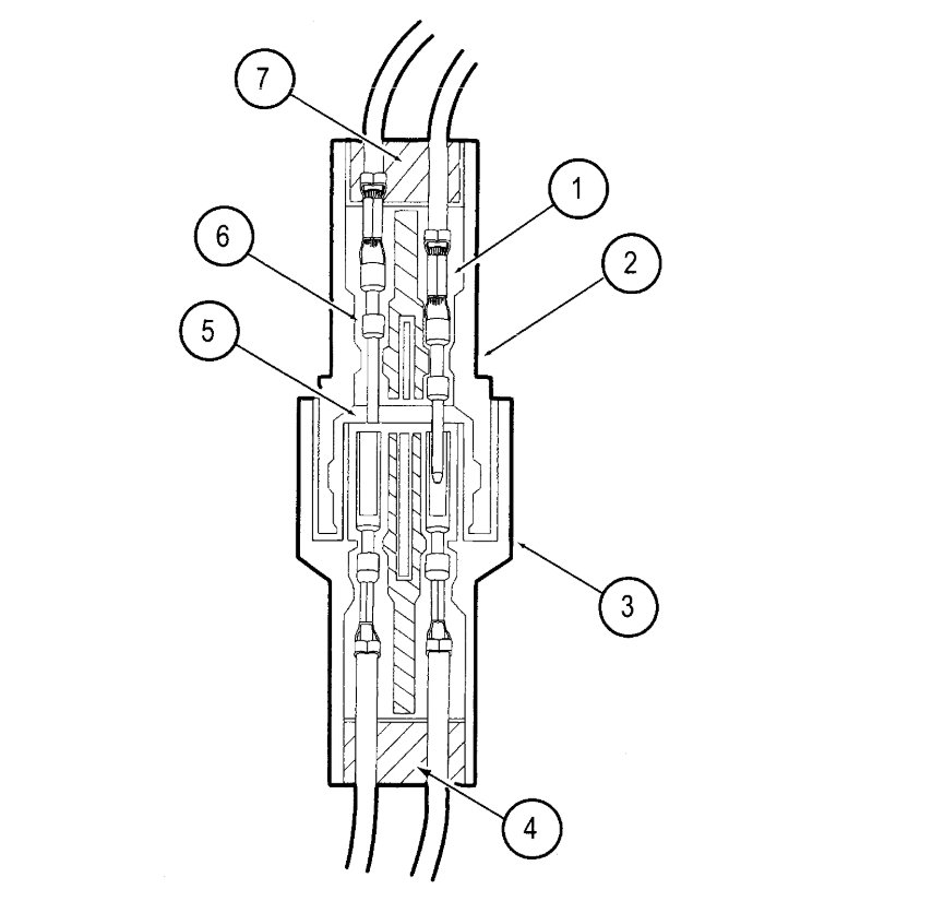

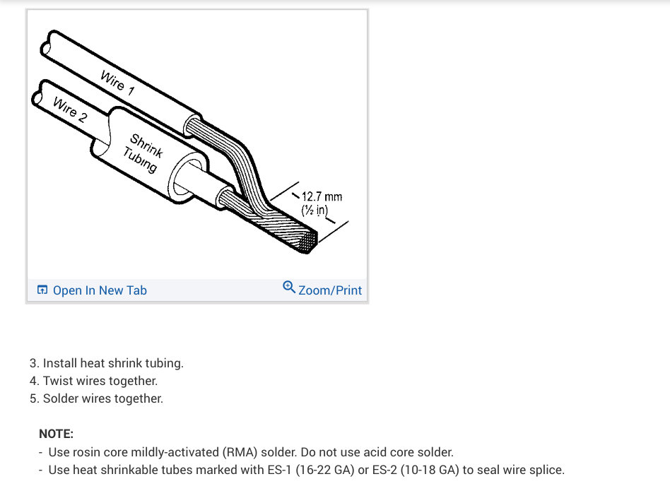

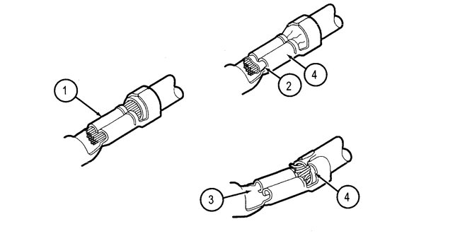

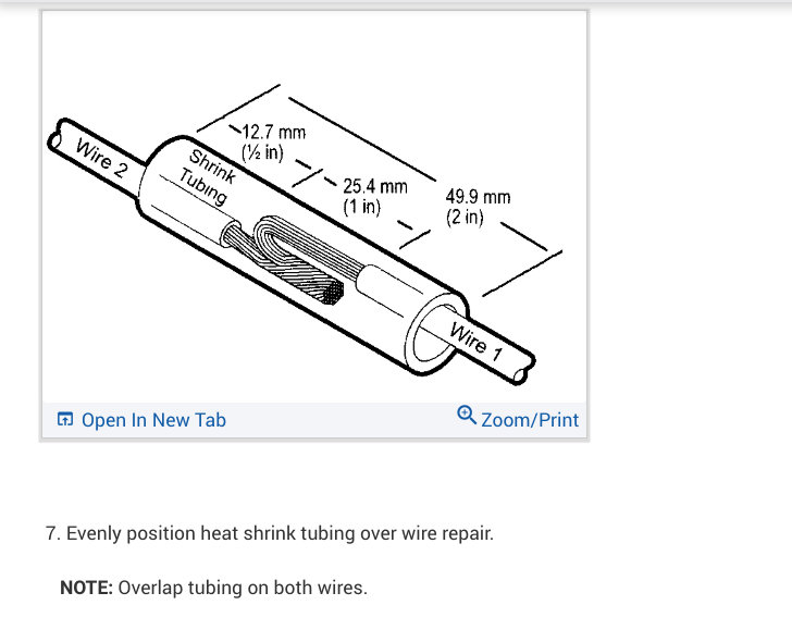

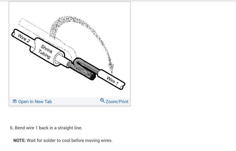

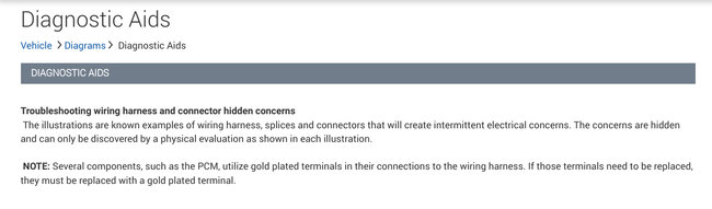

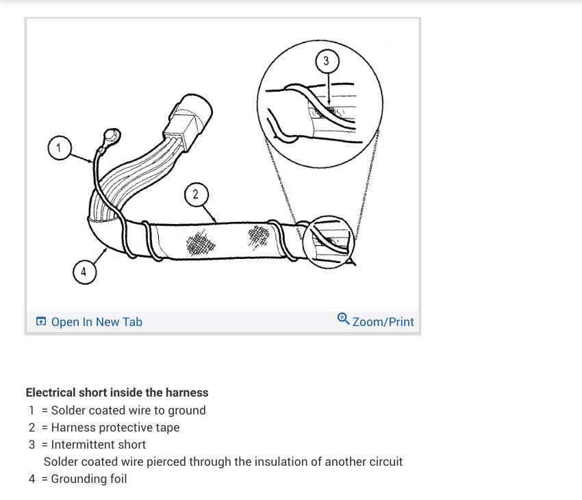

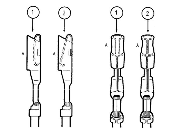

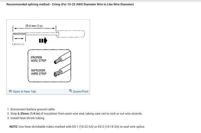

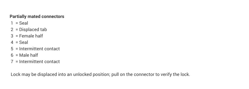

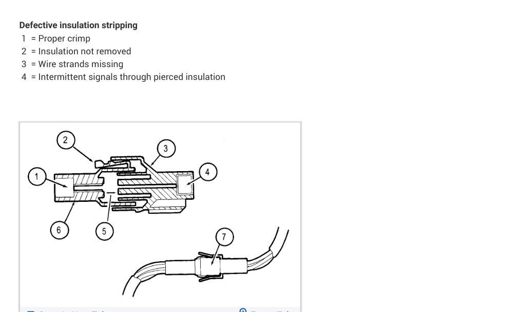

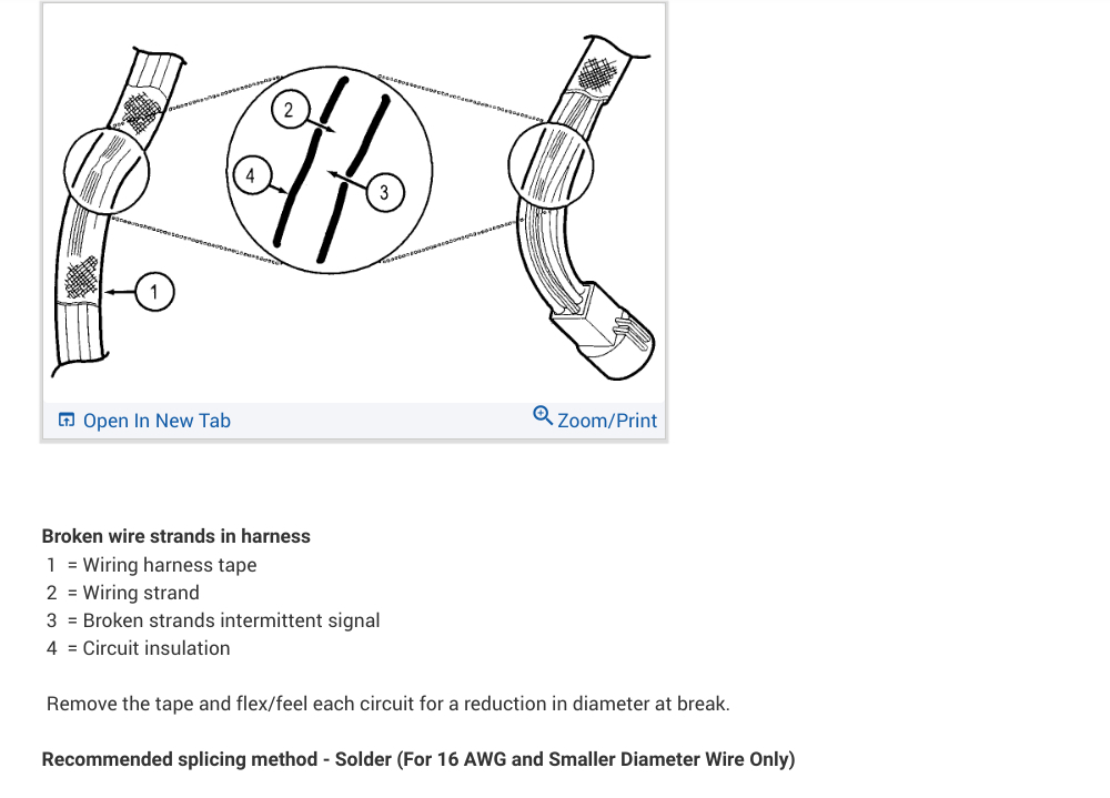

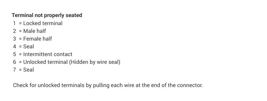

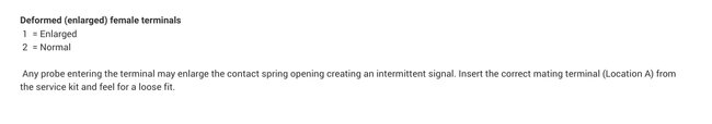

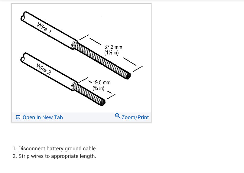

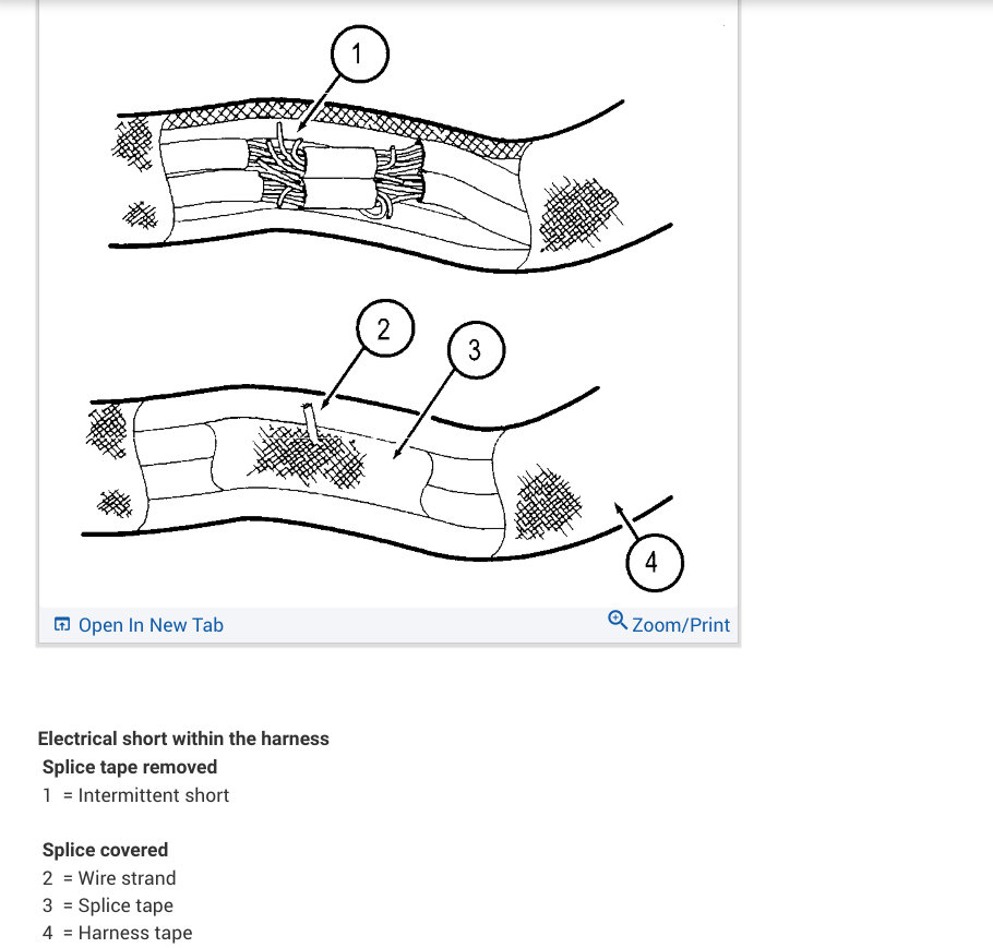

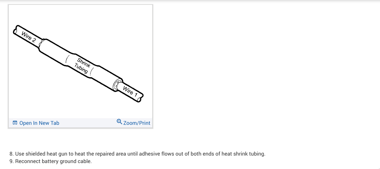

This could be a problem with an intermittent problem in the wiring going to the fuel injectors or the ignition Coil on Plugs[COP][s].. In the diagrams down below I have included the power-train management wiring diagrams with the fuel injector and the COP circuits included in them, and guides for how to find and fix as well as induce intermittent conditions in an automotive electrical circuit for you. You will need to use a Digital Multi-meter [DMM] to go through these guides, so here is a link down below explaining how to use a DMM, if needed:
Please go through these guides and get back to us with what you are able to find out.

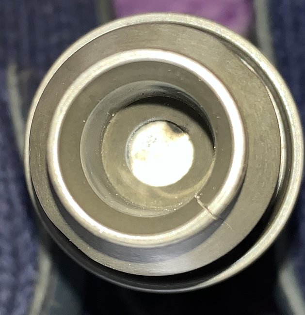

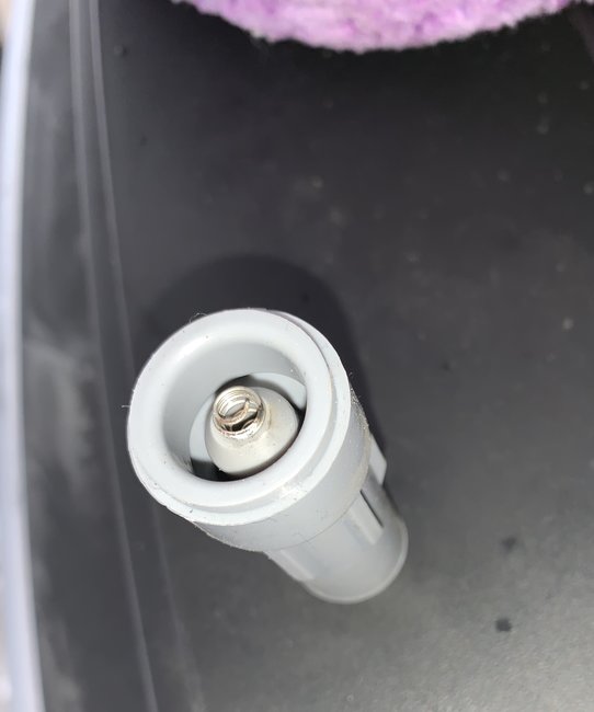

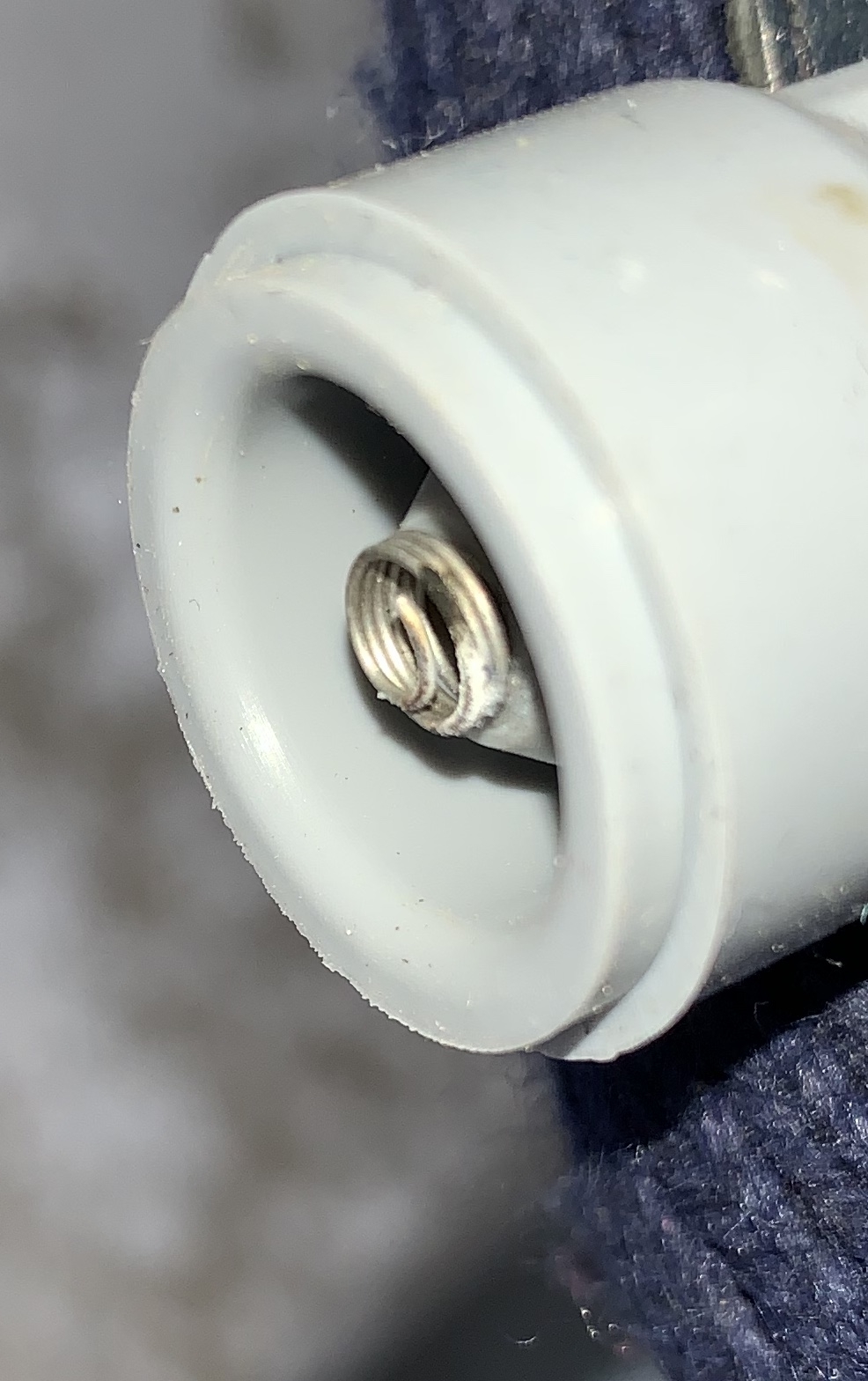

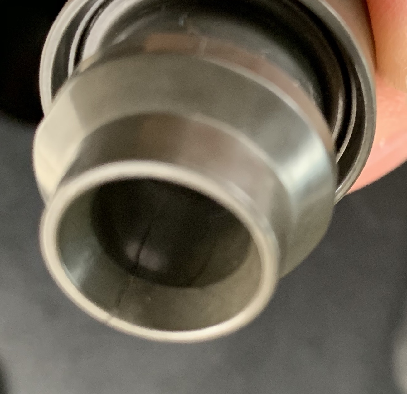

So true! Here’s what I found so far. First pic is bottom of coil, 2nd and 3rd are the brand new boot and spring. They’re burnt a little. What does that mean? Lol! Bad coil? Carbon build up? The spring is a little ashy. This is cylinder 5 which is the code that’s hung in there when I’ve gotten cylinders 2 and 4 misfire to clear a couple times which leads me to think they may be a by-product of cylinder 5 issue. It did look like the top of the boot was bugged in which doesn’t surprise me after finding that other spring bent. Not sure if that itself could cause this. Due to time constraints and not wanting to take the manifold off again I’m wondering what the chances of this being the problem is and maybe I’ll just replace the boot to be thorough the first time. Not sure though, what do you think?

Okay, upon closer inspection I found a crack in the boot. So I definitely need a new boot. You could actually see it in the first picture of the boot. I can’t believe I didn’t notice it lol!
Jan 1, 2020 at 3:33 AM
SCGRANTURISMO
  • 4,897 POSTS
Hello again,
Yep, that will do it every time.
