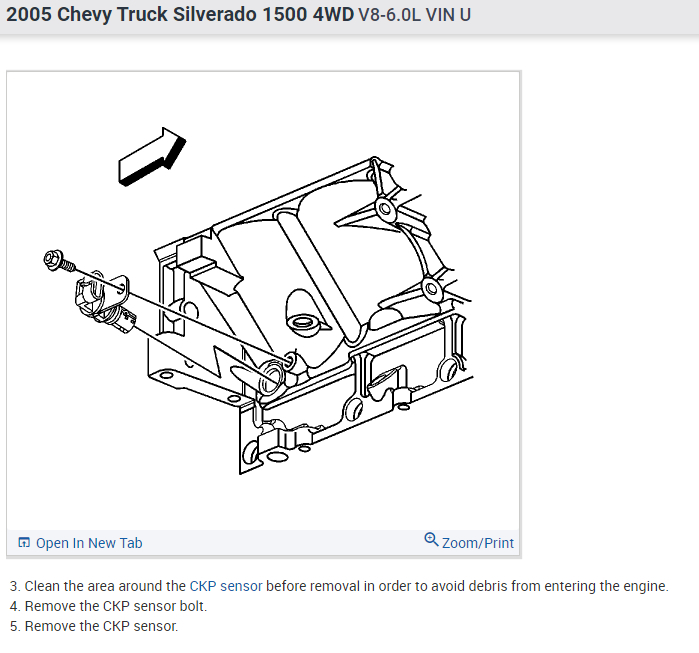

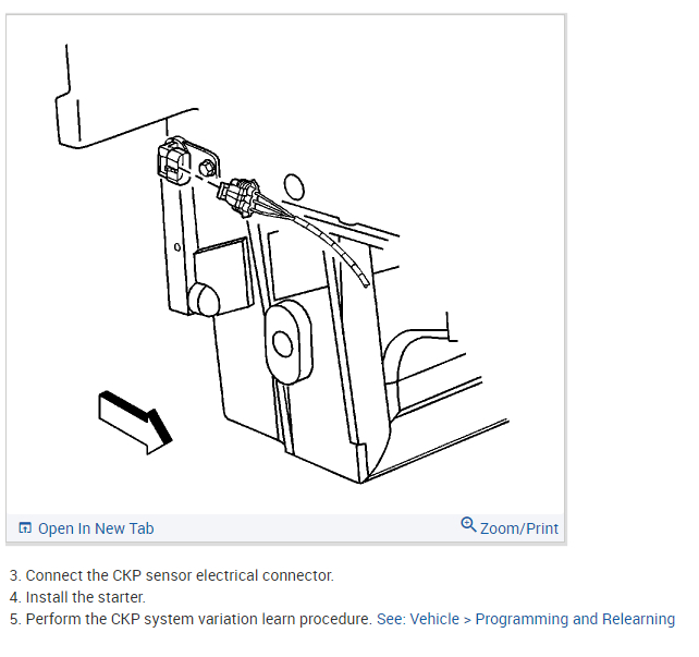

I have the truck listed above (SS). I have been plaque with a random crank but no start. If the problem happens, it always starts on the second try. I have replaced the fuel pump, ignition switch (in the column), and key switch. any ideas?
Aug 10, 2021 at 2:52 AM
SQM
  • 6,383 POSTS

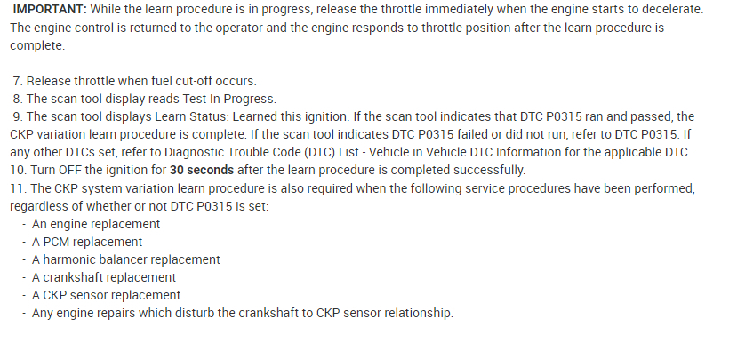

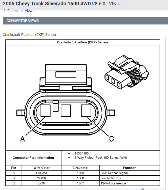

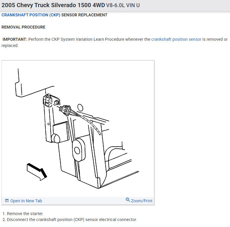

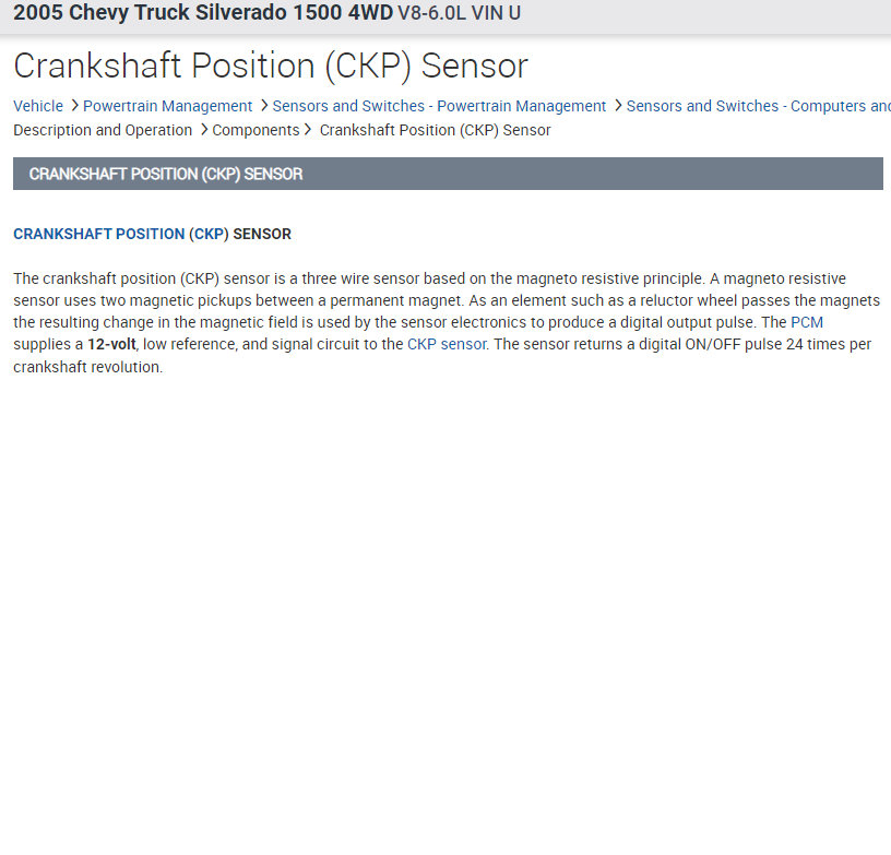

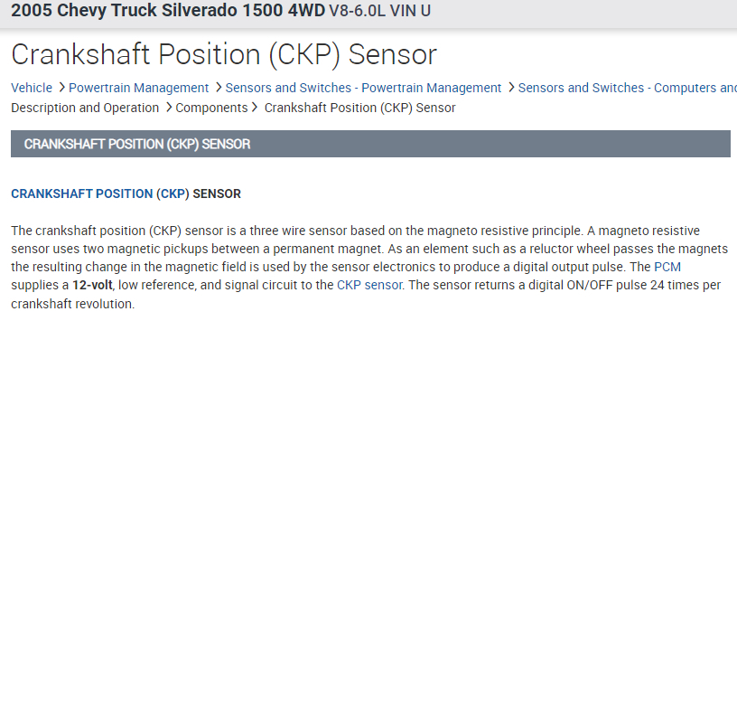

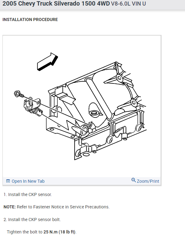

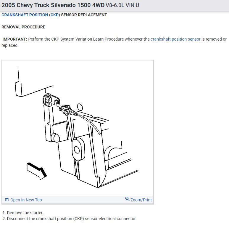

Have you checked the crank position sensor?
It almost sounds like an issue with the crank sensor.
Many times a faulty crank sensor will make it difficult to start the engine.

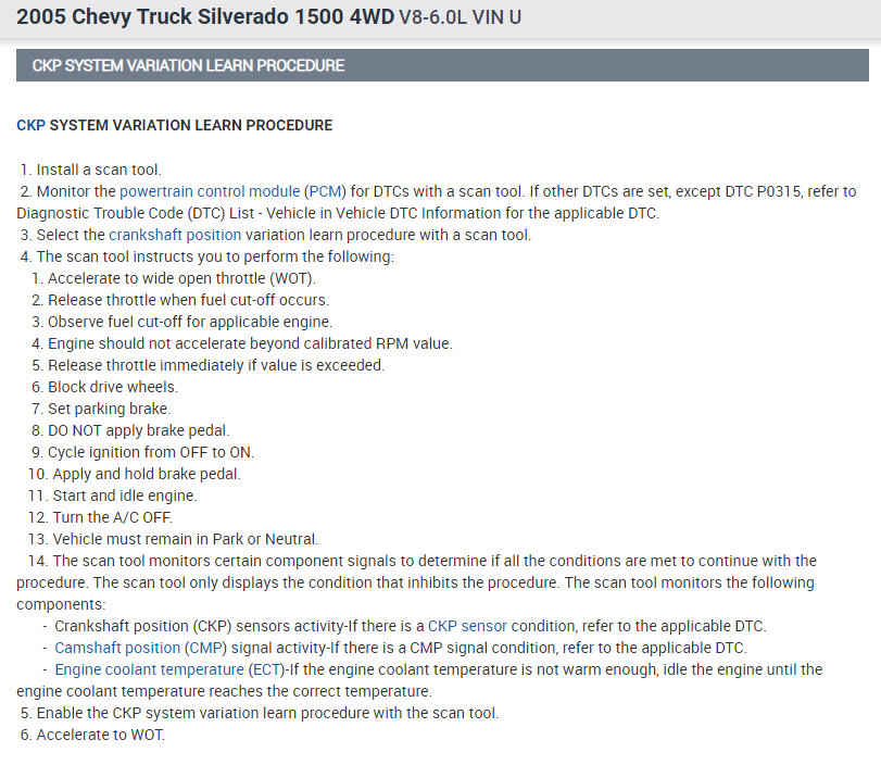

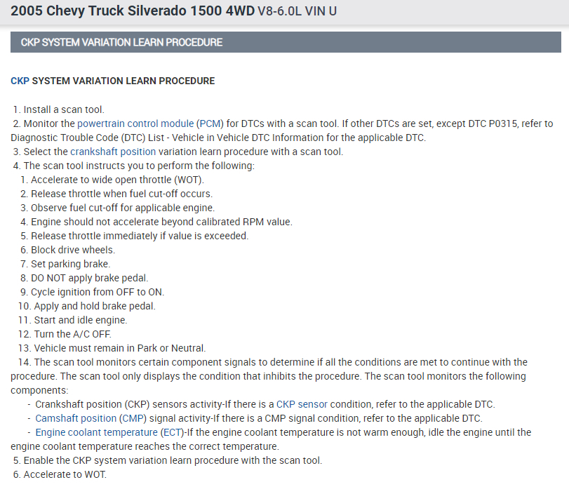

It can also create intermittent starting issue. The crank sensor does require programing for these trucks.

I have no codes except for Airbag. Excellent suggestion, I have seen them became faulty on other GM vehicles but didn't consider on my Silverado. I will look into the crank sensor. I appreciate the speedy response.

Found out the crank sensor has recently been changed recently. Will check the fuse box. feels like a sticky fuse. Spit balling now.
