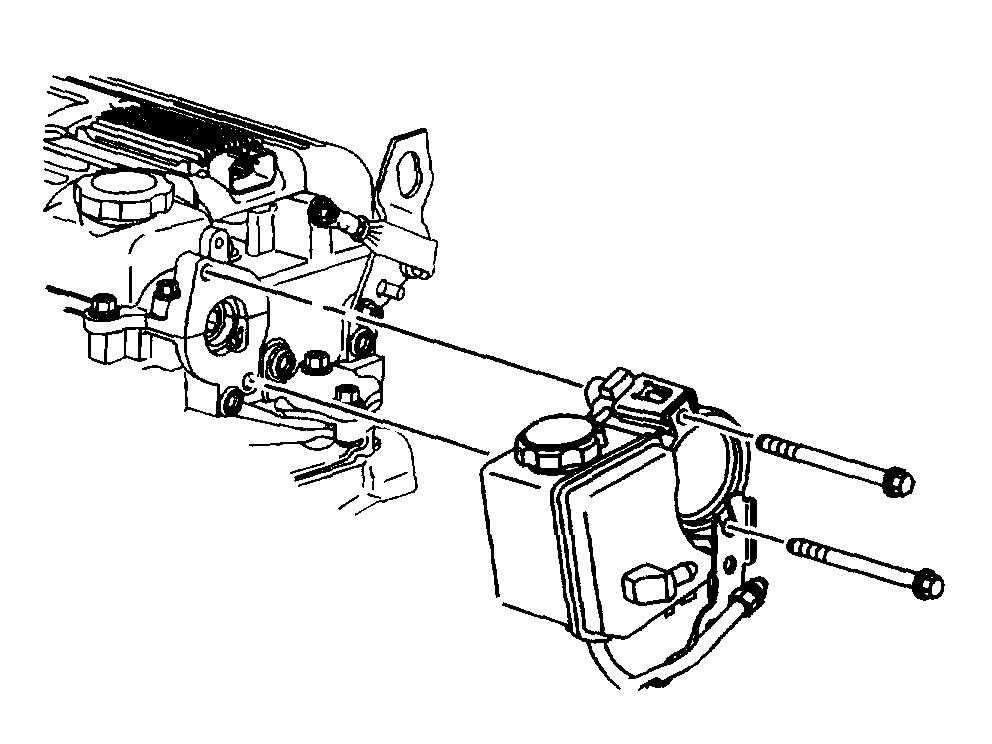

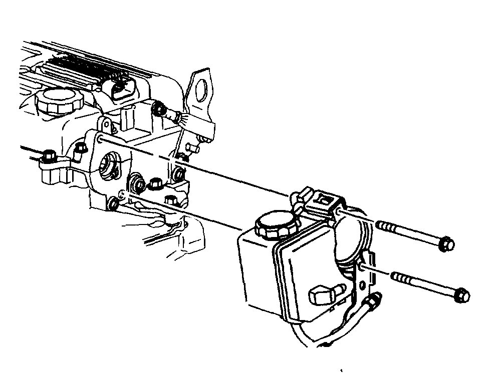

3. Remove the power steering pump bolts and set pump aside.

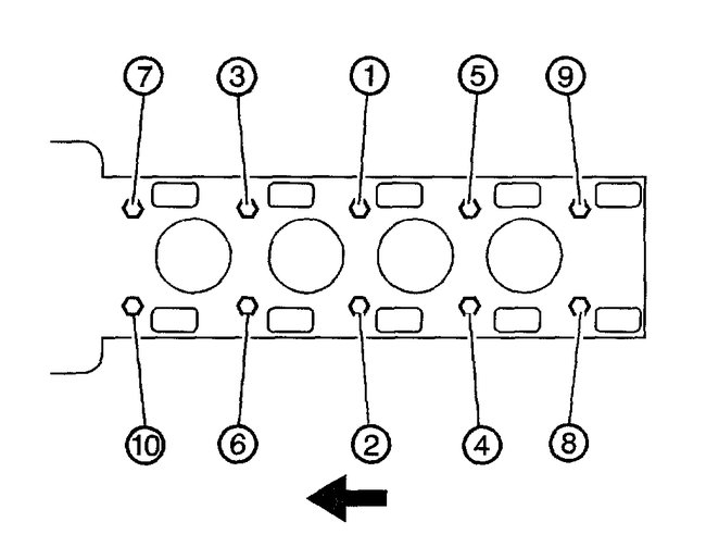

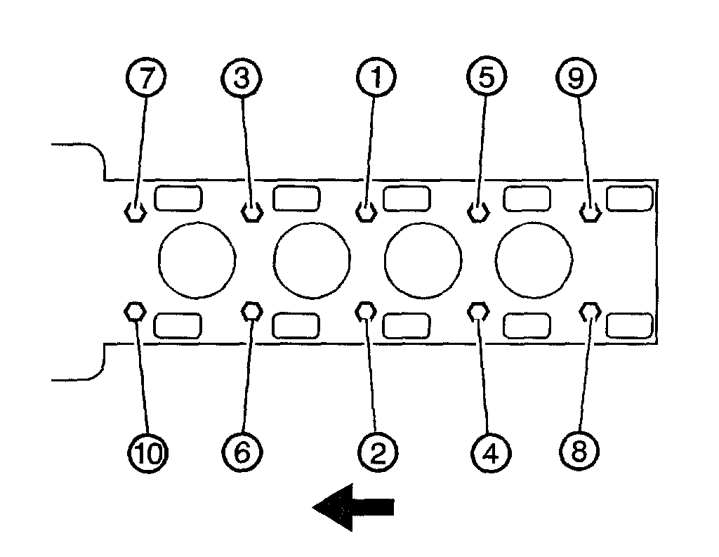

7. Remove the cylinder head bolts in sequence and discard.

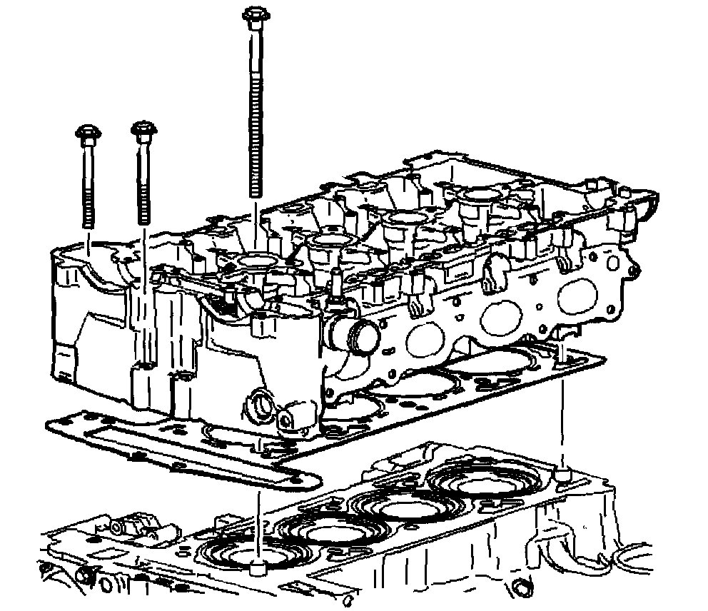

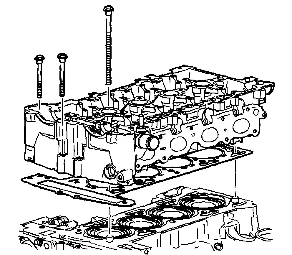

8. Remove the cylinder head and gasket.

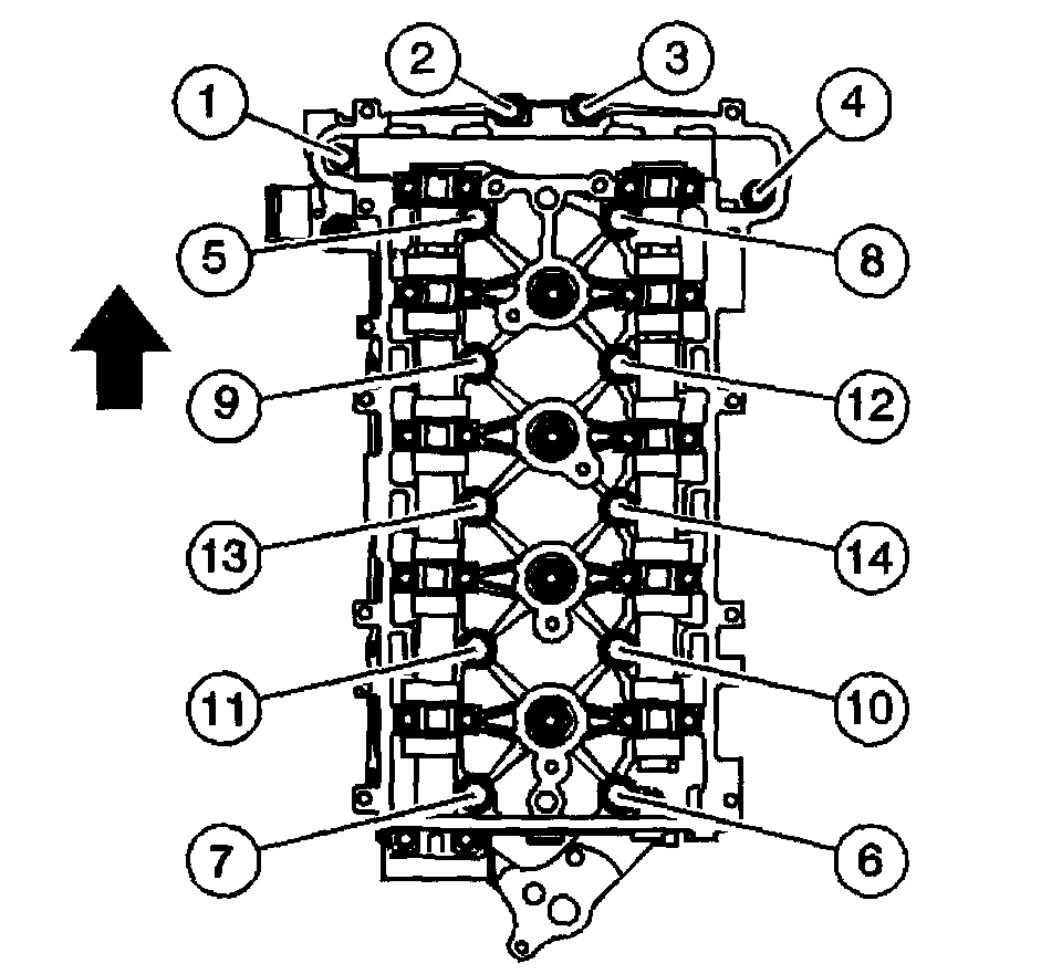

3. Tighten the cylinder head bolts in sequence.
^ Tighten the cylinder head bolts to 30 Nm (22 ft. lbs.) plus 155 degrees.

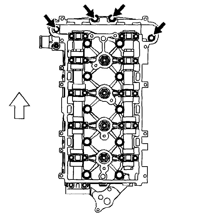

4. Install the NEW front cylinder head bolts.
^ Tighten the front cylinder head bolts to 35 Nm (26 ft. lbs.).

picture 7
9. Install the power steering pump.
^ Tighten the power steering pump bolts to 25 Nm (19 ft. lbs.).
