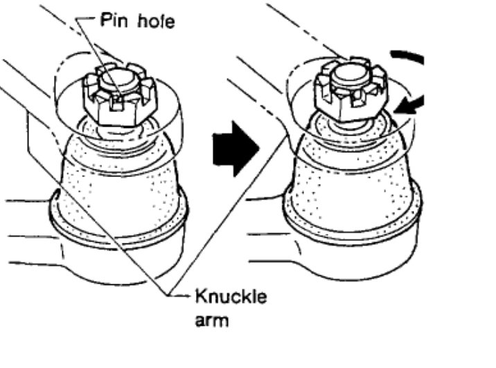

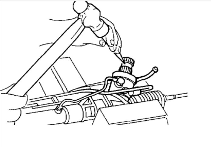

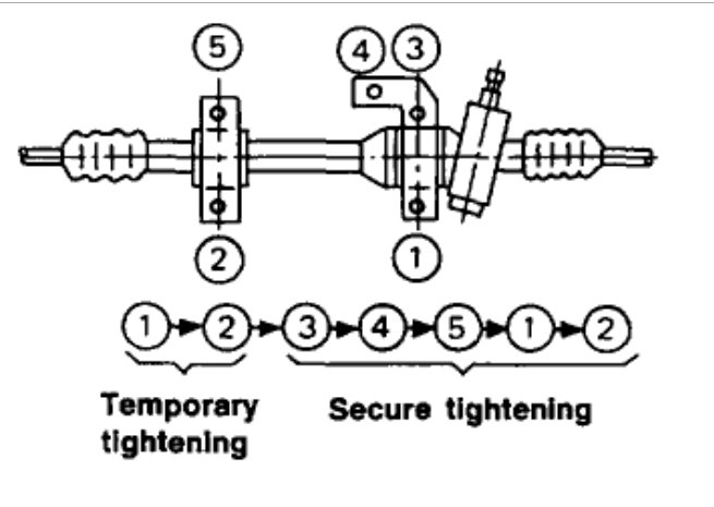

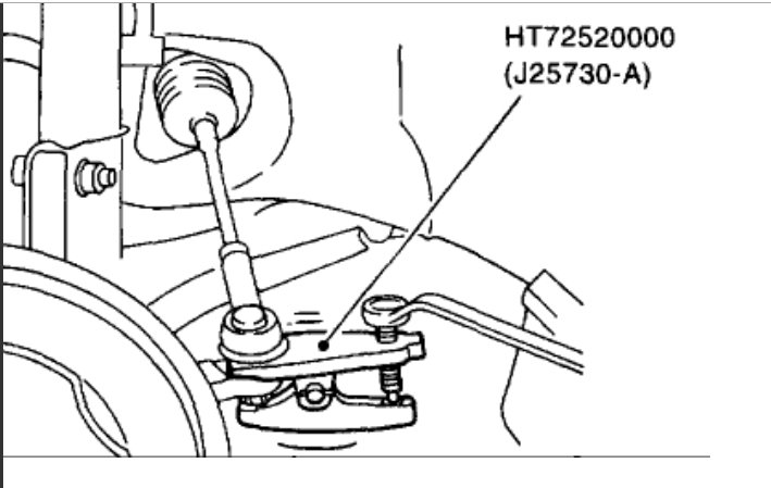

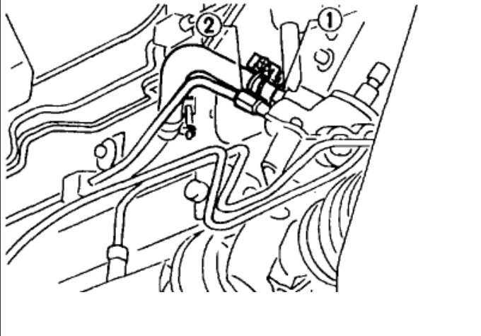

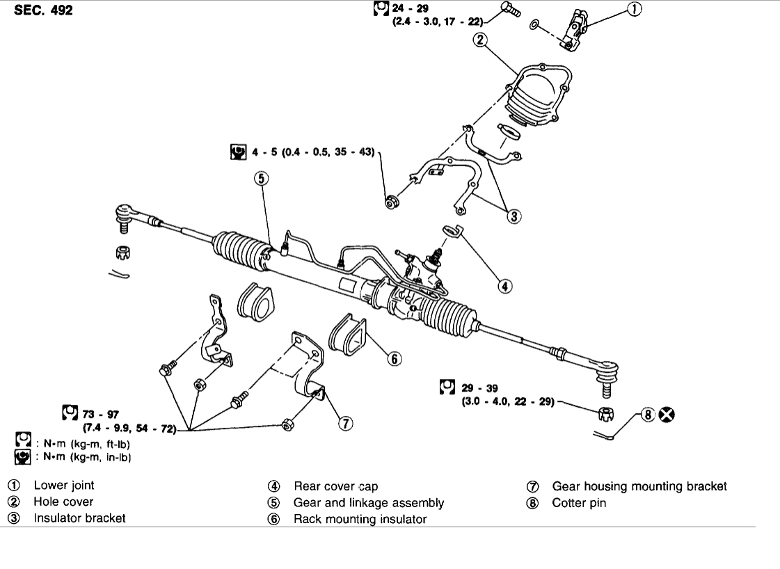

The only seal you can replace without rebuilding the rack is the pinion seal. Here is instructions on how to get the rack out.
Here is a guide to get the tie rod end off:
https://www.2carpros.com/articles/tie-rod-end-replacement
Diagrams (Below).
