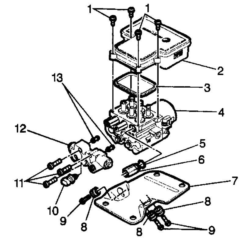

There's a module attached to the pump that controls the solenoids. It is very common for the solder joints in it to fail. It'll cause the light to come on and show no codes and intermittent abs operation when it's not called for. IF you look on eBay some companies offer a rebuild service where they replace the relays and reflow the solder joints. This usually resolves these issues. I'll post how to remove it below.
REMOVAL PROCEDURE
IMPORTANT: After installation, calibrate the new Electronic Brake Control Module (EBCM) to the tire size that is appropriate to the vehicle. Refer to Tire Size Calibration and to Trim Level Calibration portions of ABS System Operation.
1. CAUTION: Before removing or installing any electrical unit or when a tool or equipment could easily come in contact with "live" exposed electrical terminals, disconnect the negative battery cable to help prevent personal injury and/or damage to the vehicle or components. Unless instructed otherwise, the ignition switch must be in the "OFF" or "LOCK" position.
2. Remove the four T-25 Torx screws (1) that fasten the EBCM to the Brake Pressure Modulator Valve (BPMV).
3. Partially remove the EBCM (2) from the BPMV (4) enough to access the electrical connectors. Removal may require a light amount of force.
IMPORTANT: Do not use a tool to pry the EBCM or the BPMV. Excessive force will damage the EBCM.
4. Disconnect the four electrical connectors from EBCM.
5. Fully remove the EBCM (2) from the BPMV (4).
INSTALLATION PROCEDURE
IMPORTANT:
^ Do not reuse the old mounting screws. Always install new mounting screws with the new EBCM.
^ Do not use RTV or any other type of sealant on the EBCM gasket or mating surfaces.
1. Install the EBCM gasket (3) onto the BPMV (4).
2. Install EBCM (2) on to the BPMV (4).
3. Connect the four electrical connectors to the EBCM.
4. Ensure that the new EBCM gasket (3) is aligned correctly.
5. Install the four new T-25 Torx screws (1) in the EBCM (2).
^ Tighten the four T-25 Torx screws to 5 Nm (39 inch lbs.) in an X-pattern.
6. Connect the negative battery cable.
7. Revise the tire calibration using the Scan Tool
8. Return to Diagnostic System Check.

Sorry, but i was just re-reviewing your message. I'm not so good under the hood, but what your basically saying is that this electric issue is periodically sending mixed/delayed messages to the ABS and it is reacting to it, thus giving my car that once in a while push back from my brakes, like an ABS going out and that once in a while ABS light coming on after.
Mar 14, 2019 at 5:36 AM
KENW1
  • 213 POSTS
Correct, the connections inside the module are making/loosing contact on the printed circuit board.
