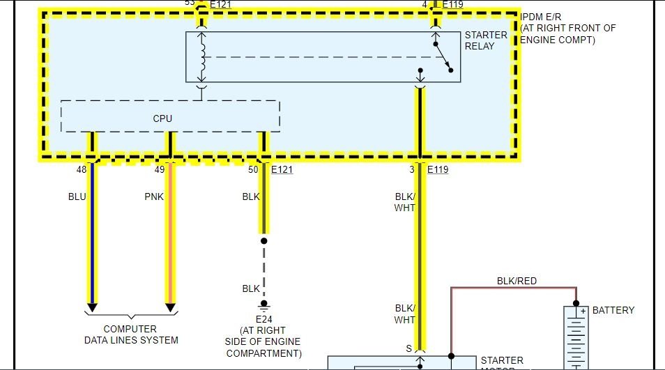

Car was working perfectly the day before, next day it will not crank. Starter sounds like it's working, no prior alternator problems. checked all the appropriate fuses that can be checked. The one thing that was told was to replace the brake switch, which I haven't done yet, but at the same time, I was shown if you remove it from where it was, the engine should start. Unfortunately that's not the case. Do not have a computer to hook it up to, can't get it to a shop to get checked, nor have the resources to actually get it to there during these times.
May 31, 2020 at 3:35 AM
Good afternoon,
I attached a wiring diagram for you to view.

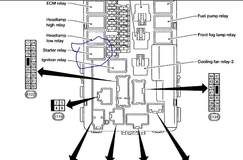

There is a starter relay we need to do some testing at.
You will need a volt meter or test light for the testing.
Forget about the brake light switch. that has nothing to do with the circuit.
