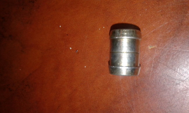

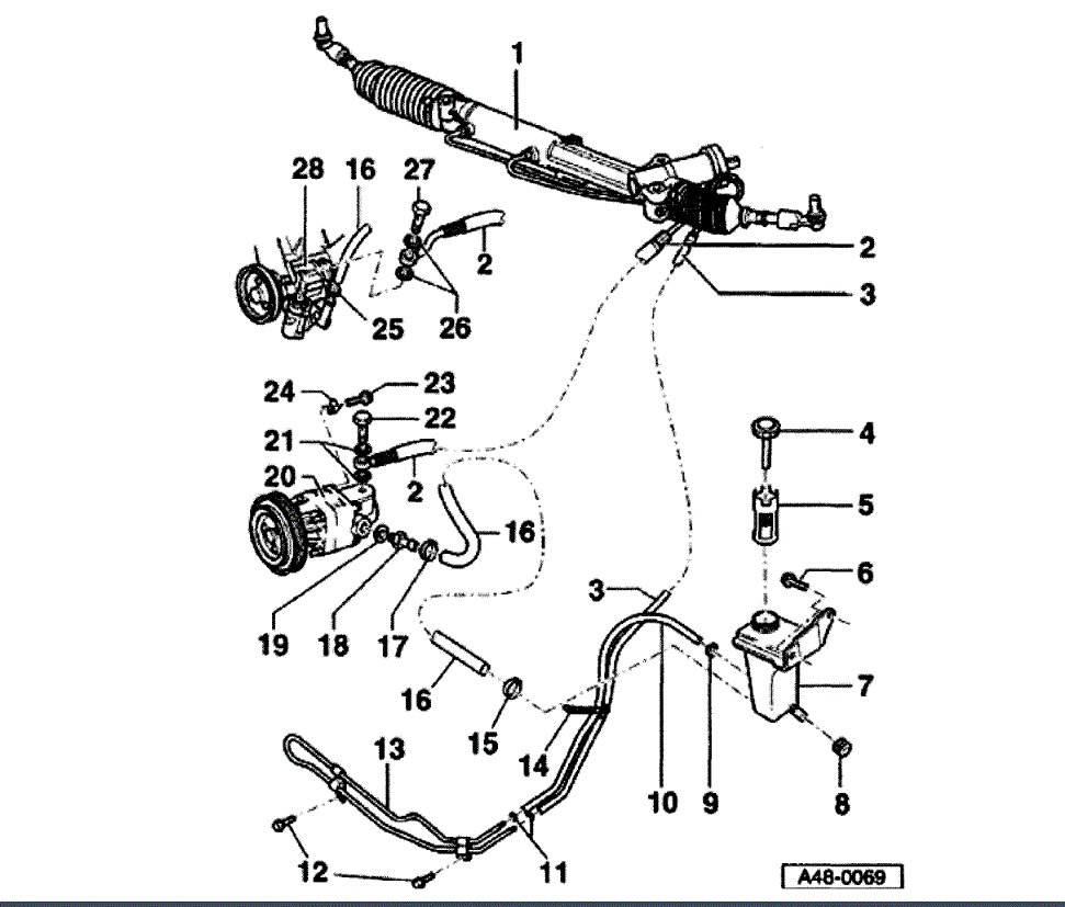

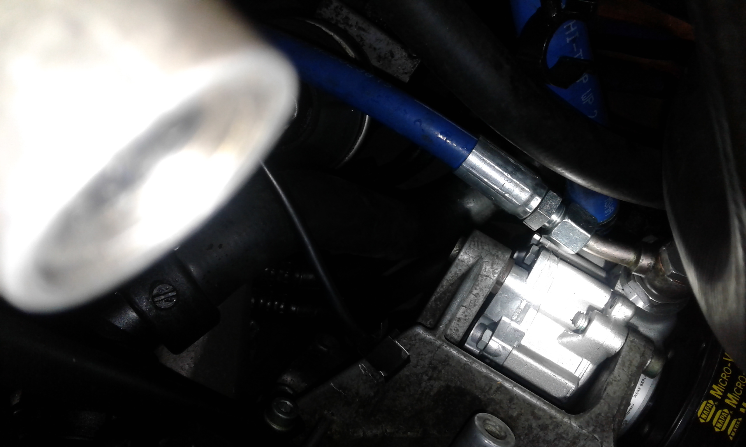

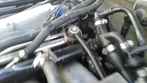

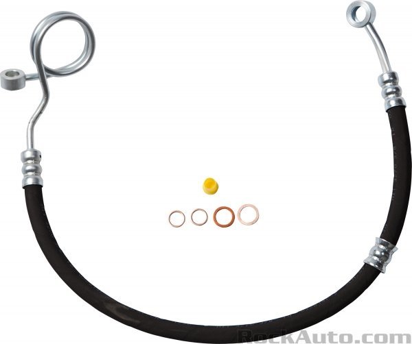

I was wondering if anybody knew what this valve was in my old power steering
return line hose for my car listed above A4 1,8 quattro? Seems like the rack hums without them and I don't remember it doing it before. I replaced all the hoses to my rack, and to the reservoir. Put in a new re-manufactured power steering pump as well as I thought after 19 years and 181,000 miles it was time. I had a local hydraulic shop replace the lines but they did not move the valves over.
Any ideas? Could this be causing a ripple in the fluid, hence hemming and
too much pressure in the unit?

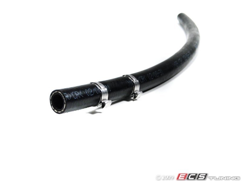

It's on the return line to the pump from the reservoir.
Mar 29, 2020 at 10:18 PM
I suspect that is hallow. Is that correct? If it is, it would be interesting to see if putting that in the line stops the noise. I think the noise is just an unfortunate byproduct because that insert is there just to keep the line from collapsing. However, if it is not hallow then calling it a valve is very accurate.
Where did you get the lines that were replaced? Where they made or did they buy them? That is not a piece that would need to be transferred over as it should come in the new line.
Mar 30, 2020 at 8:32 AM
PETER ANDRULIS
  • 25 POSTS

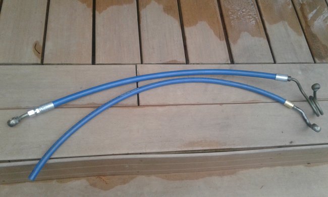

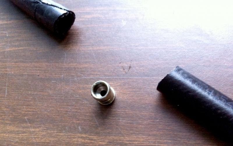

I had the metal ends installed by a hydraulic customizer. I talked to him about the baffle valves, its obvious to slow down flow, which was confirmed by my Audi parts person. He thinks that's where the noise is coming from . I'm not so sure. I think my re-manufactured Bosch pump is still not working correctly and making the whine which is real bad when it's turned to lock. I replaced the serpentine belt today as I read in one mechanics view it could be a slipping belt. No real change still.
Mar 30, 2020 at 10:10 AM

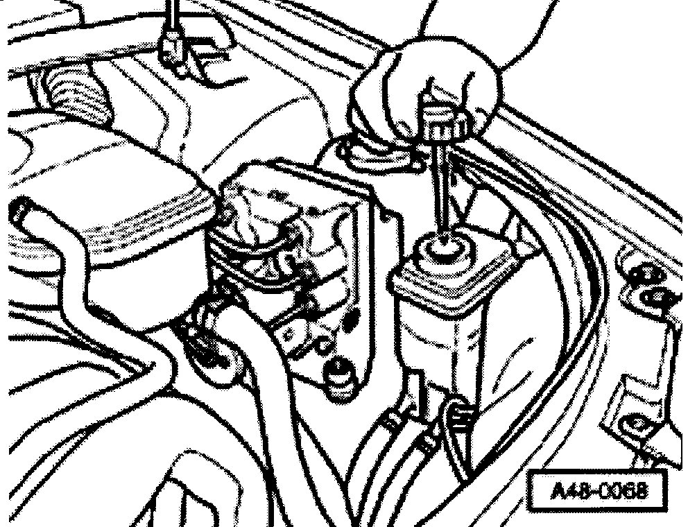

Hydraulic fluid level, checking
- With engine switched off, bring front wheels to straight-ahead position.
pic 1
- Remove cap.
- Wipe dipstick using clean cloth.
- Re-install cap hand tight and remove again.
Note: The cap must be screwed on fully to obtain an accurate fluid level reading.

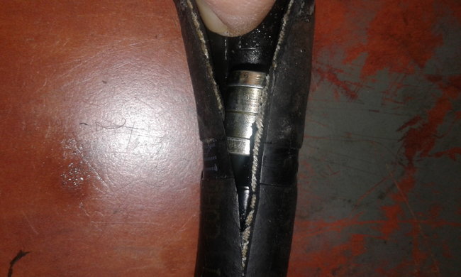

For what it is worth, I had a Chrysler 300 years ago that was making that exact sound. We pinpointed it to a power steering line by using a Stethoscope (picture attached) designed for this type of thing. Basically you use this to find where the noise is the loudest.
If we can do that and confirm this is coming from this line that had this "baffle" then that is more proof that this is where the issue is coming from.
We fixed that 300 by replacing that line when we found it was an aftermarket line that they had replaced. We didn't dig into the difference so I don't know what the OEM line had different then the aftermarket.
Mar 31, 2020 at 2:56 AM
PETER ANDRULIS
  • 25 POSTS
I bought one already last week so will inspect it as you stated ! Will let you know !

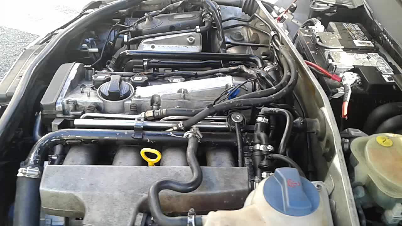

It's loudest on the high pressure hose closest to the new Bosch re-manufactured pump, where it comes out of the pump just after the clamped fitting. On the hose with a strange fitting the customizer installed. Is it the pump or the fitting?
Mar 31, 2020 at 3:24 AM
  • 110,244 POSTS
If you replaced it with an OEM part and the sound is closest to the pump, I suspect the pump is the issue. Did you try bleeding it just in the event there is still air somehow in the system?

Yes. The sound is closest to the pump as I moved the Stethoscope further away the sound lessened. I am in the process of trying to find an appropriate replacement. I appreciate all your thoughts and advice! Thank you ! Will let you know what I obtain as a replacement, and how it works.

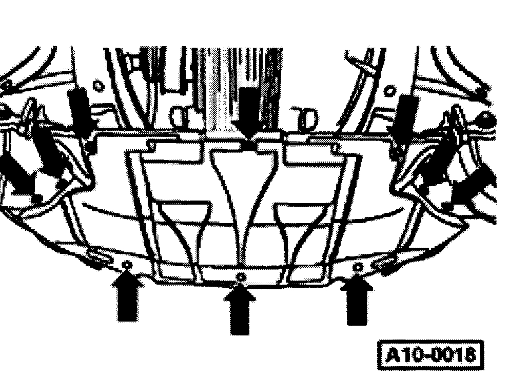

- Remove noise insulation panel.
- Remove front bumper, refer to Body and Frame - Bumper - Service and Repair - Procedures See: Front Bumper > Removal and Replacement
- Move lock carrier to service position.

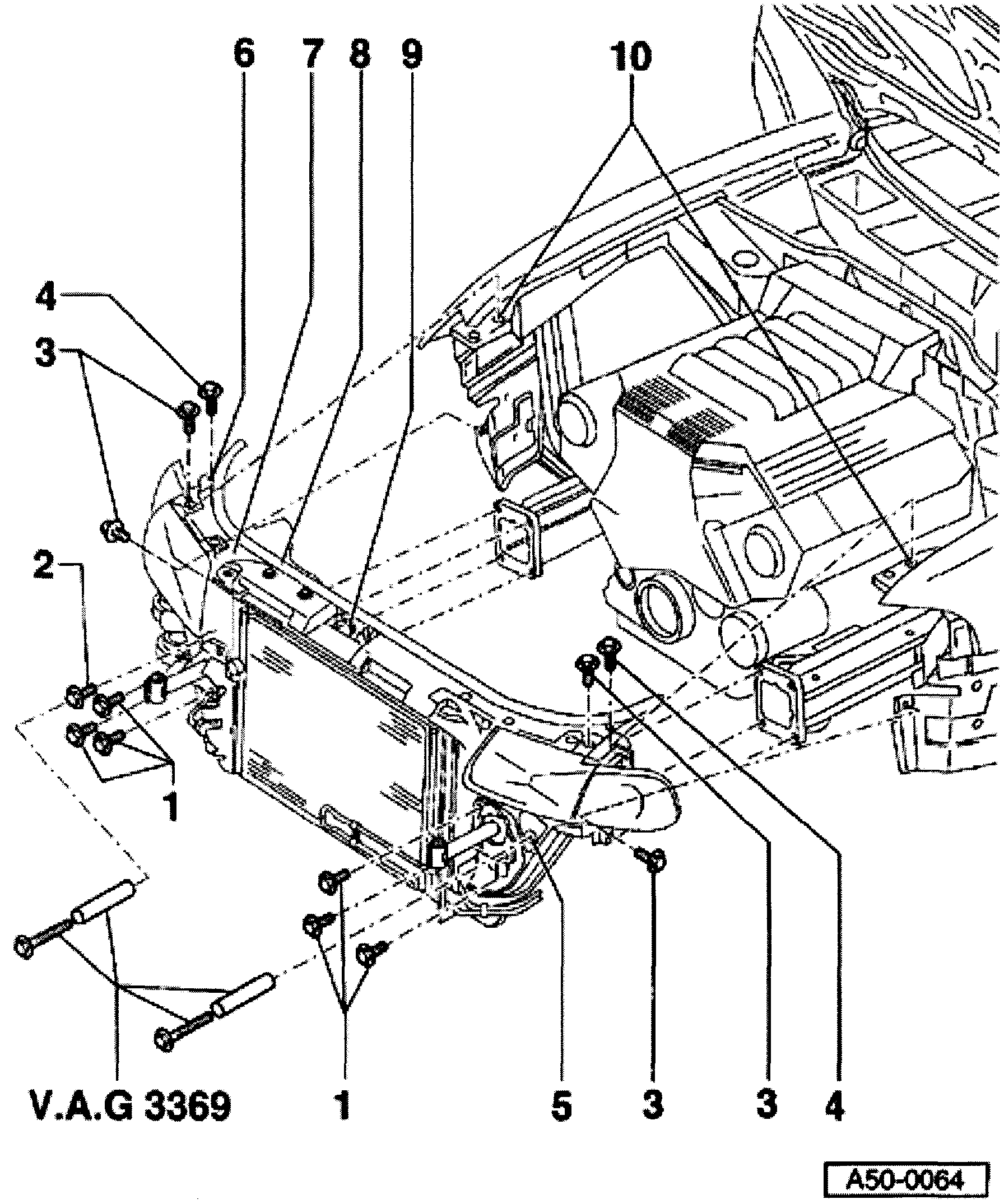

Lock carrier, moving to service position
pic 3
1. Bolt (6x) 50 Nm (37 ft lbs)
2. Bolt 50 Nm (37 ft lbs)
3. Bolts (4x) 8 Nm (71 in lbs)
4. Bolts (2x) 8 Nm (71 in lbs)
5. Access hole for 3369 support tool
6. Hole in front end
For securing lock carrier in service position
7. Lock carrier
8. Weather stripping for hood
9. Bowden cable for hood
10.Holes in side panel
Moving to service position
- Remove intake air duct located between lock carrier and air cleaner.
- Remove bolt -2- and install 3369 support tool on left and right hand sides.
- Remove bolts -1-, -3- and -4- then pull lock carrier forward on 3369 support tool.

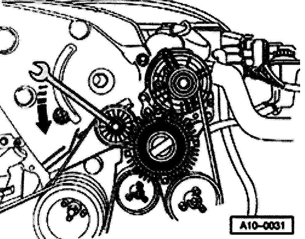

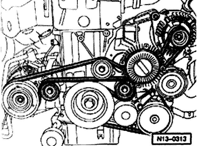

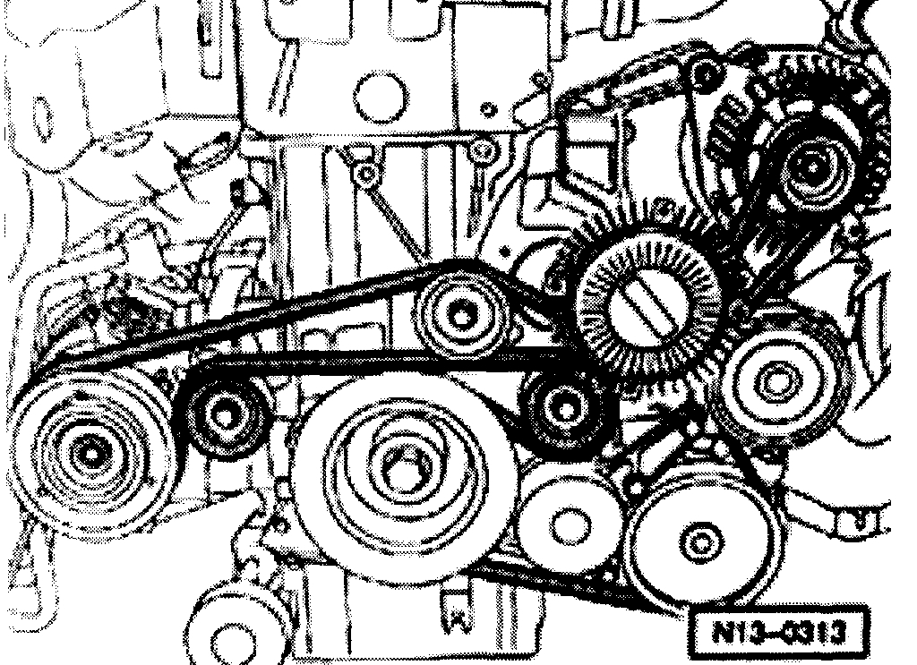

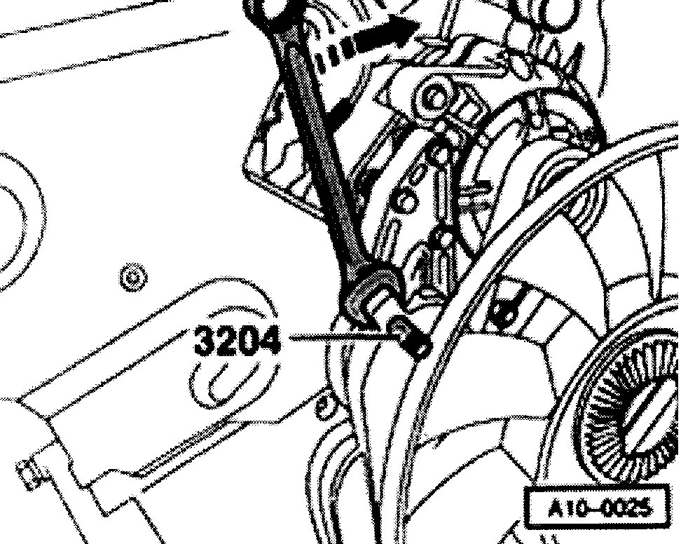

Removing ribbed belt on vehicles with 4-cyl. gasoline engine
pic 4
- Move tensioner in direction of arrow to loosen ribbed belt.
- Secure using 3204 drift.
CAUTION: Mark the running direction before removing. Reinstalling a used belt in reversed running direction could damage the belt.

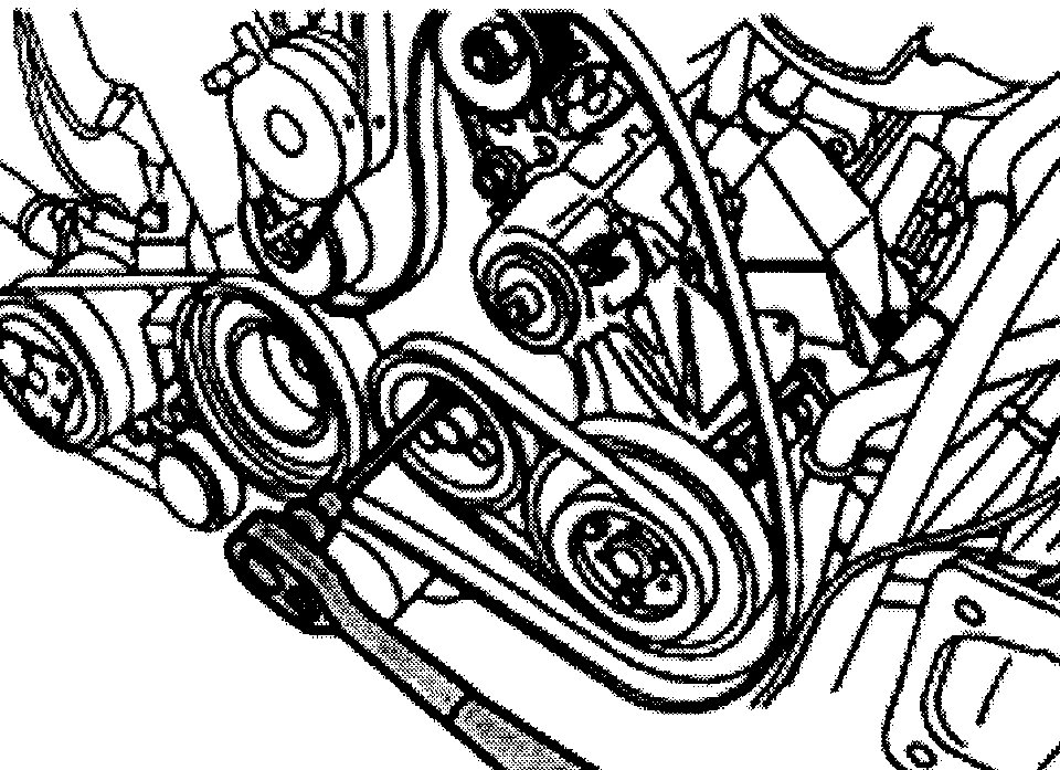

Removing ribbed belt on vehicles with 4cyl. Diesel engine
pic 5

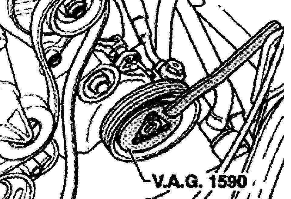

- Remove power steering pump pulley.
- If necessary, file down corners of VAG1590 water pump wrench.

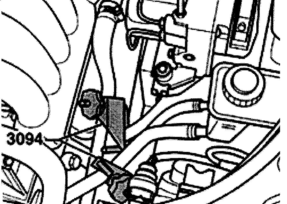

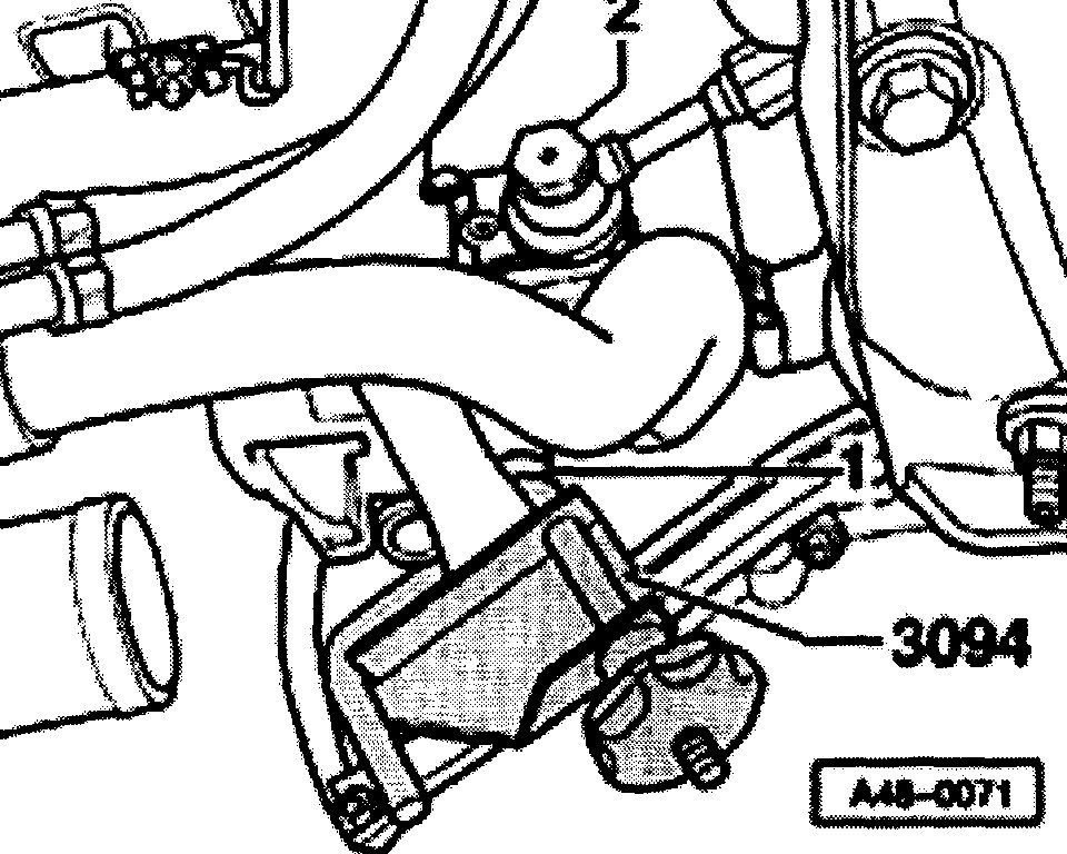

- Using 3094 hose clamps, pinch off suction and return hoses.
- Place oil catch pan in position.
pic 8
- Remove hose clamp -1- from suction hose.
- Remove suction hose, press out of retainer and lay to side.
- Remove pressure line -2-.

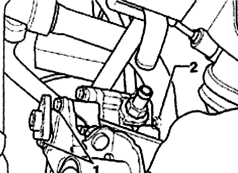

Removing power steering pump (power steering pump FP-4) m.y. 1997 -->
pic 9
- Remove hose clamp from suction hose -1-
- Remove suction hose and lay to side.
- Remove expansion hose -2-.
pic 10
- Remove bolts -1- and socket-head bolt -2-.
- Remove pump.

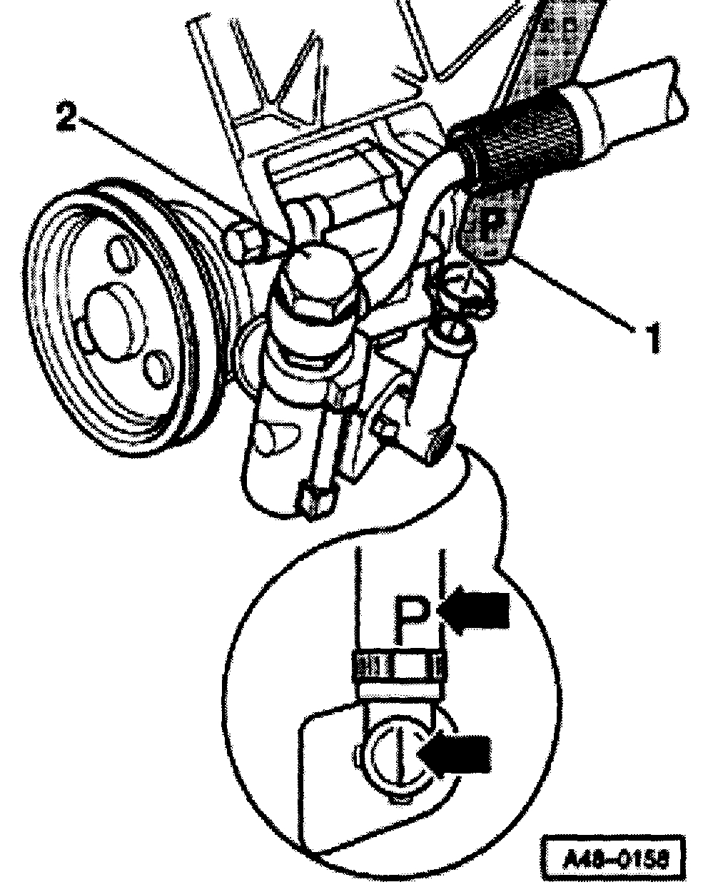

Installing power steering pump (power steering pump FP-4) m.y. 1997 -->
pic 12
- Install pressure line and tighten banjo bolt -2-.
Always replace seals
Tightening torque: 50 Nm (37 ft. lbs.)
- Install suction hose -1-.
Mark -P- (upper arrow) must align with seam on pump (lower arrow)
- Remove 3094 hose clamps.

I wanted an additional opinion. I replaced the Bosch re-manufactured pump with brand new pump (supposed to be the original manufacturer ZF) and carefully poured new fluid into the pump as you directed, carefully turned the steering wheel lock to lock when suspended and off, until there were no more bubbles, only a few came out anyway, then turned it on did the lock to lock, like 20 times, totally silent while suspended but the odd whine returns when on the ground. I purchased a mechanics stethoscope and put it to the outlet hose and that is where the sound is. It whines and does groans when hard turns are performed. Now what? Do I just replace the pressure hose with one from Gates? or do I have to really spend big money and get the Audi one for like $275.00 I cannot figure out what is causing this whine.
Apr 20, 2020 at 12:40 AM
Just to confirm, you are only hearing the noise now when you make lock to lock turns? All power steering pumps make some noise so I am wondering if we are chasing a normal noise at this point. Clearly I am not looking at it and you are capable of knowing if this is normal or not but I am just bringing up the point.
Thanks
Apr 21, 2020 at 1:44 AM
PETER ANDRULIS
  • 25 POSTS
Well, it is all the time, and the whine varies when the rpm vary, even changes when the windows go up and down.
Apr 21, 2020 at 3:07 AM
  • 110,244 POSTS
Peter, is it possible for you to record the noise so we can hear it?
Apr 22, 2020 at 2:09 AM
PETER ANDRULIS
  • 25 POSTS
This is the sound.
Apr 24, 2020 at 10:43 PM
That helps a lot. That is air in the system or a pump. However, with everything you have done, I would be surprised it was a pump. I guess it is possible that the Audi part would be better quality but that is a guess at this point. All I know is that this noise is caused by air going through the pump or the pump itself.
Let's see what Joe thinks as well. Maybe he has a different thought but I highly doubt a line would cause that at this point.
Apr 25, 2020 at 2:30 AM
PETER ANDRULIS
  • 25 POSTS
I've been researching this online for the last 4.0 hrs and have discovered something called a restrictor on this attached picture. There is also one present on the replacement,,, albeit only some of them.This is what was rusted out on my old line. I am not sure it goes all the way thru the line, perhaps only on the outside of it. So I am planning on adding this new line in place of the custom line I had made.
Apr 25, 2020 at 5:21 AM
PETER ANDRULIS
  • 25 POSTS
I also discovered another restrictor in the coolant return line. I will put the old restrictor in the line I made or buy the hose as shown on the ecs pic. Will let you know what and how it resolves the whining noise. One right up talks about the continued cavitation so I think it's moving through there too fast. Will let you know the outcome so you can share in future as needed.
Apr 25, 2020 at 5:26 AM
  • 110,244 POSTS
Thanks for getting back to us. I look forward to hearing if this takes care of the problem.
Let us know.
Apr 25, 2020 at 4:03 PM
PETER ANDRULIS
  • 25 POSTS
Epilogue : I tried to replace the custom pressure hose I had manufactured with the factory replacement which had the factory installed restrictor which was missing from my custom build. After 4.0 hours of trying to install the Gates brand hose, it was off enough within the metal curly bends and entry bend that it was off by 1/4" and would not align with the bolt orifice that could be forced by the left hand only while holding on to the banjo bolt trying to screw it on with index finger only. So, after 4 hours, and about 40 tries I abandoned that and tried going back to my custom hose shop with the factory hose to see if they could install a restrictor. They could, and installed one inside the hose.
I asked what size he used and he said it was quite small. I was able to install the custom line, which re-used the original Audi pipe bends and angles and was successful with the dry fit and a one handed install, and a lot of prayer. I then installed the new return cooler hose with its restrictor. After I got the car front off the ground and performed the bleed procedure, along with replacing the power hose banjo bolt with a new one which had a spring and plastic bearing inside, theorizing it was worn as well, it had no whining on start up, nor during the test ride. A very slight normal whine can be detected but I would consider that normal. So the very loud whining in my case was missing restrictors in the replacement lines, which when resolved, solved the problem. Thanks for the intelligent discussions !
May 4, 2020 at 3:14 AM
  • 110,244 POSTS
Hi Peter,
I'm glad to hear you got it fixed. Honestly, anything to make it a little more confusing. I'm on my second Audi and absolutely love it until it breaks. LOL Nothing is ever straight forward.
Thank you for letting us know the cause. Honestly, I feel confident it will help someone in the future.
Take good care of yourself and feel free to come back anytime.
May 4, 2020 at 1:36 PM
PETER ANDRULIS
  • 25 POSTS
One more thing. I was able to purchase a brand new power steering pump from Europa Parts for $185.00 that was less than the Bosch re-manufactured from Rock Auto. It was made by the same manufacturer ZF that made the original for Audi. It was quieter and it's so nice to have a new pump in there.
May 4, 2020 at 7:57 PM
I have seen it many times but here is another example of "you get what you pay for." I have to commend you for sticking with this and pulling the trigger on a new pump.
Thanks for the update and glad you got it quieted down.
May 5, 2020 at 11:59 AM
