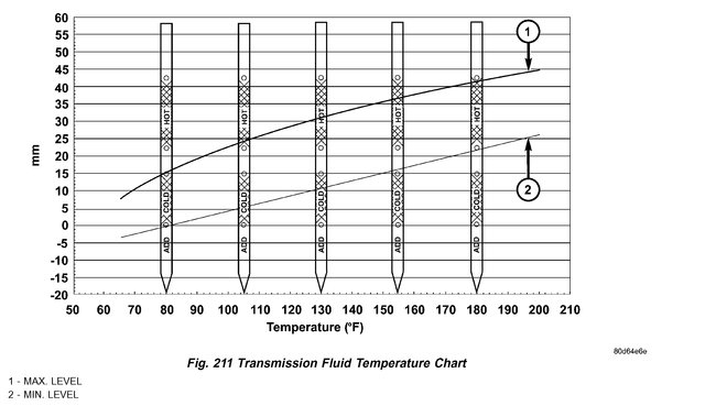

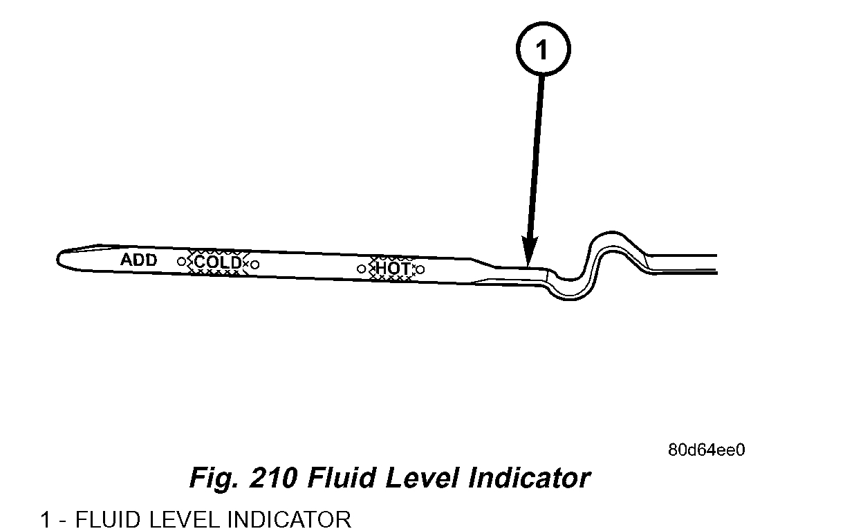

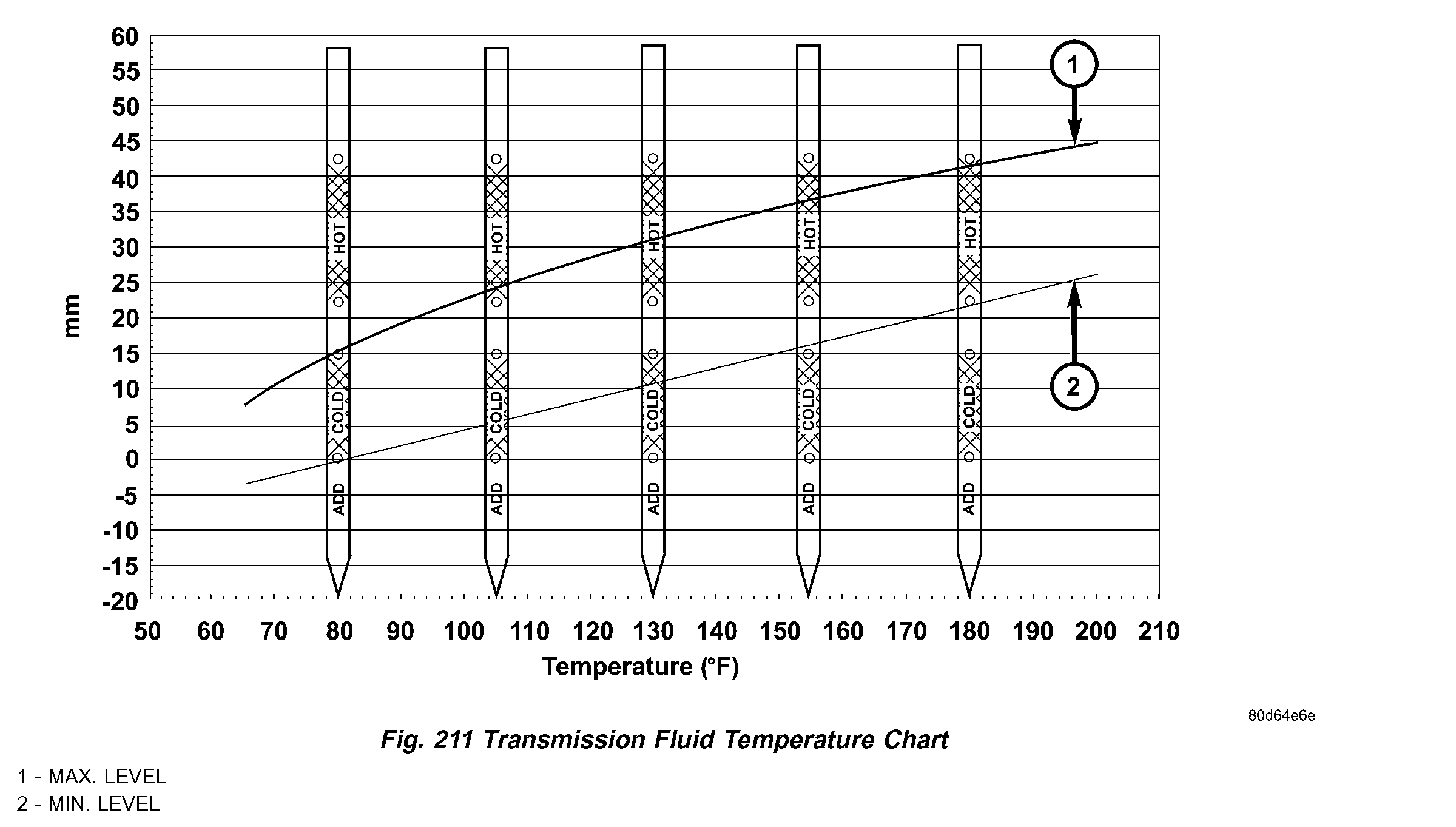

My van will crank and run but is making a whining noise. It will rev up real high and not go anywhere, and is not wanting to go into gear.
Aug 26, 2020 at 10:04 AM
If the transmission is acting like it is making this noise and not moving, I highly suspect you have a fluid issue. Either it is low or in such poor quality that it needs to be serviced. Let's start with checking the fluid and then service it and go from there.
The whining noise that you are hearing is most likely the pump sucking air and not fluid so I think it is low on fluid.
Let's start with this and go from there. Thanks

It sounds like a transmission related issue. Have you checked the transmission fluid to make sure it is clean and full? Also, could you record the sound you hear and upload it for me to hear?
_____________________________
Here are the directions for checking fluid. The attached pics correlate with the directions.

FLUID LEVEL CHECK
The transmission sump has a fluid level indicator (dipstick) to check oil similar to most automatic transmissions. It is located on the left side of the engine. Be sure to wipe all dirt from dipstick handle before removing.
pic 1
The torque converter fills in both the P Park and N Neutral positions. Place the selector lever in P Park to be sure that the fluid level check is accurate. The engine should be running at idle speed for at least one minute, with the vehicle on level ground. At normal operating temperature 82° C (180° F), the fluid level is correct if it is in the HOT region on the oil level indicator (Fig. 210). The fluid level should be within the COLD region of the dipstick at 27° C (80° F) fluid temperature.

5. Compare the fluid temperature value with the fluid temperature chart (Fig. 211).
6. Adjust transmission fluid level shown on the indicator according to the chart.
7. Check transmission for leaks.
Low fluid level can cause a variety of conditions because it allows the pump to take in air along with the fluid. As in any hydraulic system, air bubbles make the fluid spongy, therefore, pressures will be low and build up slowly.
Improper filling can also raise the fluid level too high. When the trans-axle has too much fluid, the gears churn up foam and cause the same conditions, which occur with a low fluid level.
