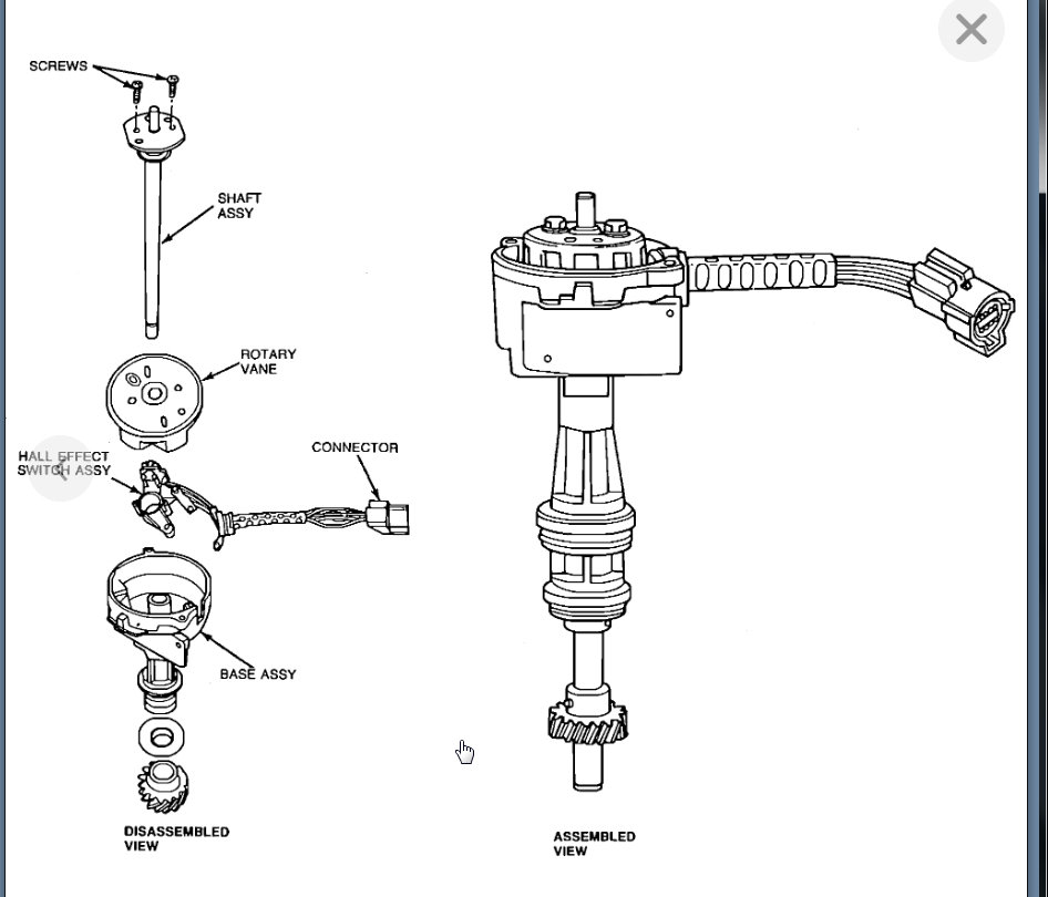

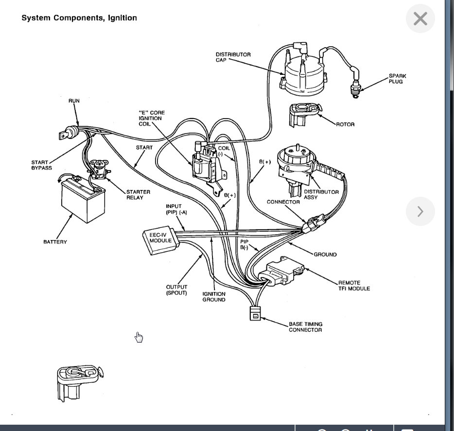

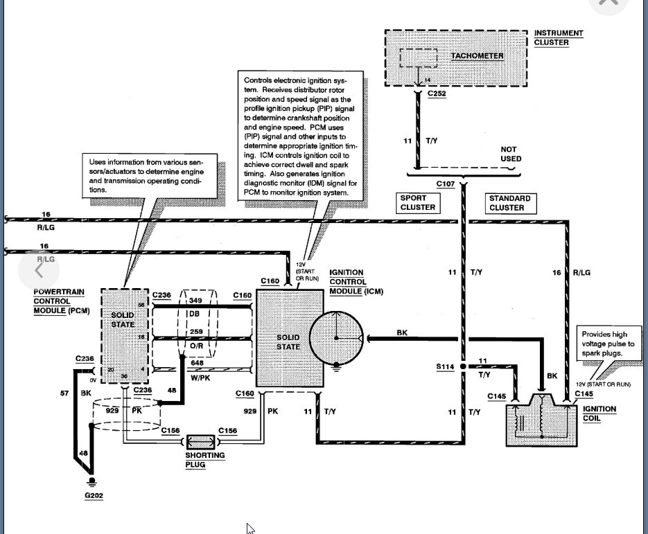

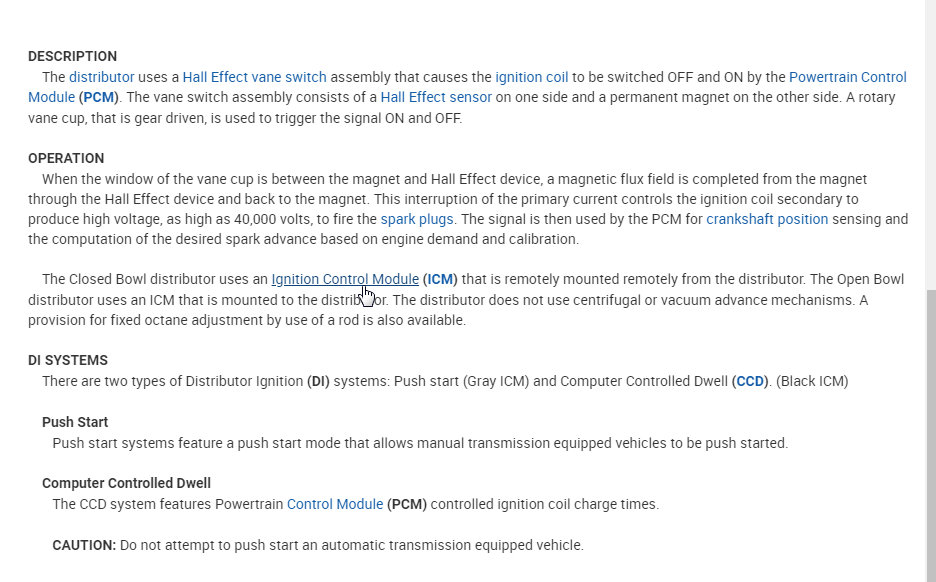

Okay. If there is no spark then we need to start going through the system to see where we don't have voltage. I attached some info but we need to go to the coil and see if you have voltage coming in from the ignition switch and the control module.
If you do not then you could have a crank sensor issue. However, let's start with checking voltage on the 3 wires for the coil.
