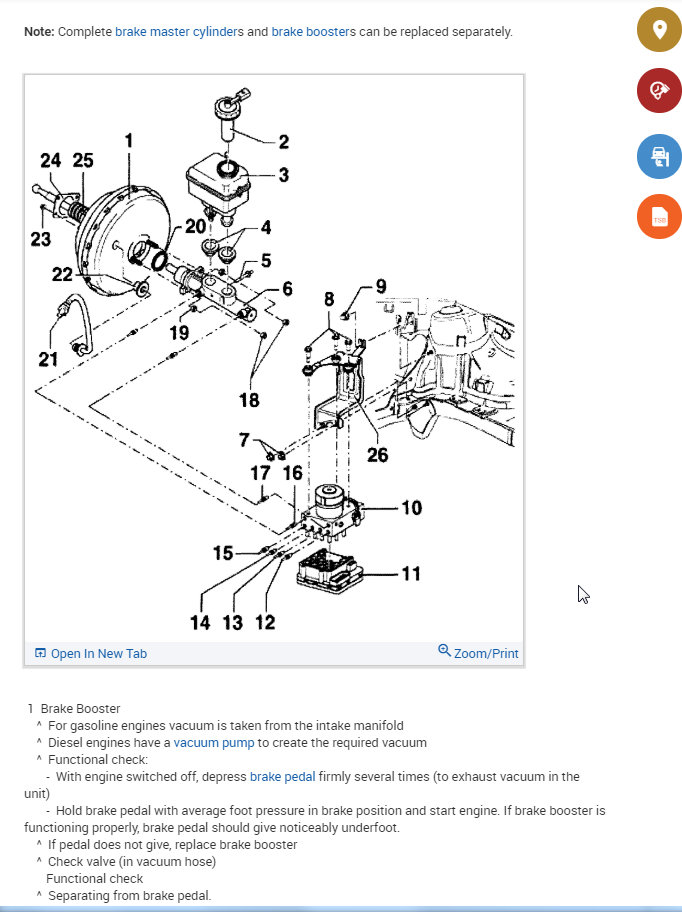

If the pedal is going to the floor, chances are either you have brake fluid leaking, the fluid is low, or the master cylinder has gone bad. If the fluid is full and there are no leaks, it's most likely the MC.
Take a look through this link:
https://www.2carpros.com/articles/brake-pedal-goes-to-the-floor
I suspect the vibrating is the ABS actuating. If you determine the MC is the problem, here is a link that shows in general how one is replaced:
https://www.2carpros.com/articles/how-to-replace-a-brake-master-cylinder

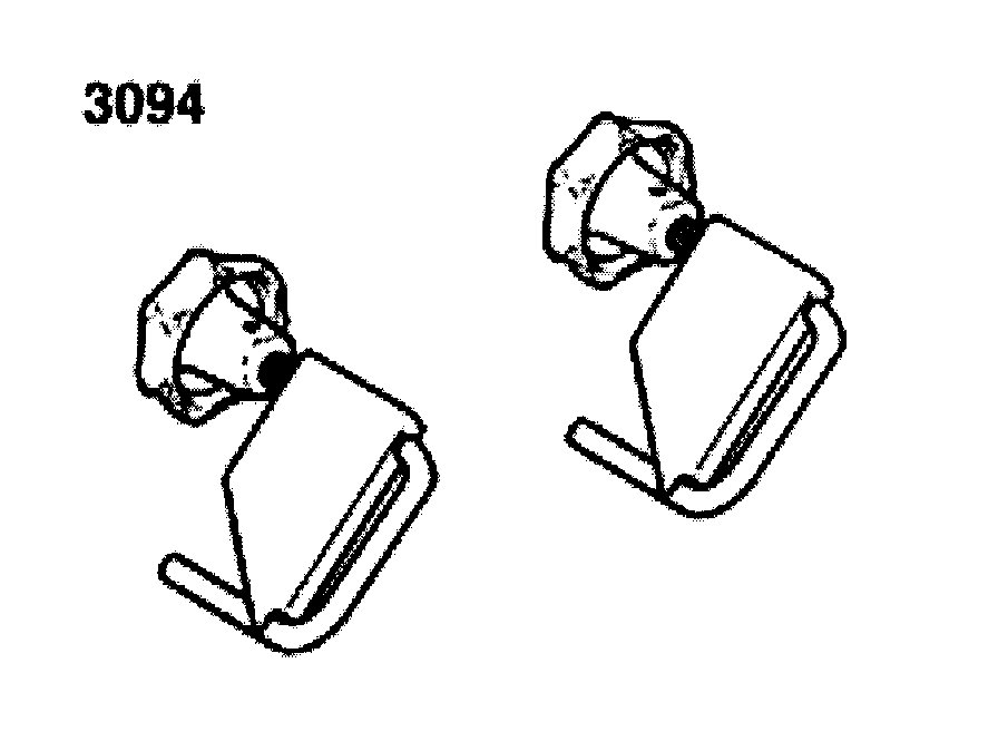

Here are the directions specific to your vehicle. The attached pics correlate with the directions.
_____________________________

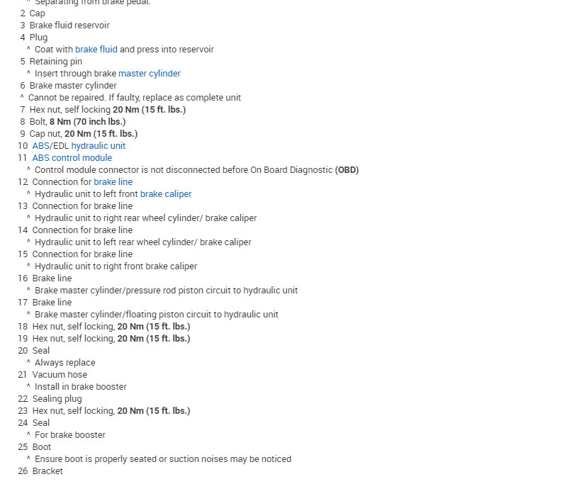

2002 Volkswagen Golf GL (1J1) L4-2.0L (AVH)
Removing and Installing
Vehicle Brakes and Traction Control Hydraulic System Brake Master Cylinder Service and Repair Procedures Removing and Installing
REMOVING AND INSTALLING
Brake master cylinder
Special tools and equipment required
pic 1
^ 3094 Hose clamps or equivalent
Removing

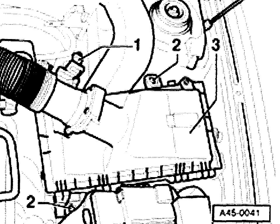

^ Disconnect or connector -1- of Mass Air Flow (MAF) sensor from air filter tube.
^ Remove bolts -2- at air filter -3- and move filter to left side.

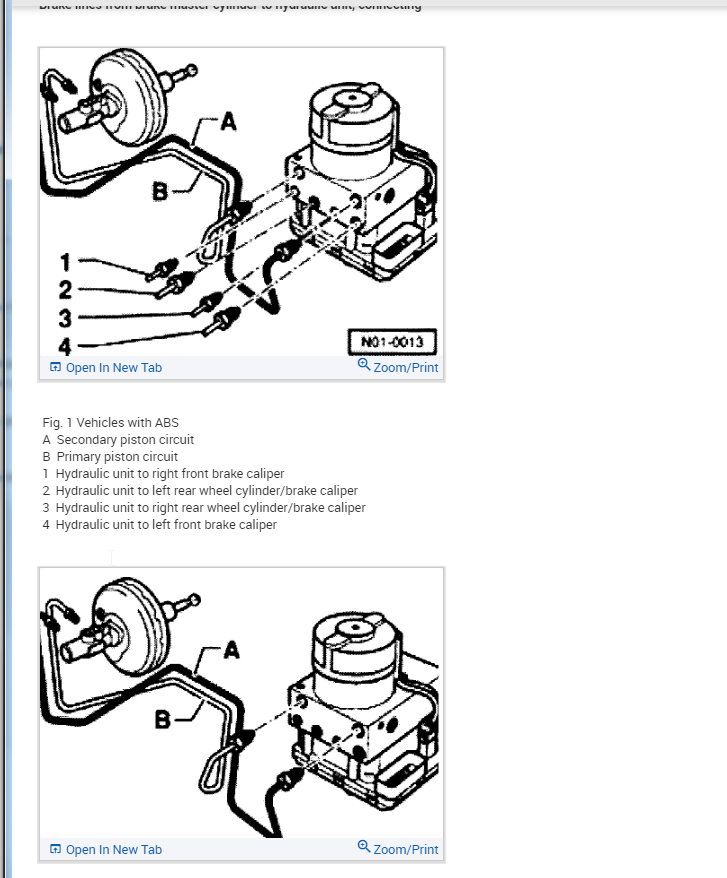

Vehicles with automatic transmission
pic 3
^ Disconnect wiring connectors from pressure sensors -a- and -b-.

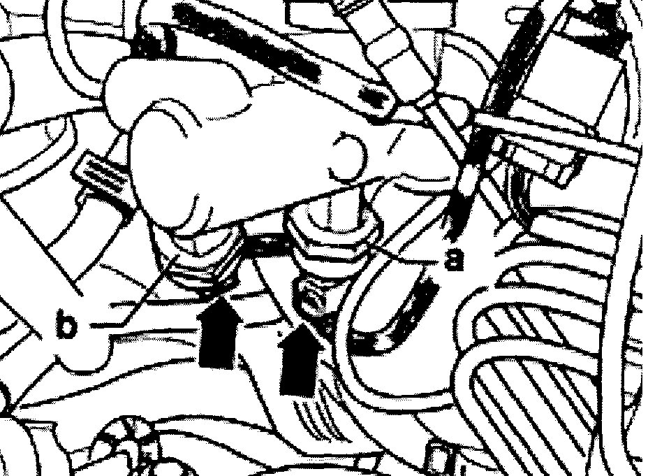

^ Disconnect brake lines at brake master cylinder and seal with plugs from repair kit, Part No. 1H0698311 A.
^ Remove nuts securing brake master cylinder to brake booster.
^ Remove heat shield if installed.
^ Carefully remove brake master cylinder from brake booster.
Installing
^ Install master cylinder in reverse order of removal.
Observe the following points when installing:
^ When connecting brake master cylinder and brake booster, be sure that push rod is correctly located in brake master cylinder.
^ After installing, bleed brakes.

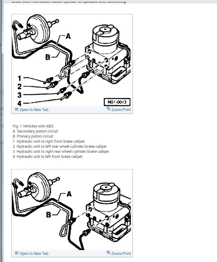

More than likely you have a leak. Have you found any fluid on the ground?
If not, then I suspect the hydraulic unit is leaking internally.
Clearly we need to check out the basics. Here is a guide that will run through the most common causes. Let us know what you find.
I also attached some generic info about your brake system just to get us started.
