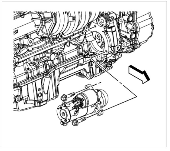

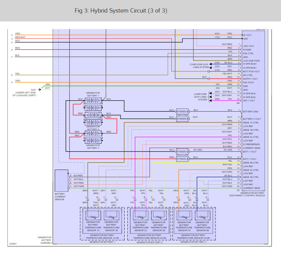

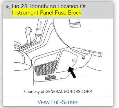

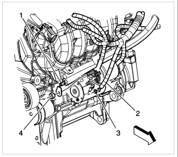

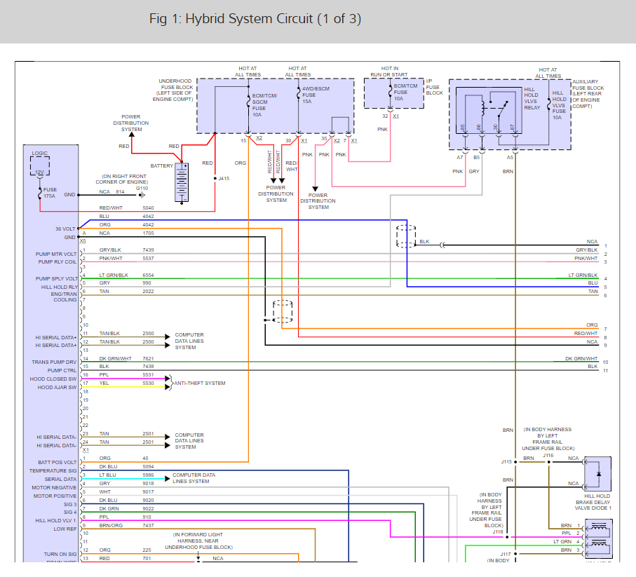

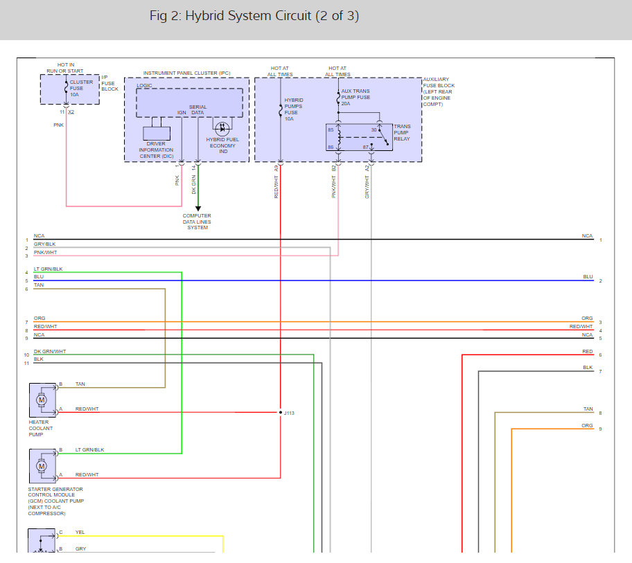

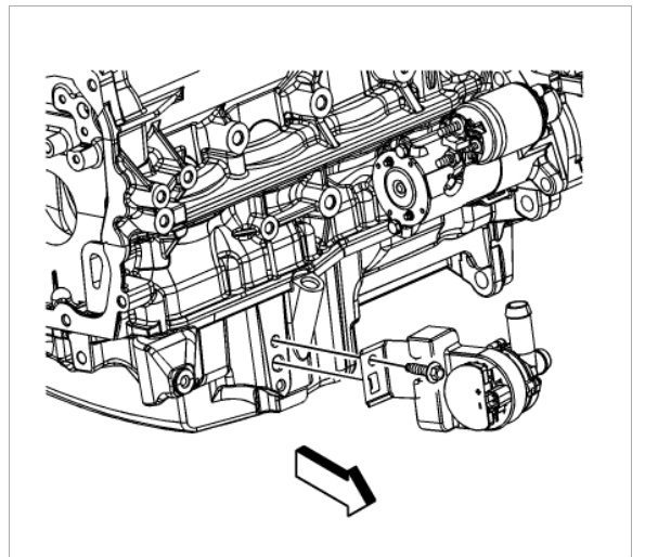

I am having problems when the electric motor is performing an automatic restart of the engine. My car will go into auto-stop like normal, then upon restart i can hear the engine cranking to restart, this is unlike the usual quieter restart of the engine after auto-stop. Any ideas?
Jan 8, 2018 at 8:50 AM
  • 54,837 POSTS

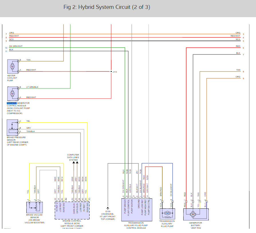

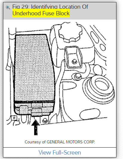

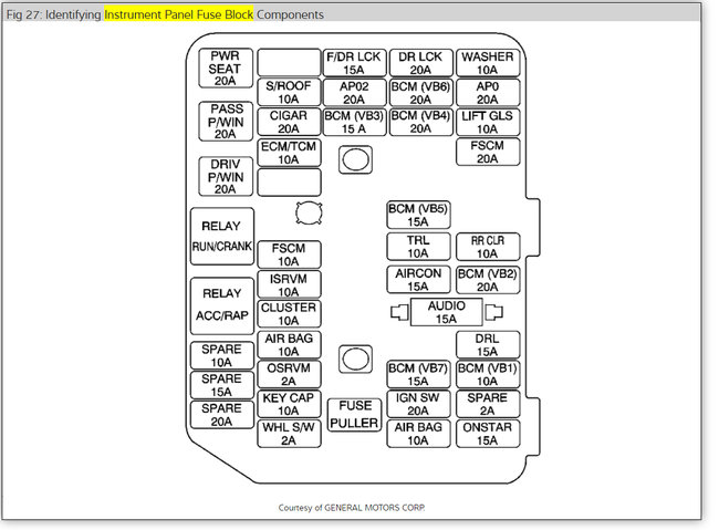

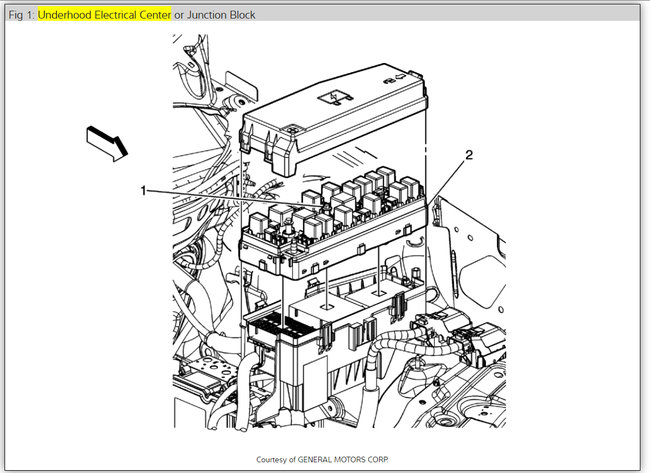

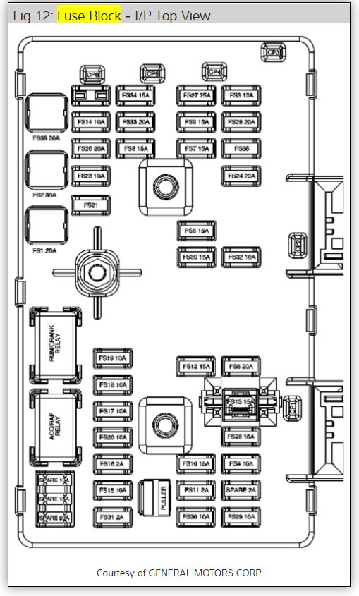

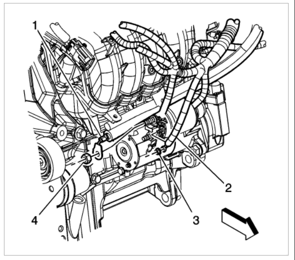

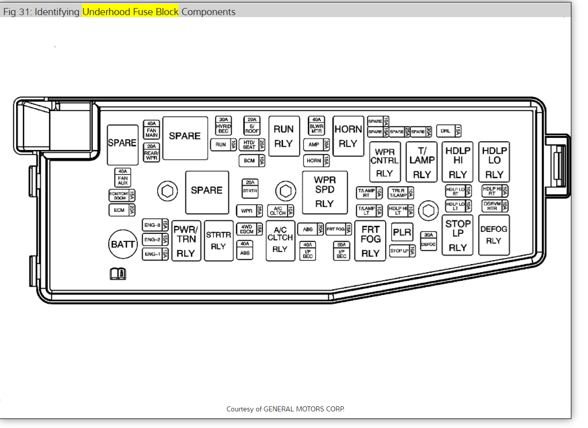

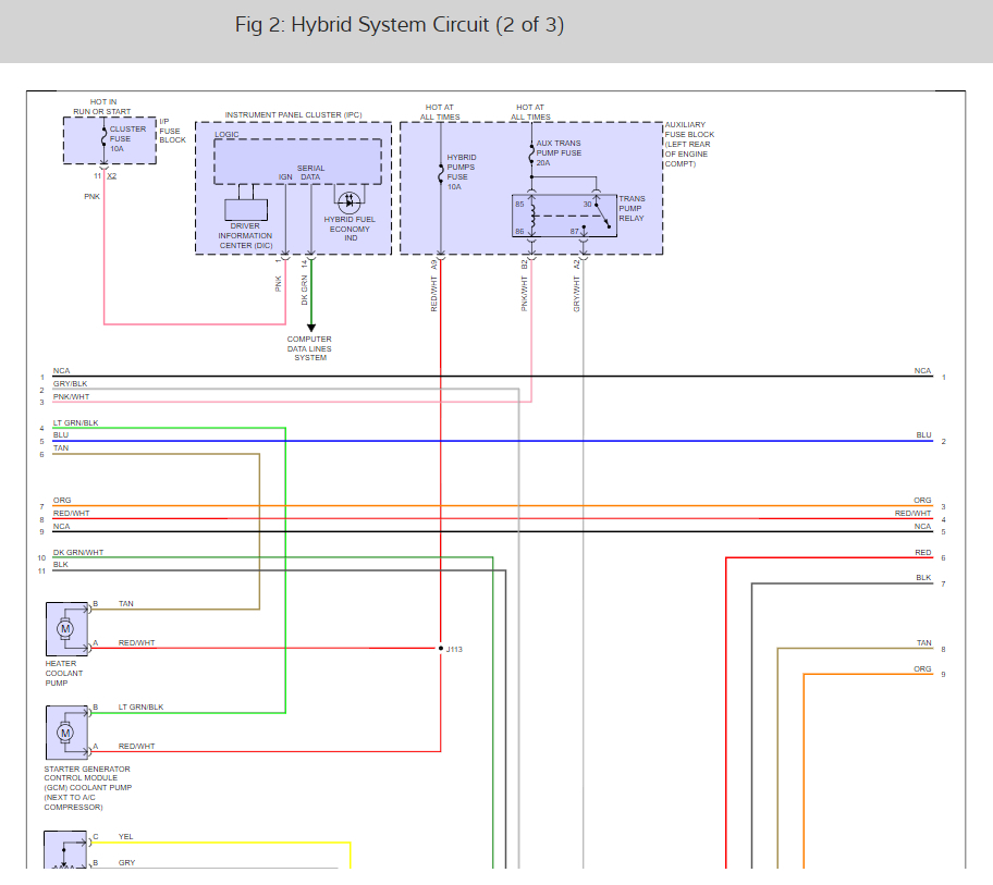

This sounds like you have a starter module going out which it will engage the engine starter instead of using the hybrid engine to start the engine up. I would start by checking the fuses for the system which are ECM/TCM/ SGCM FUSE, 4WD/ESCM FUSE, ECM/TCM FUSE in the fuse panel, Here is a guide to help you get started:

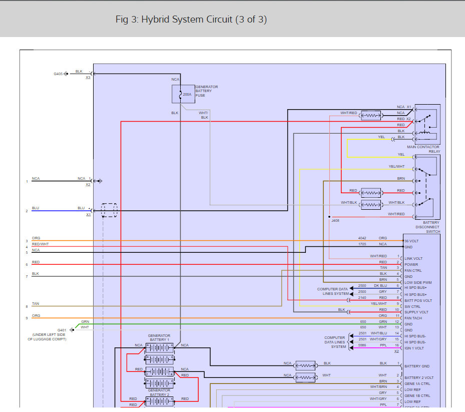

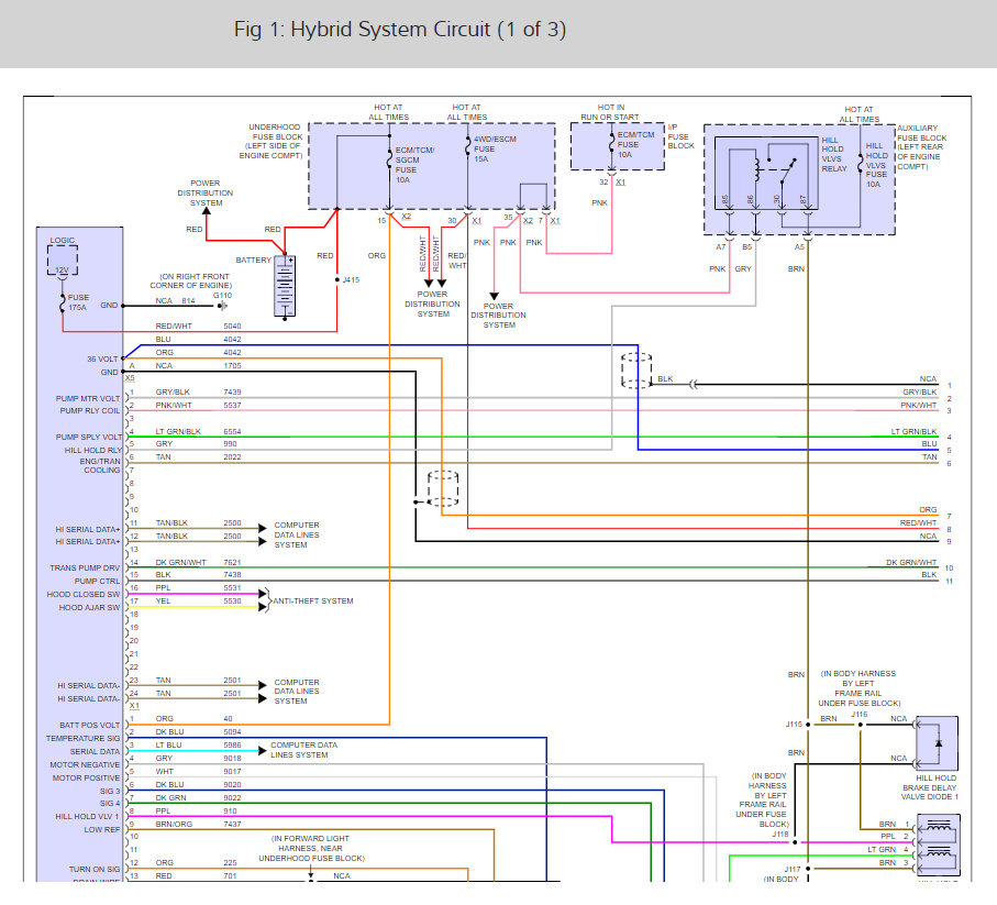

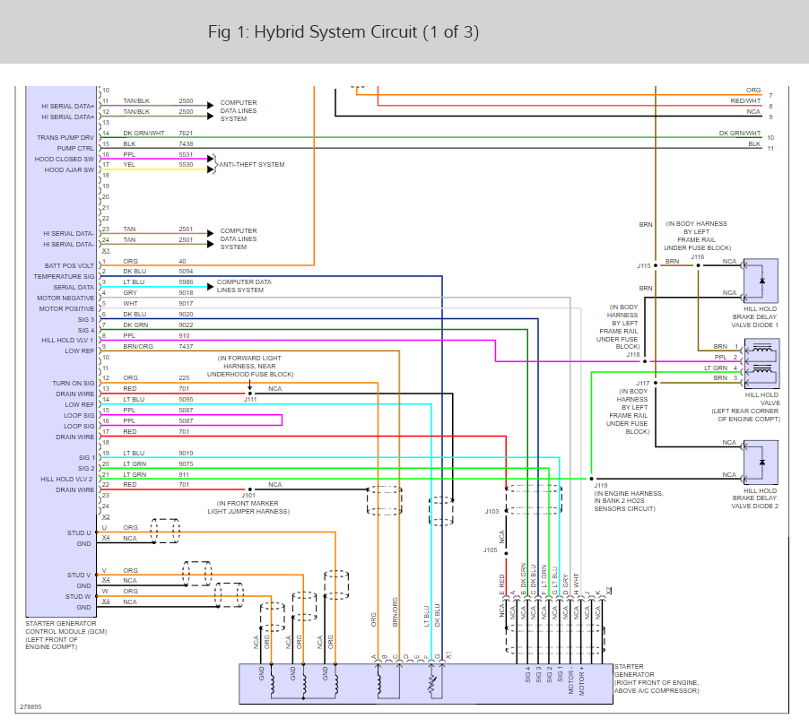

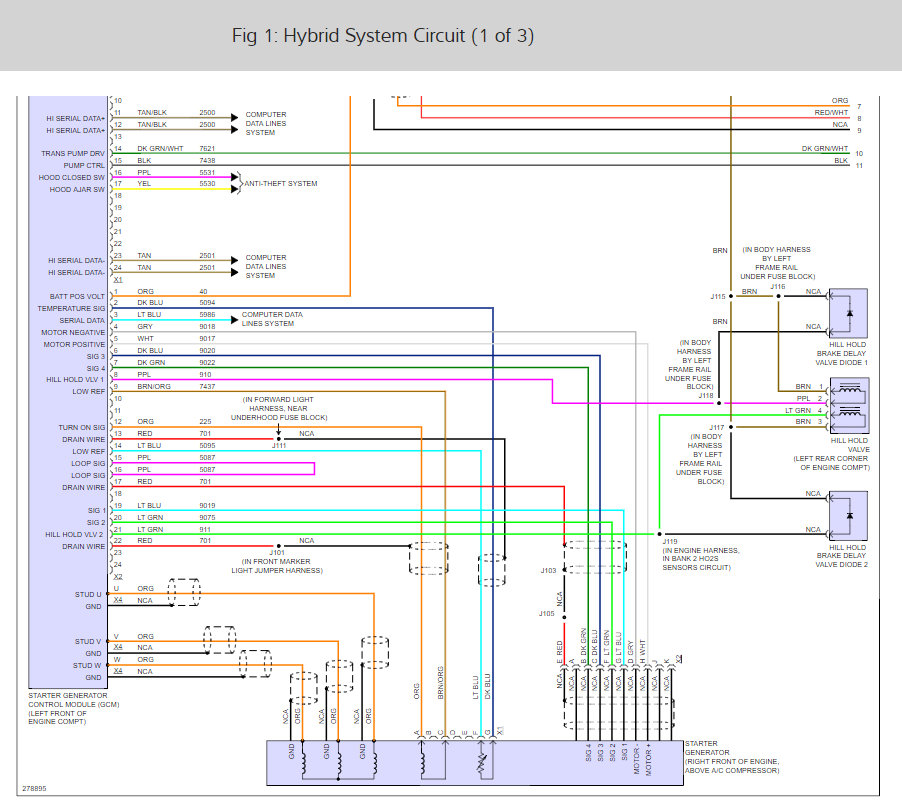

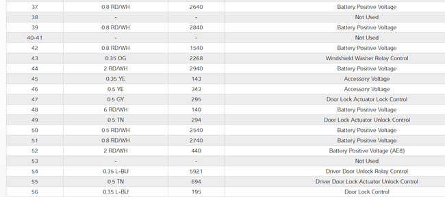

I have included the engine and hybrid wiring diagrams so we can see how the system works. The reason I think the generator starter module is out is because the car is starting the engine with the engine starter instead of the hybrid motor.
