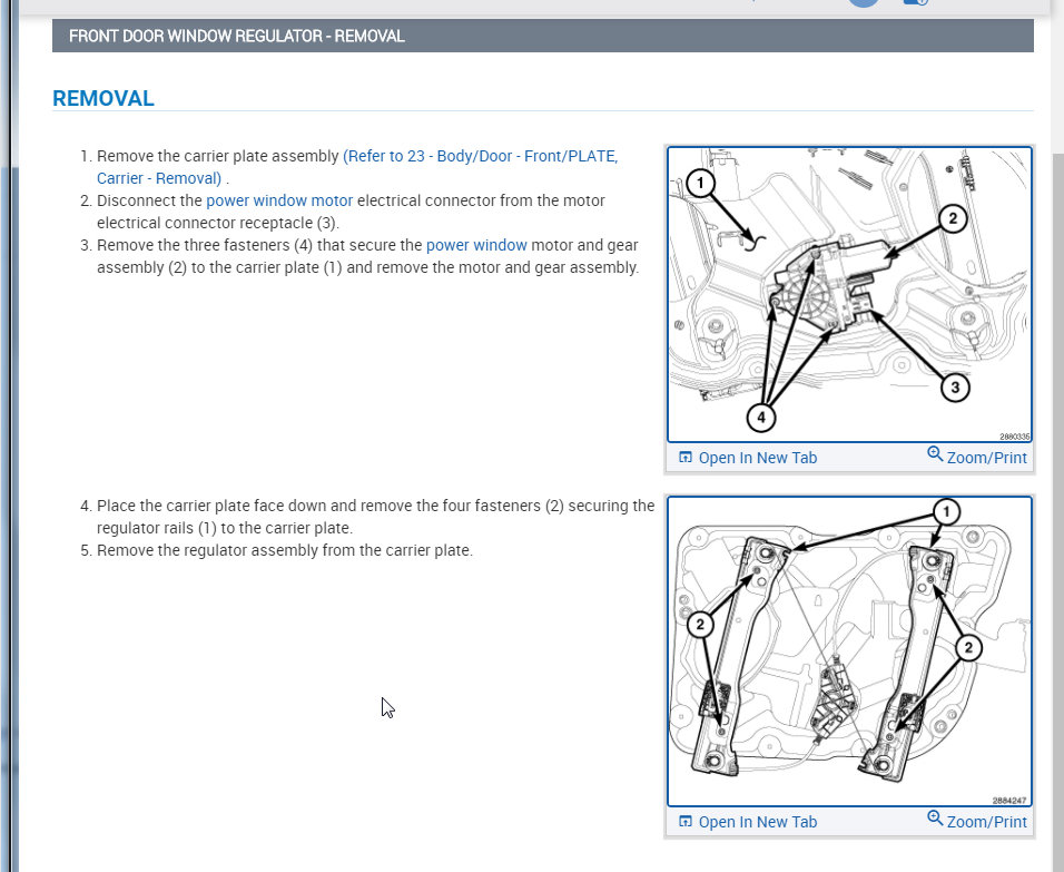

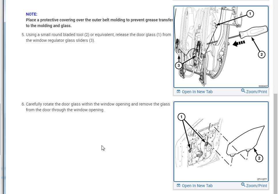

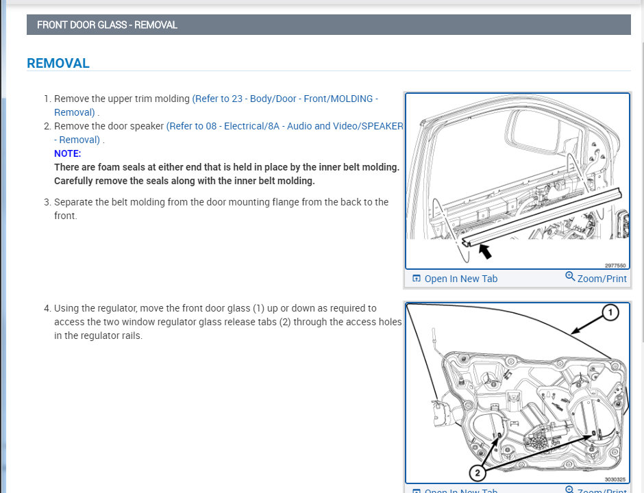

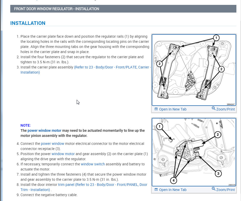

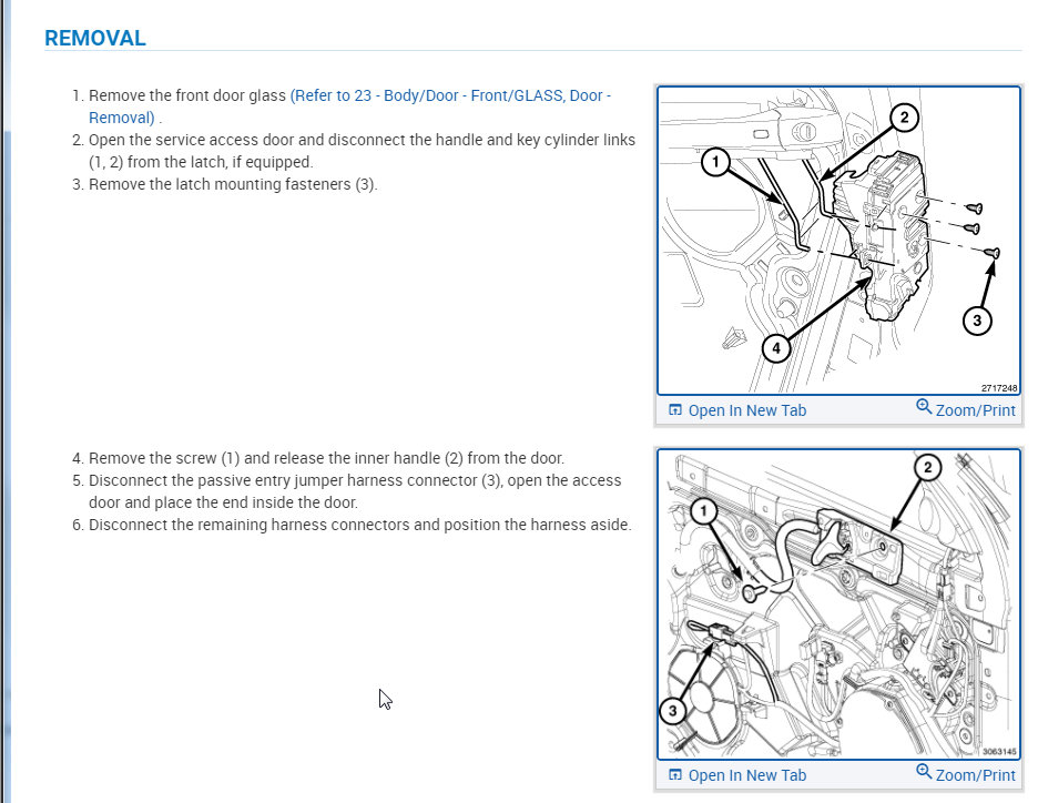

So I replaced the switch now the front right works from main switch, but not the driver side, but I now hear a strong click compared to a very faint click before, most likely the regulator or motor, will install a regulator/motor unit from a used car, can you send replacement instructions? Thanks
Sep 28, 2020 at 8:45 AM

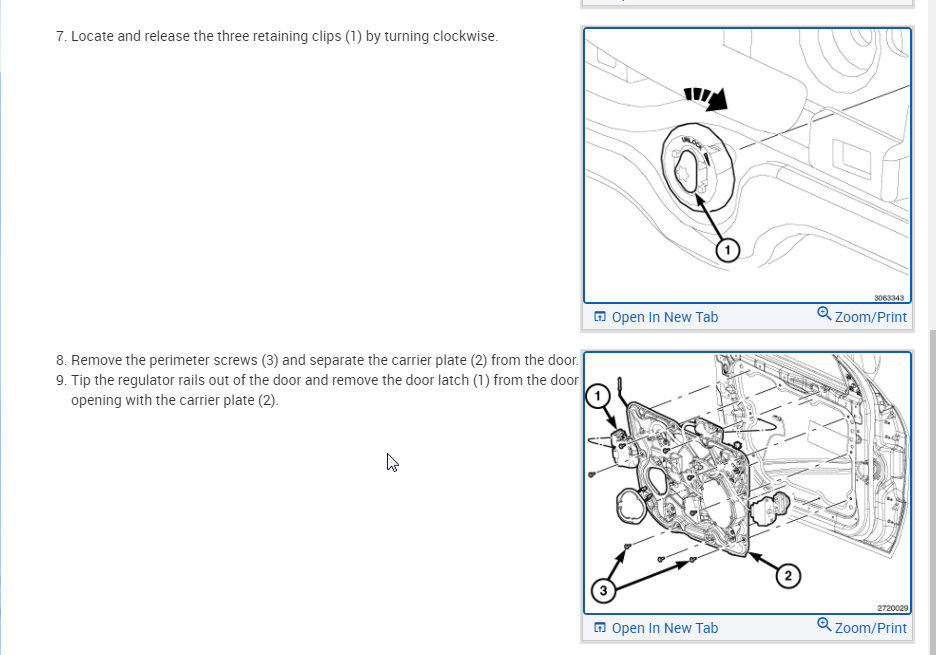

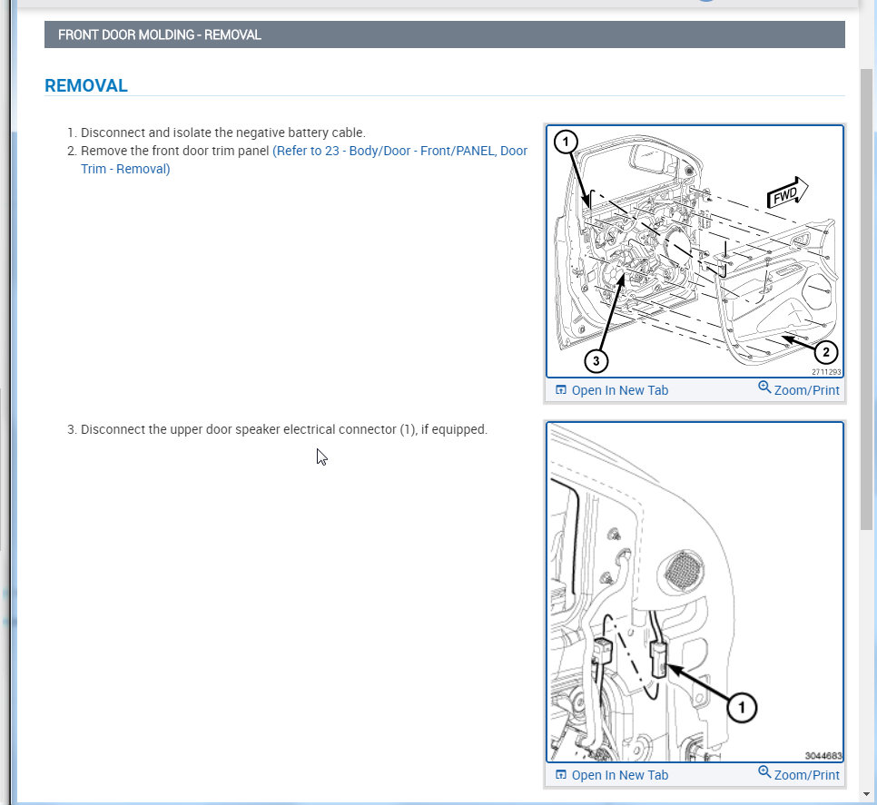

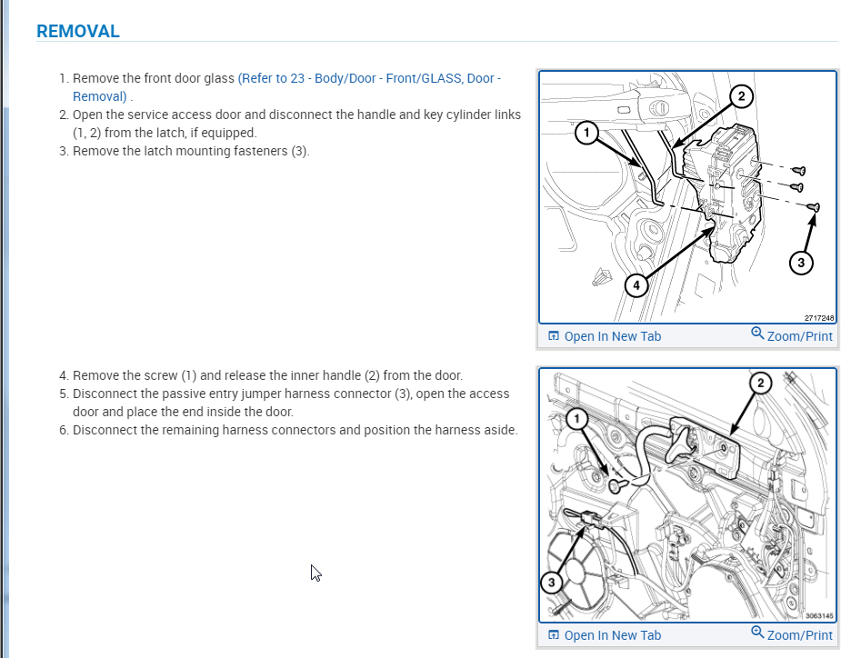

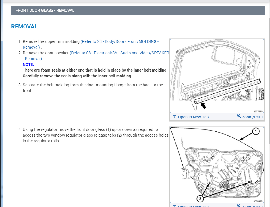

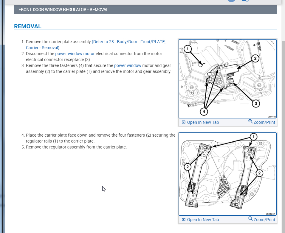

Sounds good. I attached the info. Let me know if you need more info. Thanks

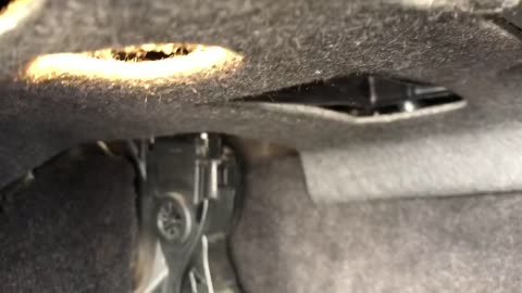

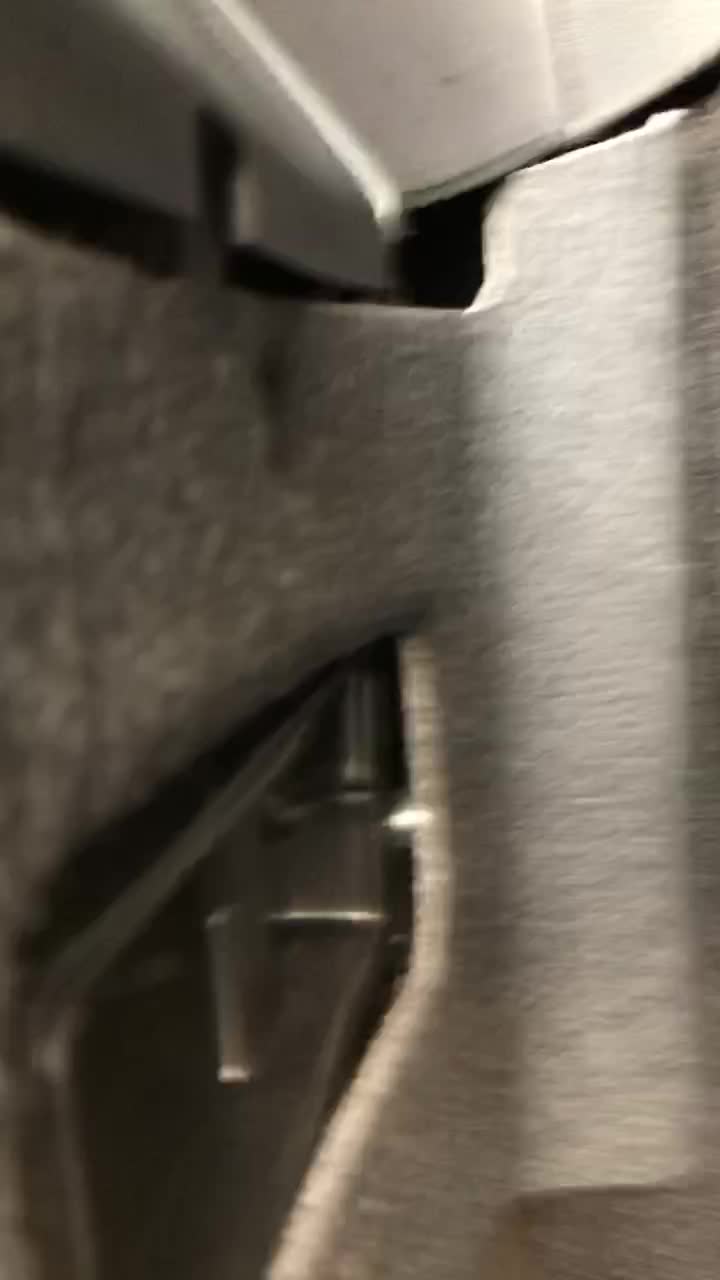

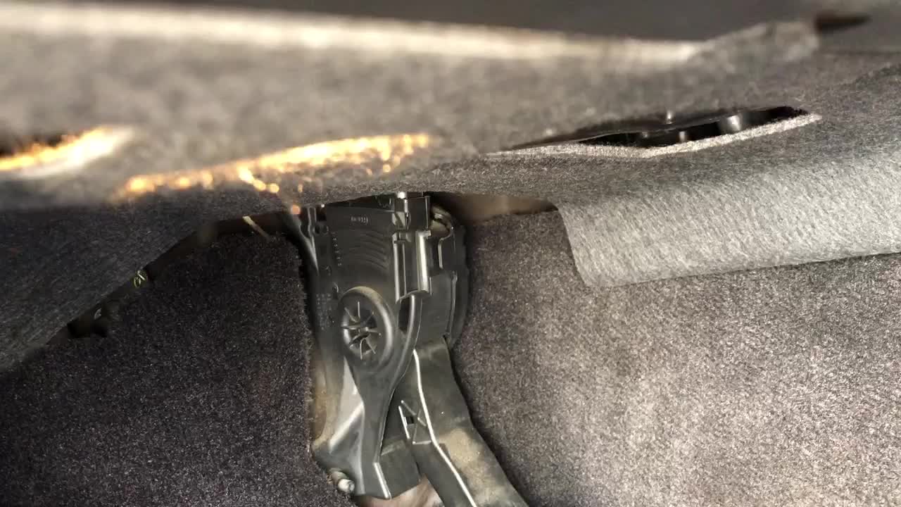

Also, whenever ignition on there is a lot of noise under dash listen and see if you have any idea what this is?

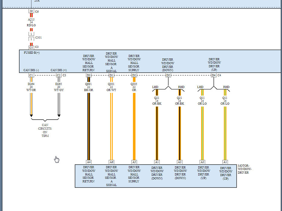

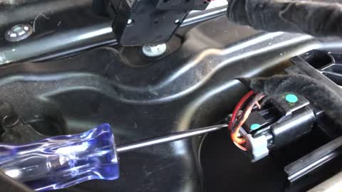

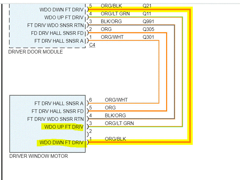

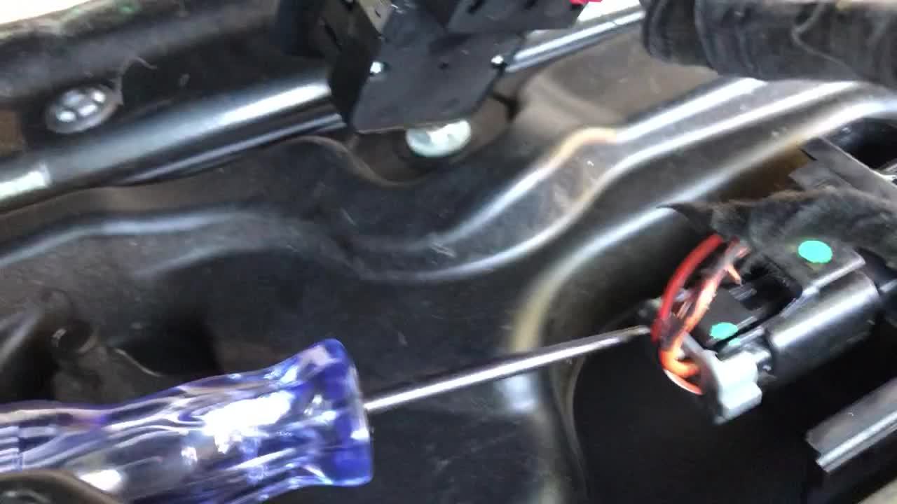

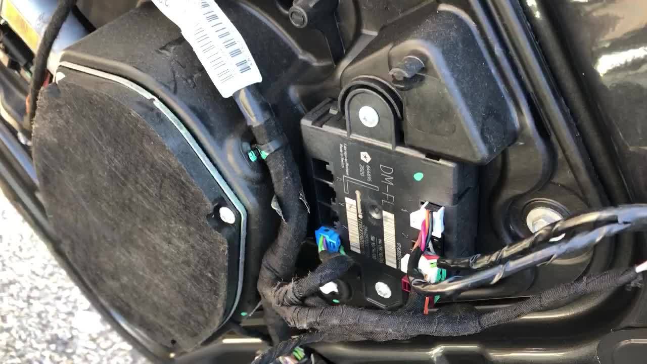

Orange/black at the motor via test light pushing switch down i get a light but no motor movement. Pushing the switch up i get motor movement but no light. Orange/light green pushing switch up i get motor movement and light, pushing it down i get a light and no movement.

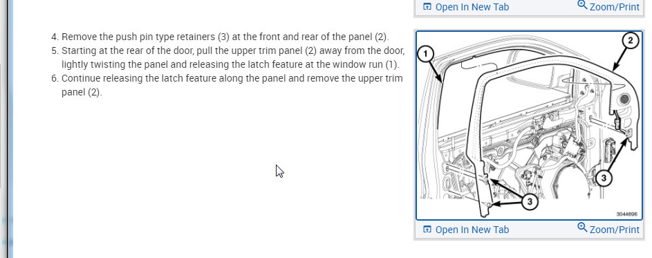

The orange and black wire sends power to the motor to lower it. The polarity is reversed when you take it up. The orange/light green wire should have power at that point. If you have power to the orange/black and it won't go down, I suspect something has jammed the motor from operating. See pic 1.
The idea that you get power at the orange/light green wire when you are in the down position is simply the power returning to ground a different direction. I suspect you will find the same if you try the opposite.
Remove the regulator and motor assembly and inspect it to see if there is something preventing it from moving.
Let us know what you find.

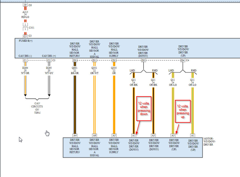

That clicking noise sounds just like a HVAC door actuator. I have heard that many times and in fact, I just replaced one on my sister in laws 2011 WK (just like this Jeep) and it was clicking like that right out of the box.

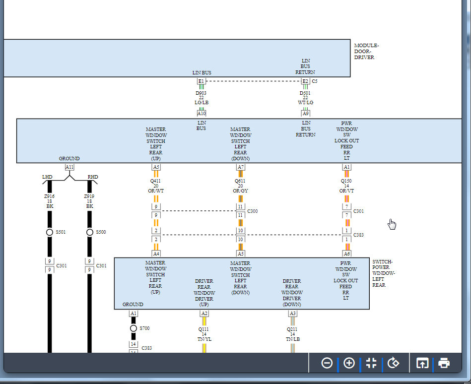

As for the window, just to confirm take a look at the diagram. If this is what you have for voltage then that is correct. You should only have voltage on one of those wires when you are pressing up or down.
Can you get a video of the window and what it is doing? You replaced motor and they are both doing the same thing, correct? Then where are you taking that voltage reading? Can you get a picture of the location of where you are getting it?

Sorry. No, there should be one of each color. The set of two wires of each color are showing for right hand drive vehicle and Left hand drive vehicle. Sometimes they are different. The RHD and LHD are what show this on the diagram. You want the wires for the LHD vehicle.

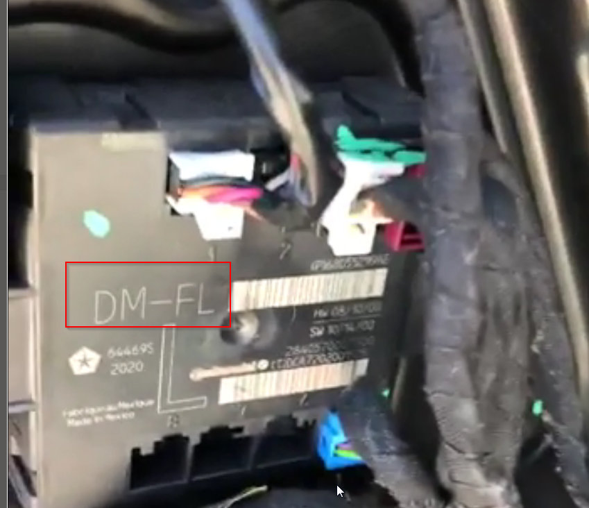

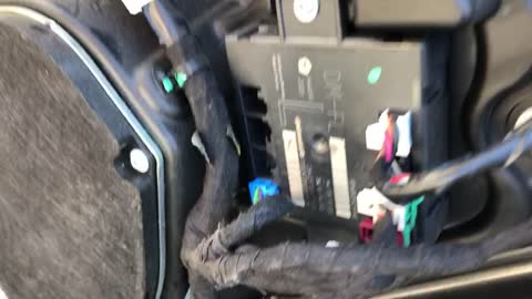

So you want to go to the motor and check power on the orange/black wire when you are pressing the down button. We need to make sure we have it at the motor. If you are checking it at the door module which I pictured from your video, then we may not be getting the voltage to the motor.
The DM FL stands for Door Module Front Left.
Oct 4, 2020 at 12:06 PM

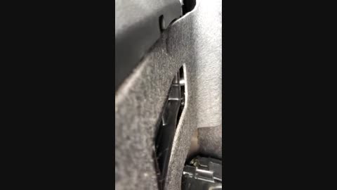

Here is a video showing what is going on. But like you said i have power when pressing down at the orange/black and i have power when pressing up or down at the orange/light green.

You have voltage on the orange light green when pressing up and down?
Let's forget everything except the door module. That is what is sending power to the motor. If I understand, the first module does not move either front window? The replacement module moves the passenger window properly but only up on the driver side?
If this is the case, then yes. I suspect the door module is shorted. You should only have voltage on one of those wires at a time when pressing up or down.
The black orange wire is the return (ground) wire for both circuits so you press the switch and it sends power to one side of the motor and returns to the module through the ground.
However, if you have power on the orange black (down) wire like you should when you press the down button, you should have nothing on the orange light green wire. However, you have power on that wire as well. So you have power on both sides of the motor when pressing the down button so it does nothing.
I would get another module.

A new module solved it! Thank ya all for all ya'll help.
