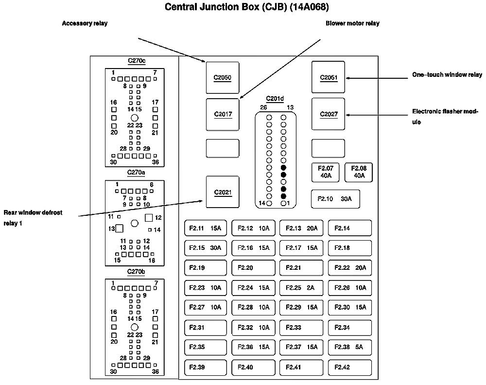

Power windows quit working need to know the location of the power window relay under the hood to get the windows working again.

It’s in the central junction box under the driver’s side of the dash. I’ve attached a picture of it, top right corner. Check out the diagrams (Below). Please let us know if you need anything else to get the problem fixed.

none of the pwr windows work i checked relays and fuses

Are you trying just the master switch? If so, try each door switch. If they work with the individual door switch, check the master switch.
Check switches for power with a voltmeter while working the switch. I would be surprised if all door motors went out at the same time.
If they don't work with any switch, and you have already checked relays and fuses, there might be a ground problem. I believe the ground for the power windows is on the drivers side behind the plastic panel next to the emergency brake. Make sure it is not broken or corroded.
