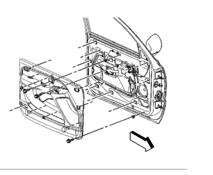

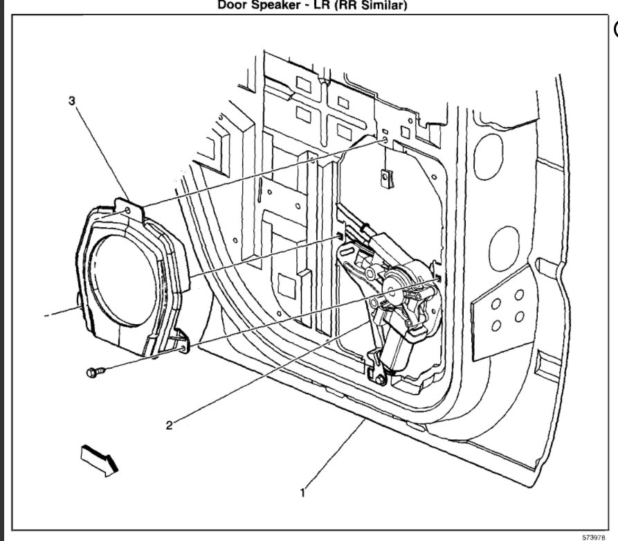

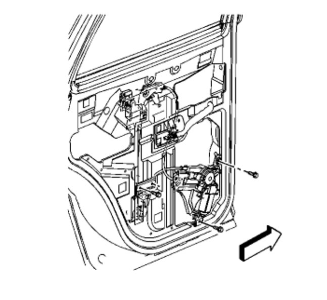

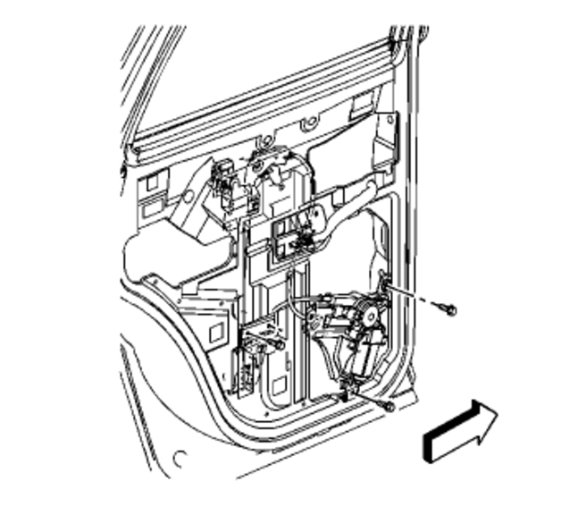

Power to motor. When down button is pushed then go to up mode, can pull window up by hand. What parts are involved? Window track, regulator, power window motor? Also, I need to replace both outer door latch handles. How are those removed?

You will need to remove the door panel to replace the window regulator and motor. Here is a guide to show you what you are in for.
https://www.2carpros.com/articles/door-panel-removal
Here is a guide for seeing what you are in for when replacing the window regulator:
https://www.2carpros.com/articles/how-to-check-and-replace-a-electric-power-window-motor

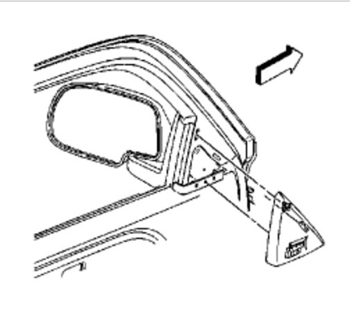

Below are some diagrams of what it will be like on your truck.
