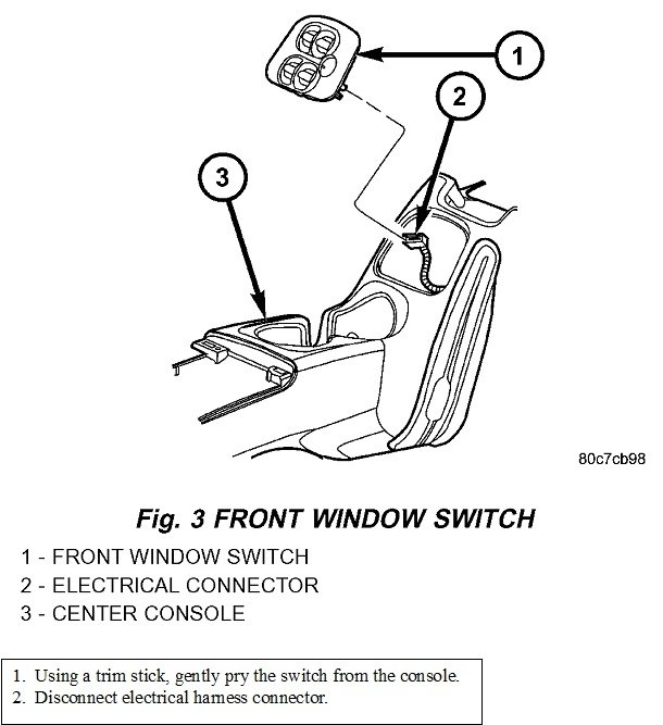

My window switch is on the center compartment between the seats.. Could it still be the driver door? If i'm getting power to the switches could it still be the wires?

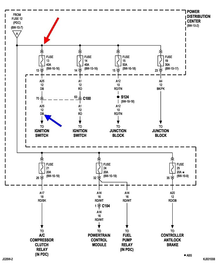

It can still be shorted wires, but that becomes less common when the switches aren't on the doors.

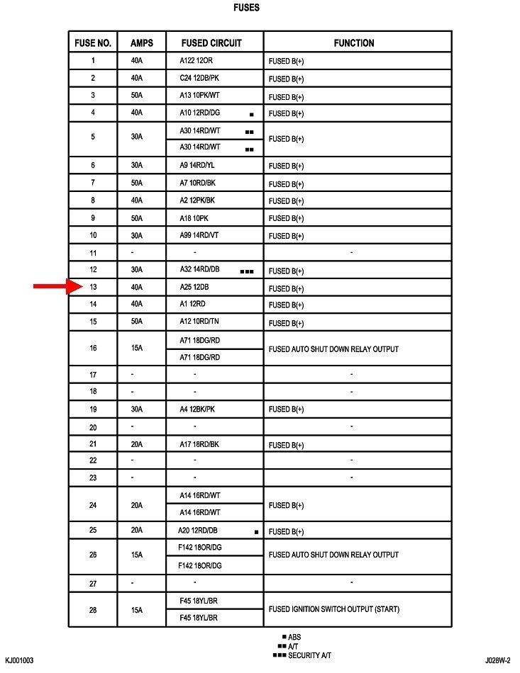

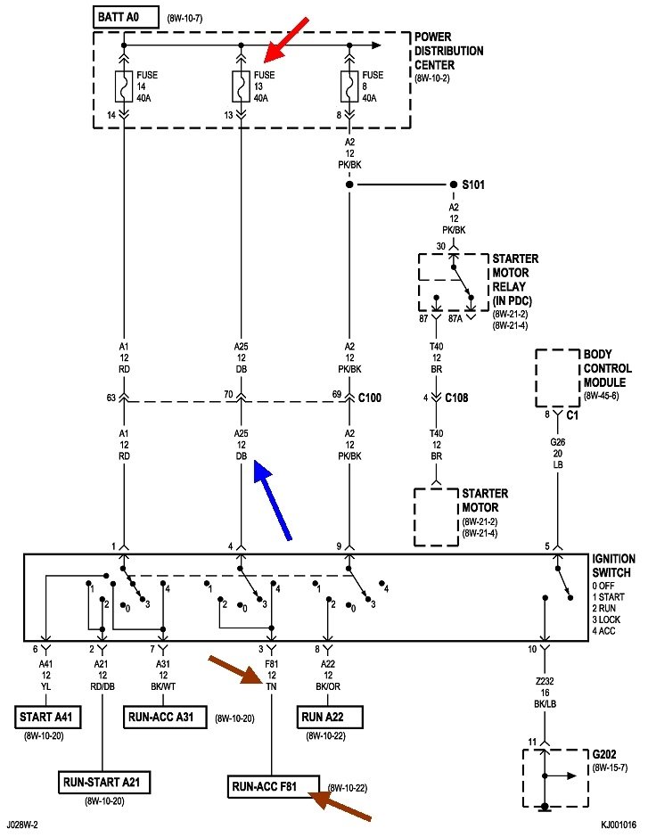

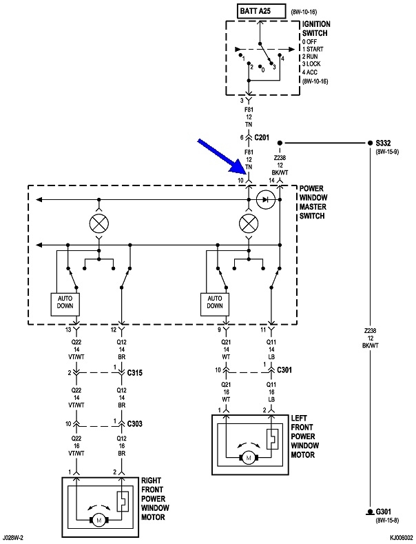

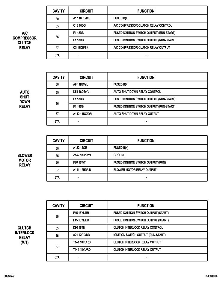

This first diagram is of the power window system, but they don't show which fuse is feeding this circuit. It's shown as "Battery A25" circuit. That should be the 40-amp fuse shown in the second drawing. Typically if that one is blown, a lot of other systems will be dead too. Rather than spending a lot of time looking for something we might not need, lets start right at the power window switches.
Pop the switch assembly out, then look for the tan wire in that harness. Check for 12 volts on that terminal when the ignition switch is on. You can use a voltmeter if you have one, but but for this type of problem, I prefer an inexpensive test light. You can find them at Harbor Freight Tools, or any hardware store. Here's links to articles that show how to use them, if you need them:

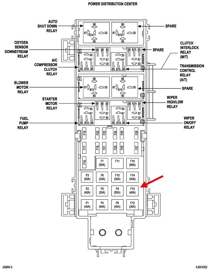

The fuse under the hood isn't blown and i'm not getting any power to my electrical connector at all. Is there another fuse? Before I start going through the wires.. What do you think I should check next??
Feb 1, 2020 at 6:11 AM
CARADIODOC
  • 34,367 POSTS

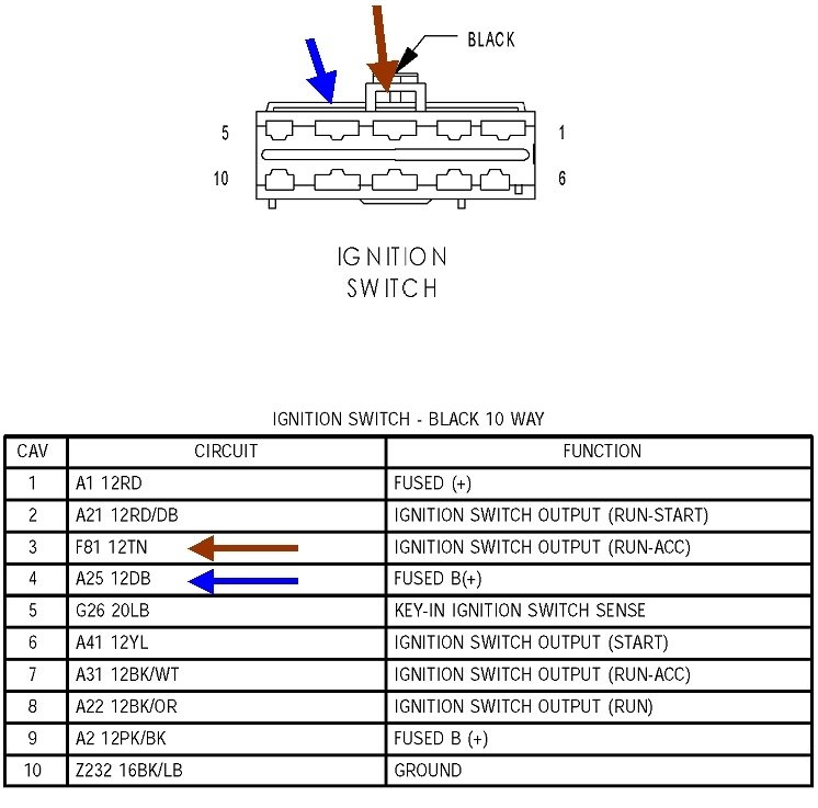

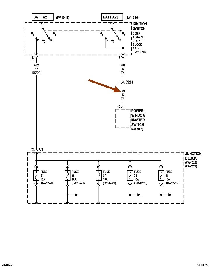

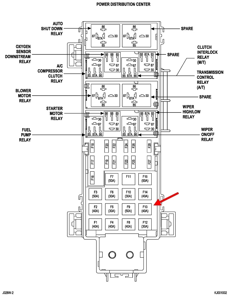

Dandy. We're at the brown arrow in the third diagram, and there's 0 volts there. The easiest place to get to as we work our way back toward the fuse is at the connector for the ignition switch. That connector is shown in the fourth drawing. There's no specific instructions on how to get to the connector other than to remove the lower steering column cover.
The connector is shown looking at the terminal end with the wires coming out on the back side. Look for the blue and tan wires. They'll be right next to each other. Back-probe those with the test light. There should be 12 volts on the blue wire all the time, and there should be 12 volts on the tan wire only when the ignition switch is in the "run" or the "accessory" positions.
If there's 12 volts on the blue wire but never on the tan wire, the switch is suspect along with those terminals are likely overheated / discolored, and that part of the connector body is melted. Let me know what you find, then we'll figure out where to go next.
