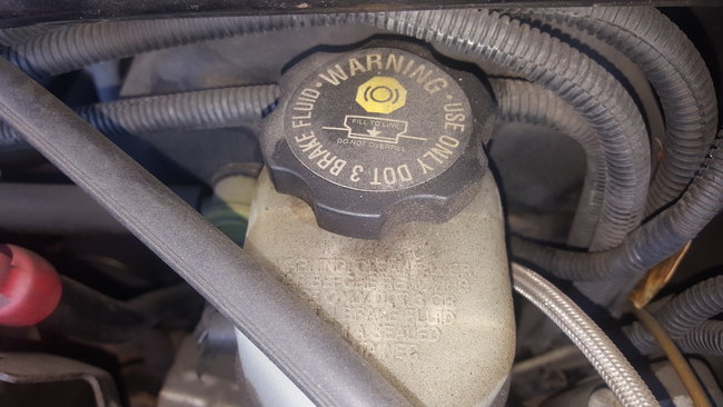

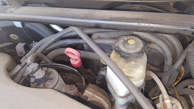

I have some pictures of my engine bay. I see the brake fluid reservoir, where is the power steering wheel reservoir. I see a red dipstick to the left of the brake fluid reservoir. Is this it?
Nov 26, 2019 at 9:28 AM
Good afternoon,
That is the transmission dipstick. The power steering in down at the bottom of the motor back by the firewall.
They actually paid someone to design it there. They never thought of us putting it in that location.
Nov 26, 2019 at 12:46 PM

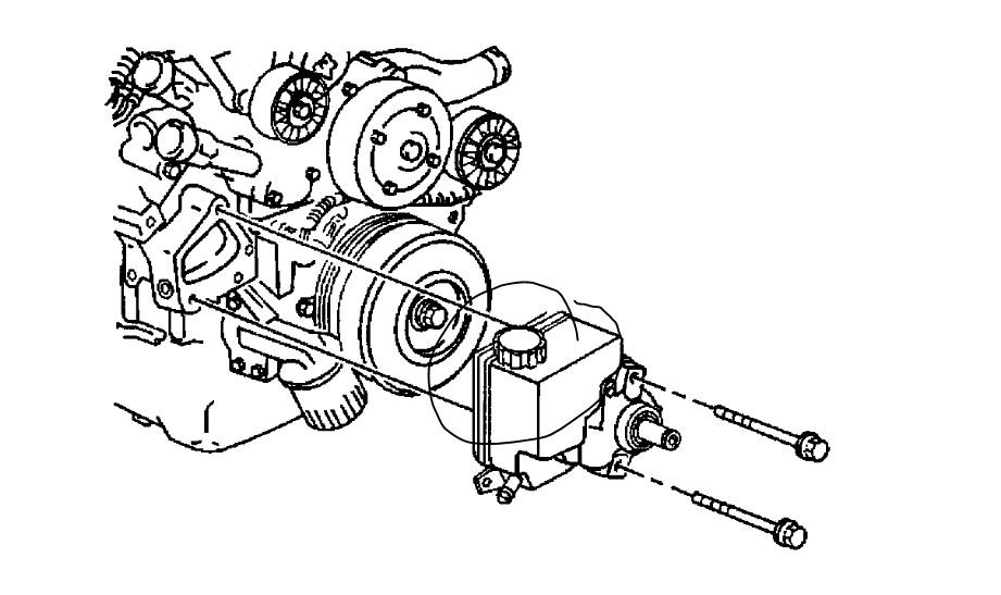

I found the reservoir as I see a cap sort of say that looks like the one from the coolant and oil and windshield washer reservoirs. But, I can't see the levels of how much to fill it up to.
Nov 26, 2019 at 4:26 PM
There should be a stick on it when you remove the cap to tell you the level. There will be a fill mark on the stick.
Nov 26, 2019 at 4:31 PM
