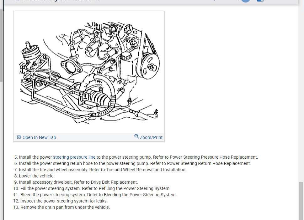

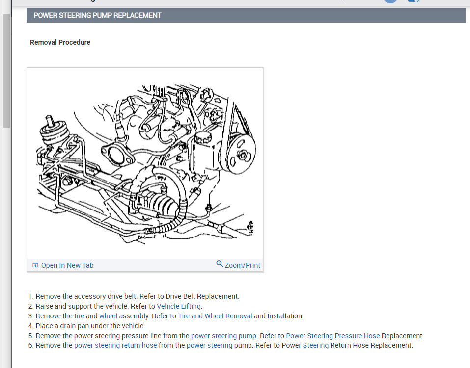

I cannot locate the port or opening to check the power steering fluid. It is not where the manual states. I can see (barely) the pump on the engine, but nowhere to check or add power steering fluid. Can you help? Thanks d mitch
Mar 27, 2009 at 4:22 PM
Here is a guide that will help with adding fluid. Clearly this is a different vehicle but the idea is the same and this has good info that you will need when doing it.
https://youtu.be/BGTIo5MhNIk

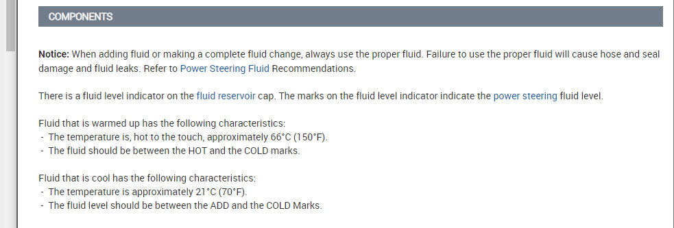

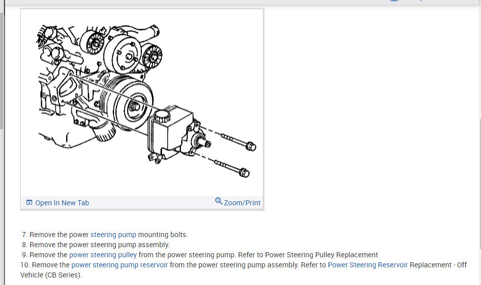

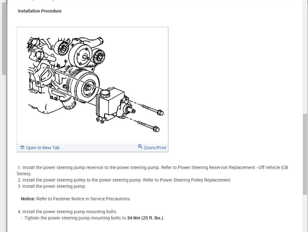

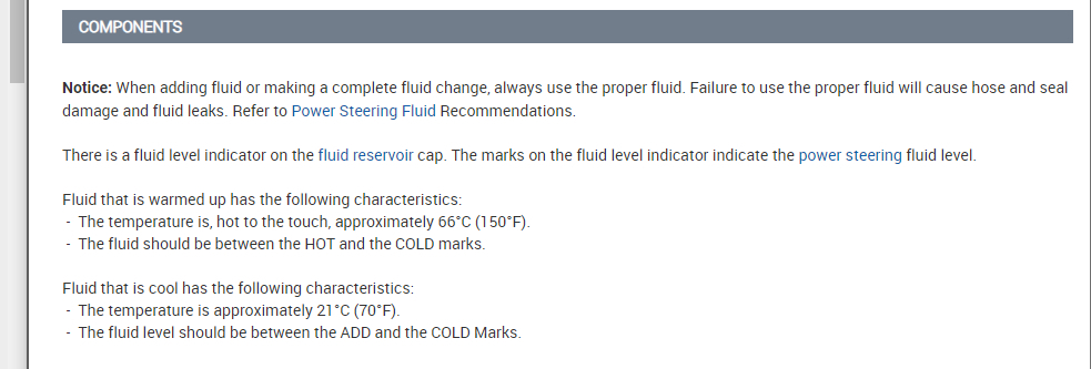

Also, below is the process from the manual on how to add fluid and the process to replace the pump. This is attached because the reservoir is behind the pump.
Please run through this info and let us know if you have other questions. Thanks
