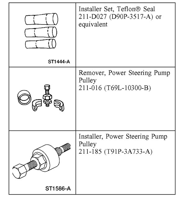

Power Steering Pump-4.6L (2V)
Special Tool(s)
Pic 1

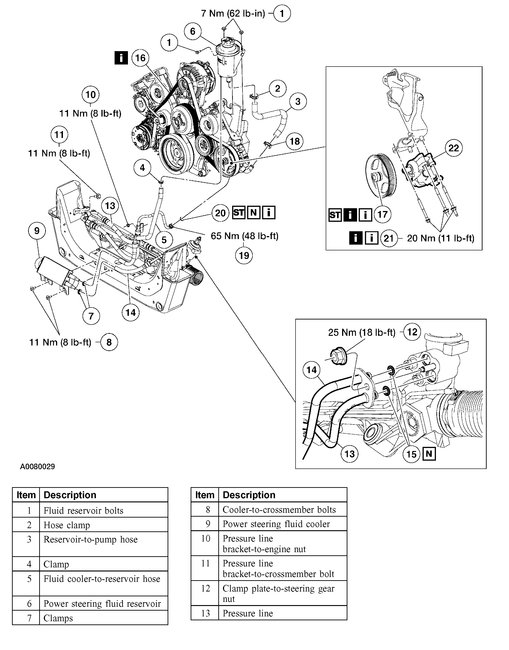

Pic 2
Part 1 Of 2
Pic 3
Part 2 Of 2

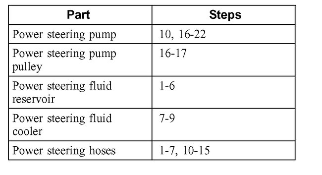

Pic 4

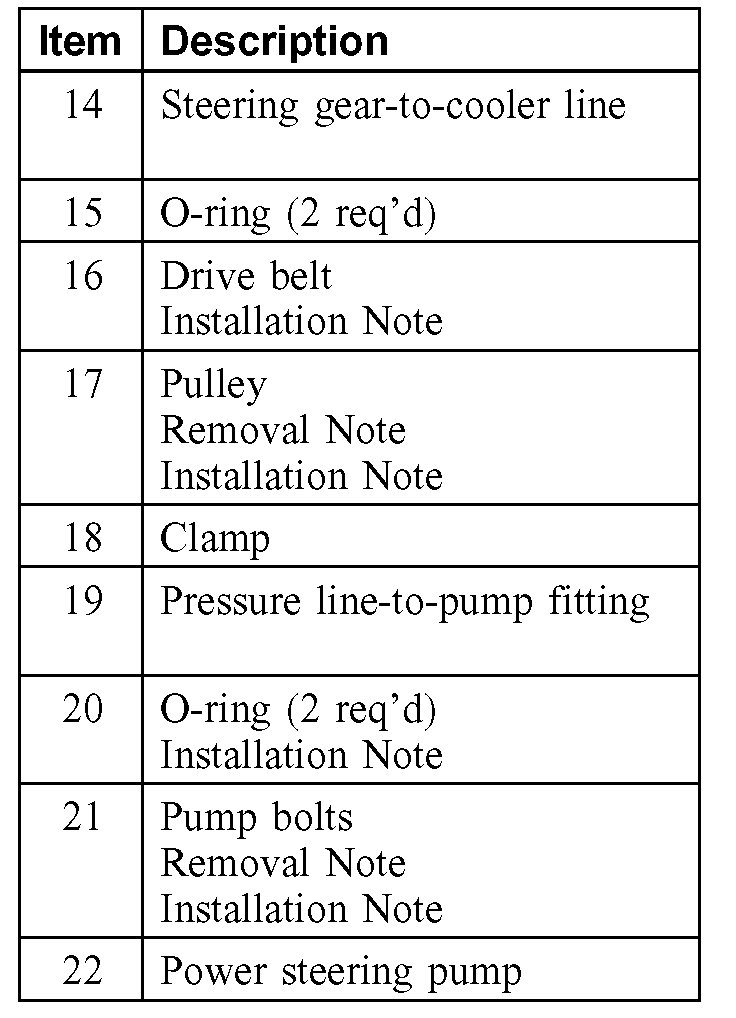

4. Remove the parts in the order indicated in the illustration and table.
To remove individual parts, only carry out the listed steps:
5. To install, reverse the removal procedure.
6. Fill and leak test the system.

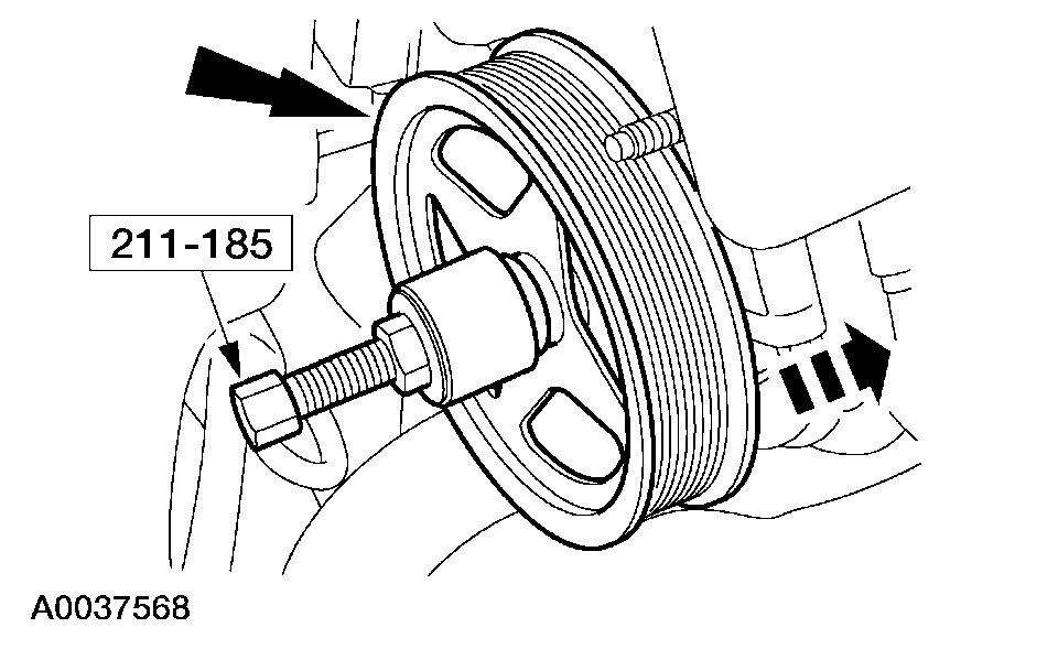

Item 17: Pulley Removal Note
Pic 5
1. Using the special tool, remove the pulley.

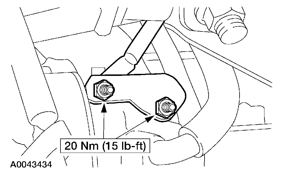

Item 21: Pump Bolts Removal Note
Pic 6
1. Remove the nuts and position the bracket and cable aside.
- Remove the pump bolts.

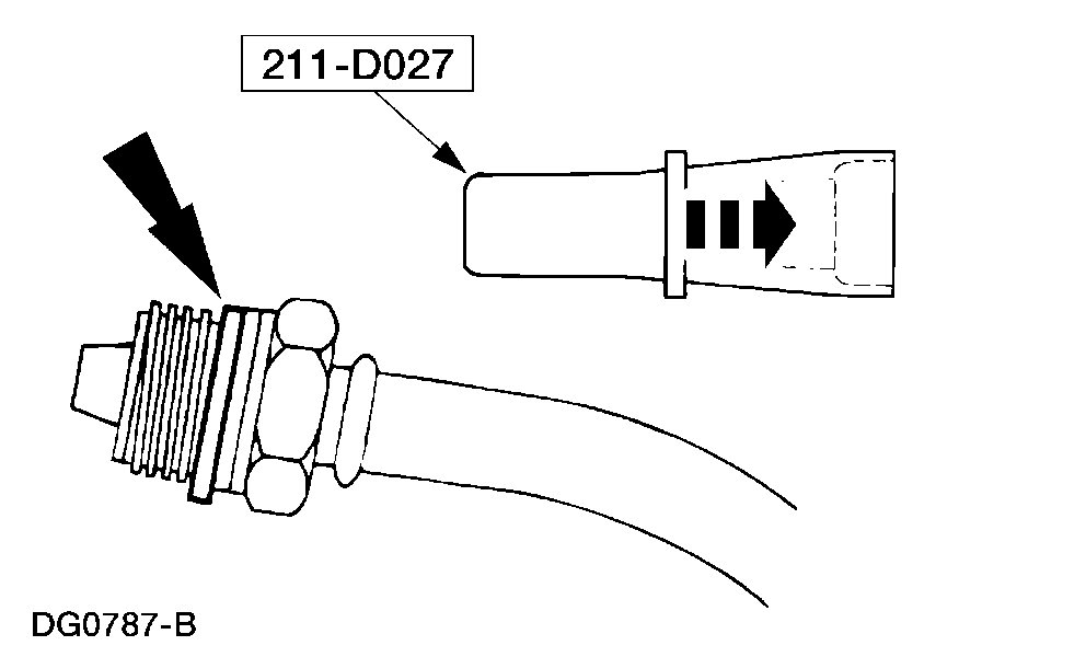

Item 20: O-ring Installation Note
Pic 7
1. Using the special tool, install a new Teflon seal on the pressure line fitting.

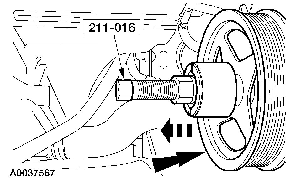

Item 17: Pulley Installation Note
Pic 8
1. Using the special tool, install the pulley.
