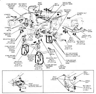

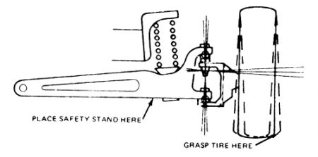

My 1995 ford explorer makes a fast rattling sound when turning at low speeds, usually when pulling into a parking spot. This is an intermittent problem, happening approximately 50% of the time. When it does happen I can turn the wheel to either side and hear the sound. When I press the accelerator and rev the engine the sound goes away completely. The steering system works normally otherwise, it's just an annoying sound.
Dec 27, 2009 at 3:34 AM
MATHIASO
  • 1,209 POSTS
Hello tx5ab1b You will need to raise the car and check for a loose suspension component. It looks like the stabilizer bar link is broken.
https://images.2carpros.com/forum/automotive_pictures/46384_stabilizer_1.jpg
Next check wheel bearing and ball joints
https://images.2carpros.com/forum/automotive_pictures/46384_0996b43f802119d9_1.jpg
