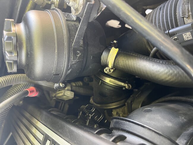

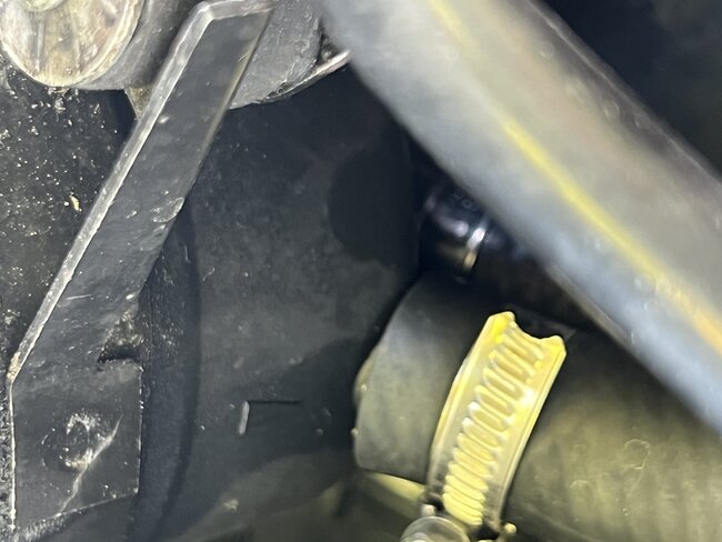

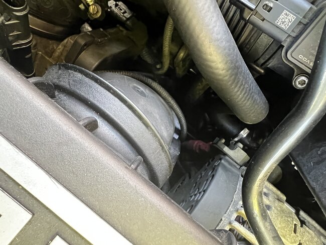

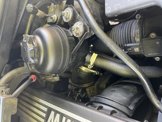

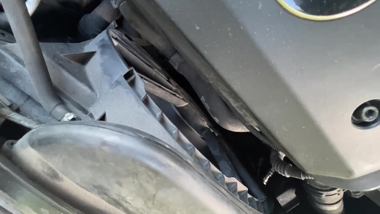

Here is picture of reservoir and hoses/clamps. All new.
Apr 15, 2023 at 2:31 AM

I do hear it. If the fluid is full and there is no air in the system, suspect a worn pump. If it still provides normal assist, you can continue driving it that way. Otherwise, the pump will likely need to be replaced.

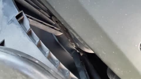

Attaching video of A/C loud sound.

Anything is possible. If you remove the serpentine belt, start the engine and see if the sound is gone. If it is, then spin the belt-driven accessories by hand to see if anything feels tight or is rough when turning.
I did hear the noise in the second video. That is a traditional power steering pump noise. Also, I listened to the first video you sent and the noise in that video was only when turning. Is that still the same?
