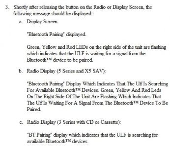

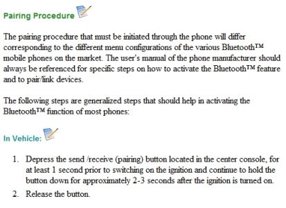

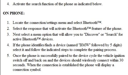

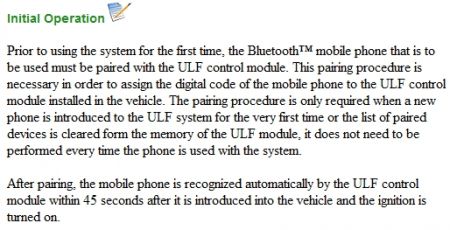

How do I set up my telecommunications system? I have the little button on my steering wheel, as well as the trunk.

Are you talking about setting up the bluetooth feature of your BMW?

I am guessing. Yes. I press the little telephone button on my steering but it doesn't do anything.
