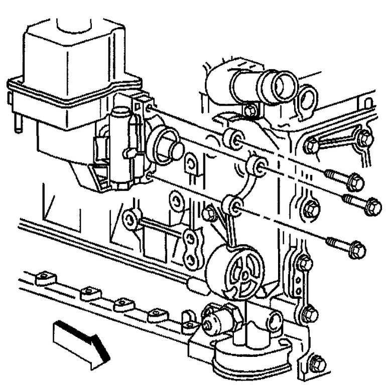

Started having power steering issues, my pump never made any noises, my rack and pinion was leaking so I replaced it hoping to fix the problem but it didn't. The power steering works if I give it gas when turning, when pressure is higher, almost seems like a clog. I took my lines off the cooler and blew air through it, its not clogged. I also bypassed the cooler and connected the two lines together, still didn't work. What else could be the problem? could my pump be going bad and not giving enough pressure, or could the rubber part of my lines be collapsing inside and kinking internally?

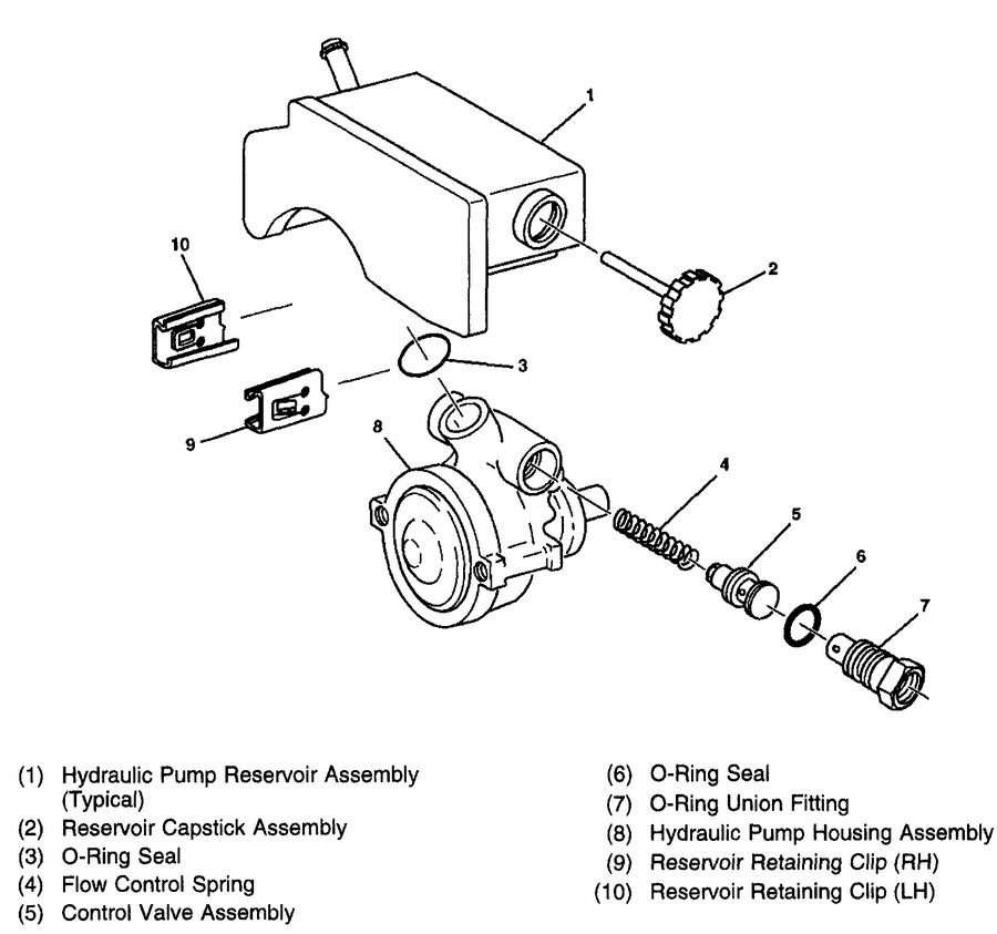

Good morning and thank you for visiting 2CarPros.
There is no rule that says that a power steering pump needs to make noise when it fails. I have personally seen pumps that fail to produce enough pressure to function properly without the whining noise most people are used to hearing.
It could be that your pump is doing the same, putting out lower than normal pressure which makes you have to rev up the engine to get enough pressure to move the piston in the steering rack. I am also making an assumption here that the serpentine belt is in good shape and not squealing since you said there weren't any noises!
From what it sounds like to me and taking into consideration that you already replaced the rack and checked the lines for clogs it is my suspicion that the pump itself is failing. A replacement pump will cost about $40.00 to $150.00 depending if you buy an aftermarket or re-manufactured brand or a genuine AC Delco brand.

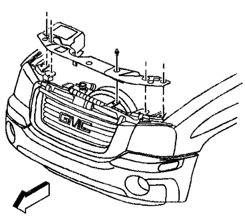

1. Remove the radiator intake baffle (see diagrams).
2. Remove the air cleaner housing assembly.
3. Remove the serpentine belt.
4. Place a pan under the power steering pump to catch the fluid when you open up the system.

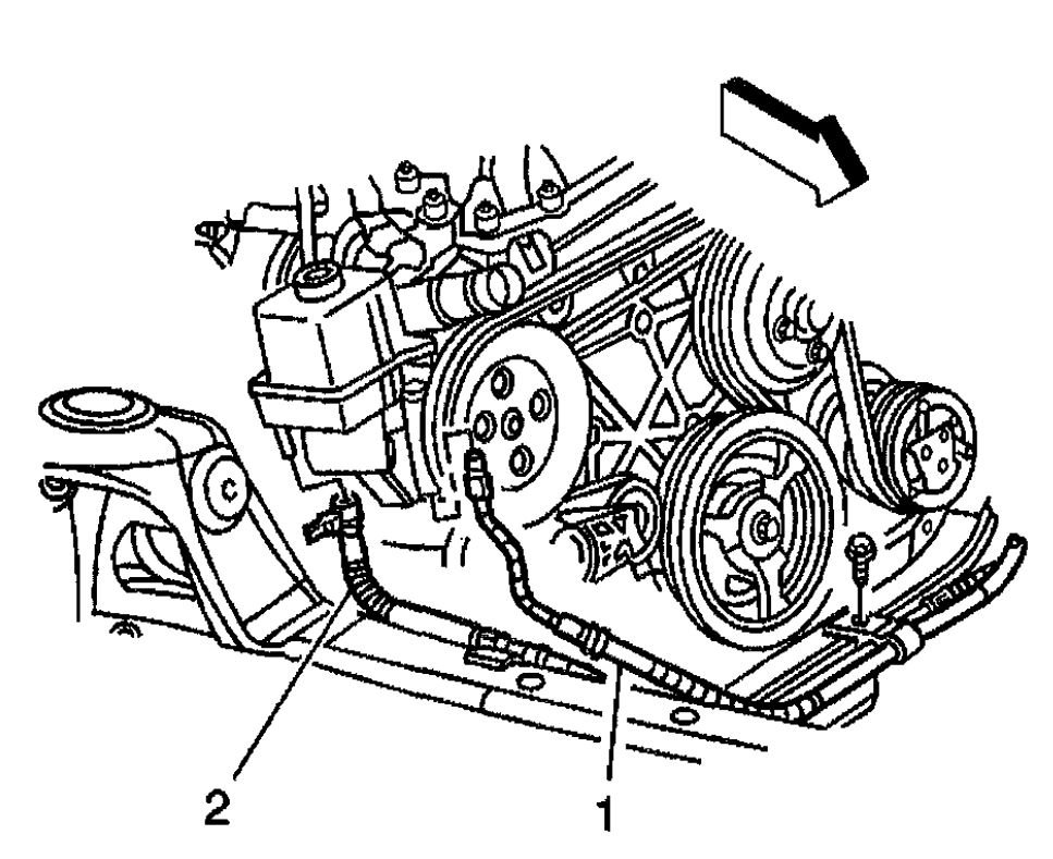

5. Disconnect the high pressure hose.
6. Disconnect the hose coming from the oil cooler.
7. Un-clip the wire harness from the loom located on the pump housing.
8. Remove the mounting bolts from the power steering pump
9. Remove the pump.

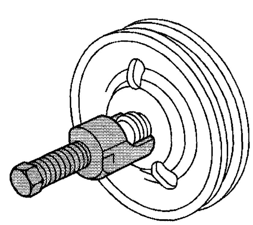

10. Remove the Pulley from the old pump. (you will need special tools for the pulley, J 25033-C power steering pump pulley installer, and a J 25034-C pulley remover.)
Assemble in the reverse order.

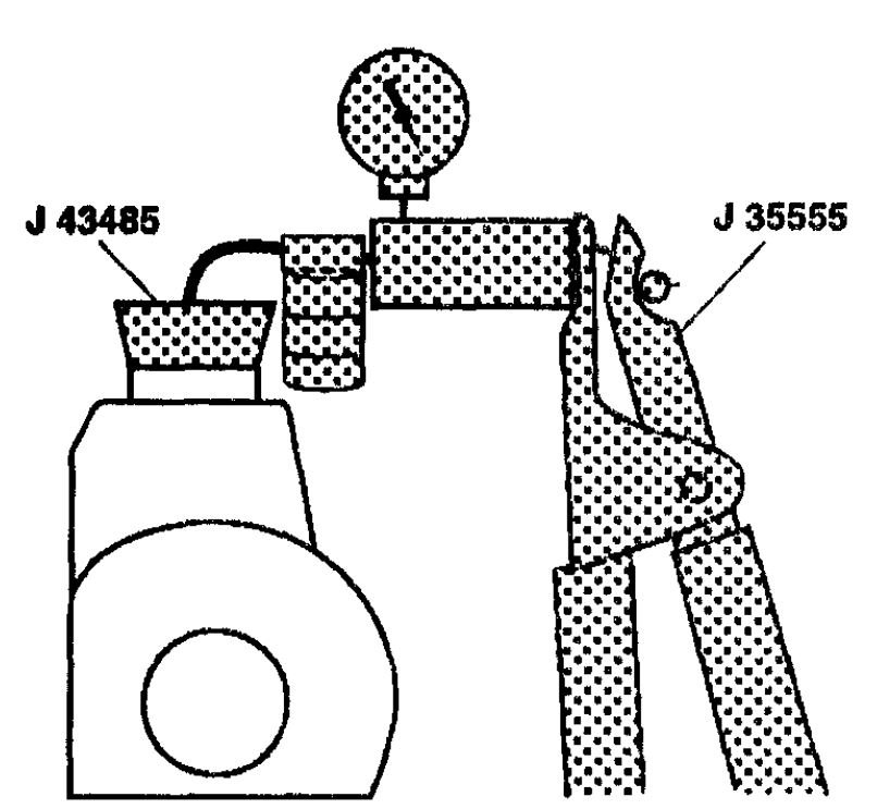

After completion, bleed the system. This is a very important step as any trapped air can cause cavitation and could damage your pump over time.
To bleed the system you will need a vacuum pump and an adapter to attach the pump the to power steering fluid reservoir filler neck.
1. Remove the filler cap.
2. Fill the pump reservoir to the "Full Cold" level.
3. Attach the vacuum pump to the reservoir (see attached picture)
4. Apply a vacuum to the reservoir (about 20 in-hg)
5. Wait five minutes (check vacuum level - a loss of 1-2 in hg is normal)
6. Remove the vacuum pump.
7. Reinstall the cap
8. Start the engine and allow to idle for a few minutes
9. Shut off the engine
10. Check the fluid level. add fluid as needed and repeat steps 8-10 until fluid level is stable.
