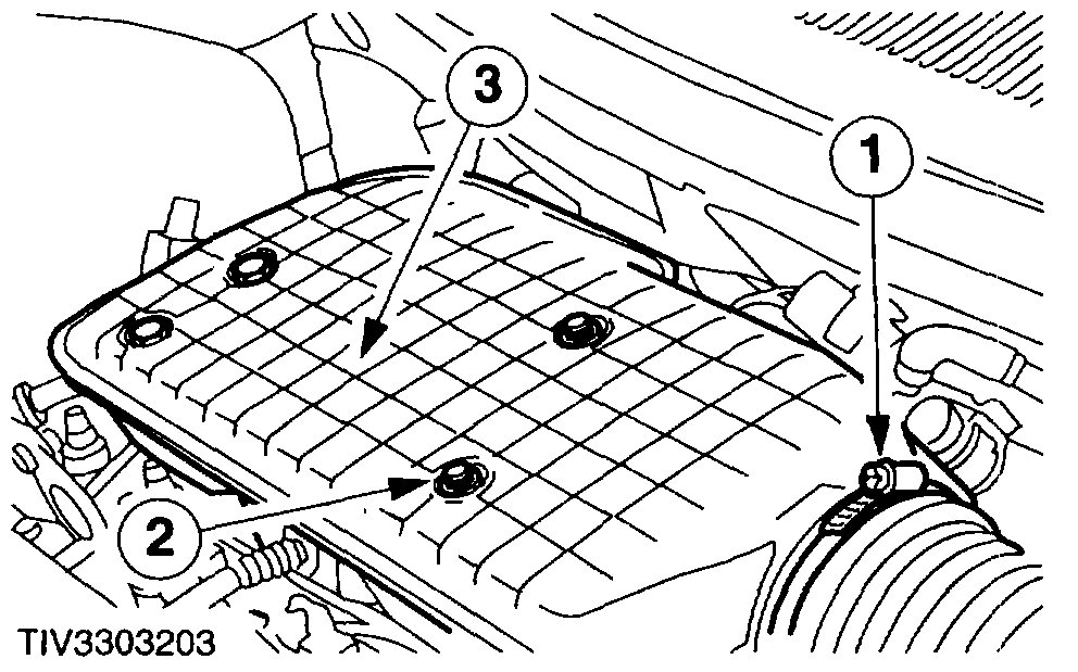

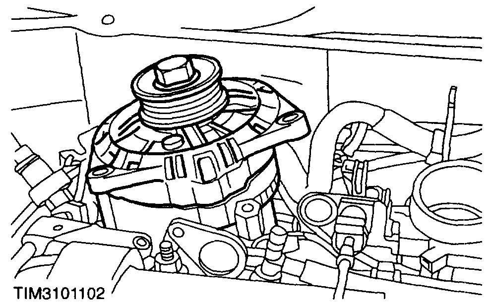

2. Remove the intake air resonator.
1 Disconnect the air cleaner outlet tube.
2 Remove the bolts and nuts.
3 Remove the resonator.
- Disconnect the vacuum pipe underneath.
pic 2

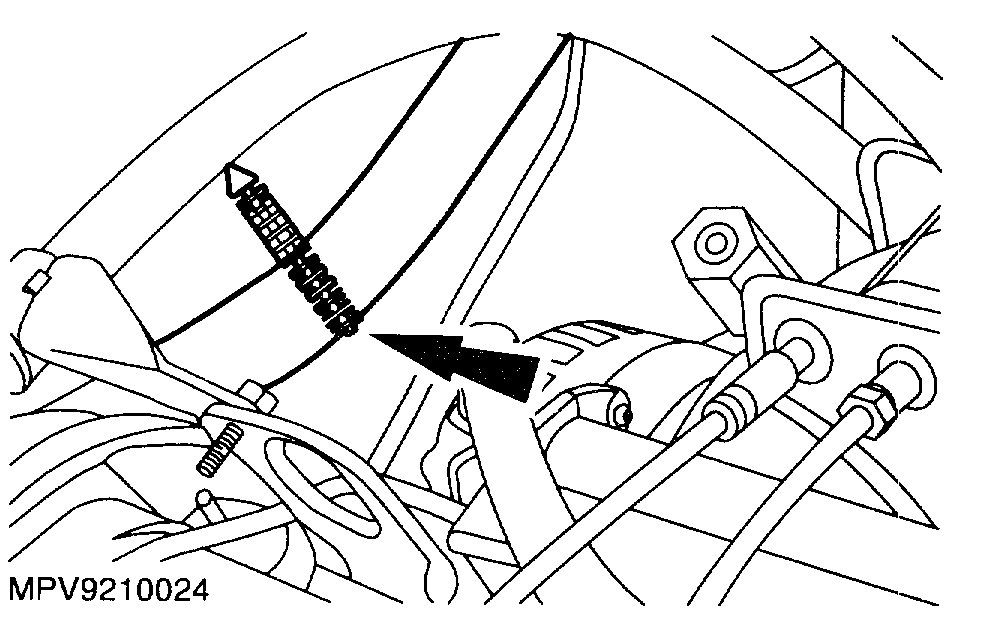

3. Detach the coolant hose from the retaining clip.
pic 3

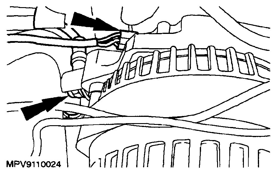

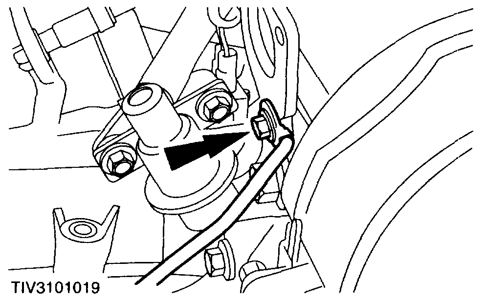

4. Disconnect the generator electrical connectors.
pic 4

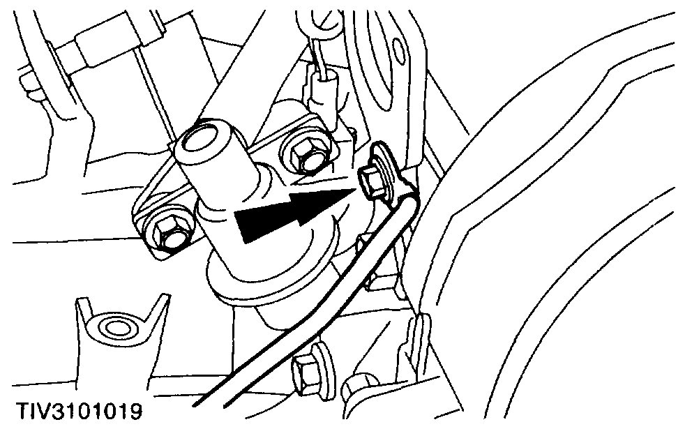

5. Disconnect the ground cable.

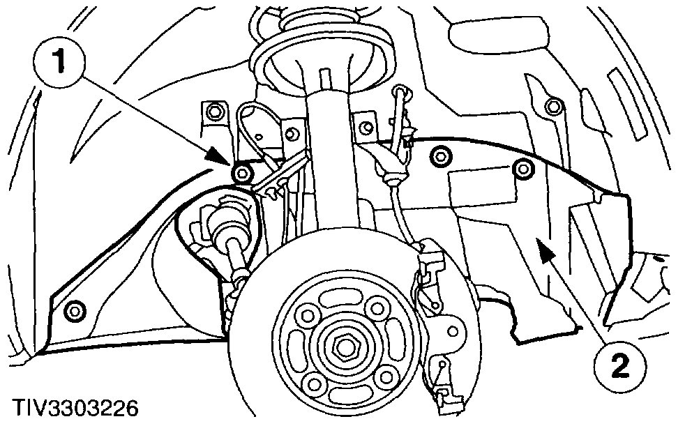

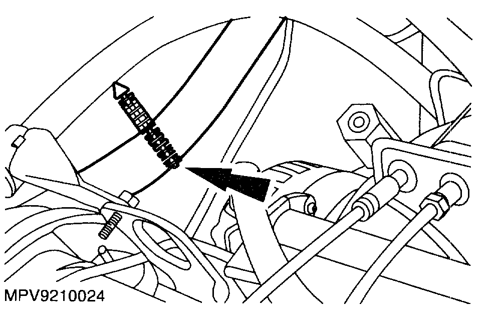

7. Remove the right front wheel.
pic 5
8. Remove the splash shields.
1 Remove the bolts.
2 Remove the splash shields.

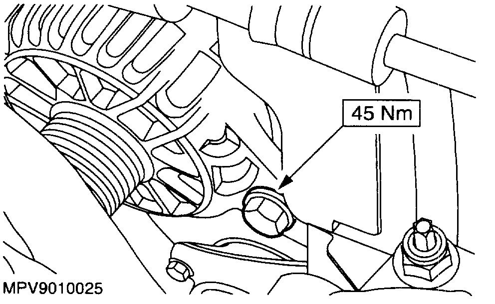

10. Remove the generator lower bolt.

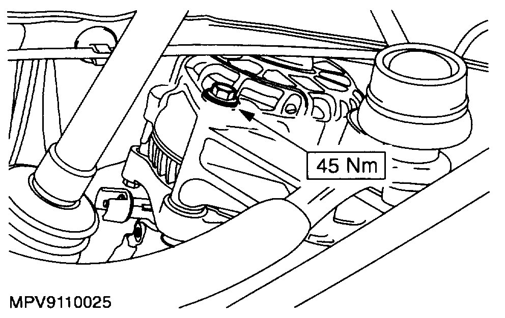

12. Remove the generator upper bolt.
pic 8

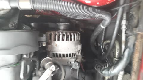

I'm not sure if I'm missing a step or my car is different. I removed the air intake, the alternator is right under it, somewhat. I removed the belt and the upper bolt, which was easy to take out. When I got the lower bolt loosened it only came out half way. The tire wall is blocking it from coming out. I need to raise or lower the engine to do that but not sure how. I can't seem to find anything I need online for completing that task.

Is there a black bracket mounted to the lower part of the alternator?

Well apparently the housing for the bolt is a half moon. The other half is on the alternator and the bolt holds them together. I didn't realize that until it came out. I didn't have to raise or lower the engine. I'm sure I will be back. Have you heard of anyone using CLR to clean out the heater core. I can make that another question if you need me to.
