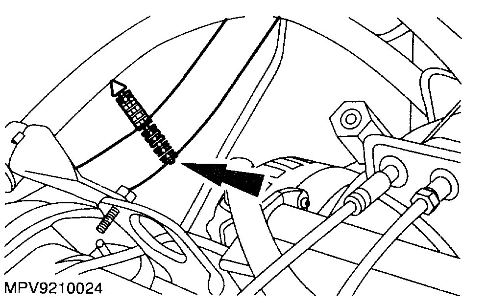

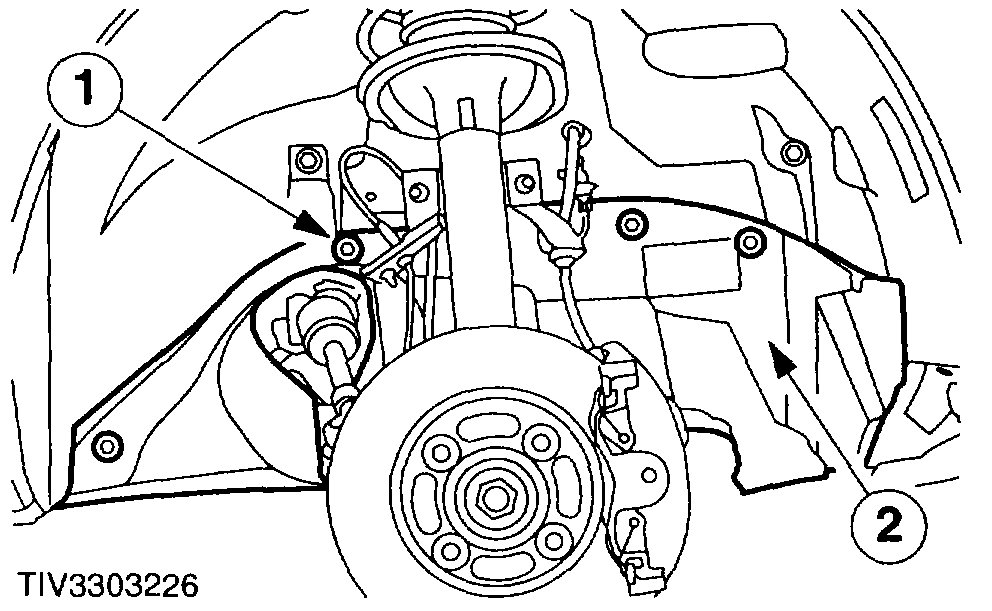

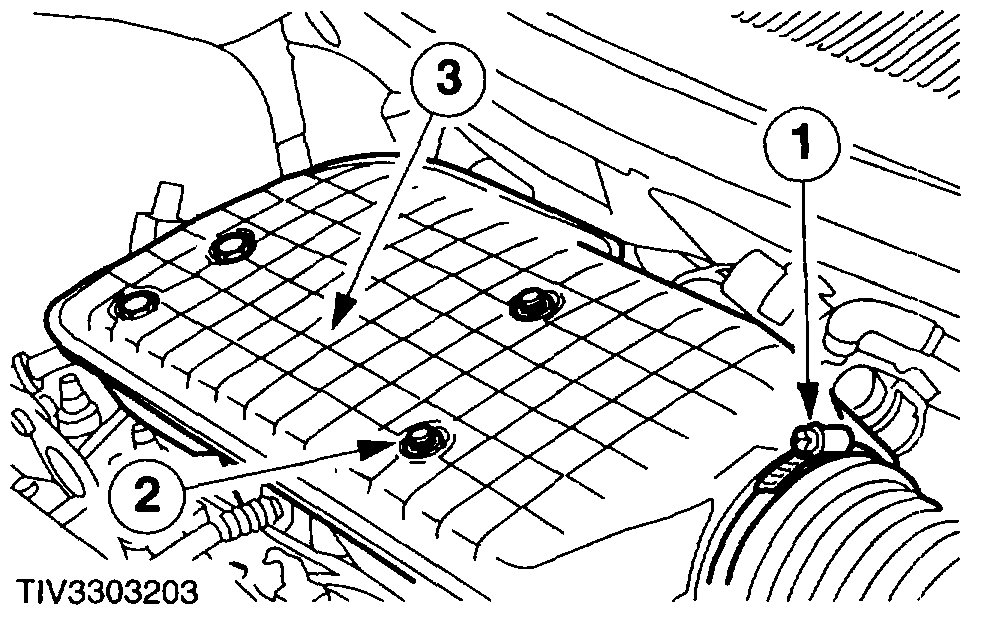

Here are the directions specific to your vehicle for alternator replacement. The worst part of this job is you have to do part of it through the inner fender which requires you to remove the one wheel. Bit all in all, it's not that bad.
______________________________________________
1999 Mercury Cougar L4-122 2.0L DOHC VIN 3 SFI
Procedures
Vehicle Starting and Charging Charging System Alternator Service and Repair Procedures
PROCEDURES
REMOVAL
1. Disconnect the battery ground cable.
pic 1

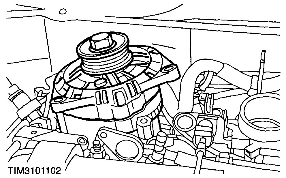

2. Remove the intake air resonator.
1 Disconnect the air cleaner outlet tube.
2 Remove the bolts and nuts.
3 Remove the resonator.
- Disconnect the vacuum pipe underneath.
pic 2

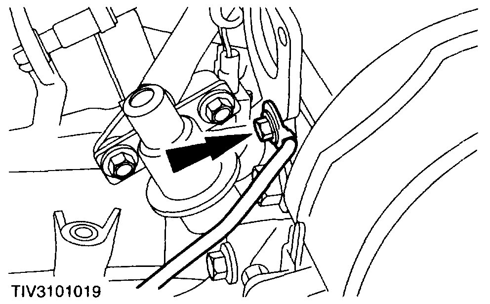

3. Detach the coolant hose from the retaining clip.
pic 3

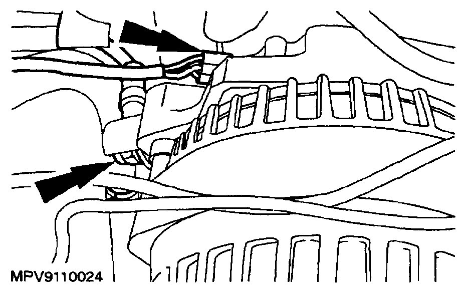

4. Disconnect the generator electrical connectors.
pic 4
5. Disconnect the ground cable.
6. Raise and support the vehicle.
7. Remove the right front wheel.
pic 5
8. Remove the splash shields.
1 Remove the bolts.
2 Remove the splash shields.
9. Remove the accessory drive belt.
pic 6

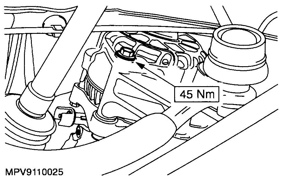

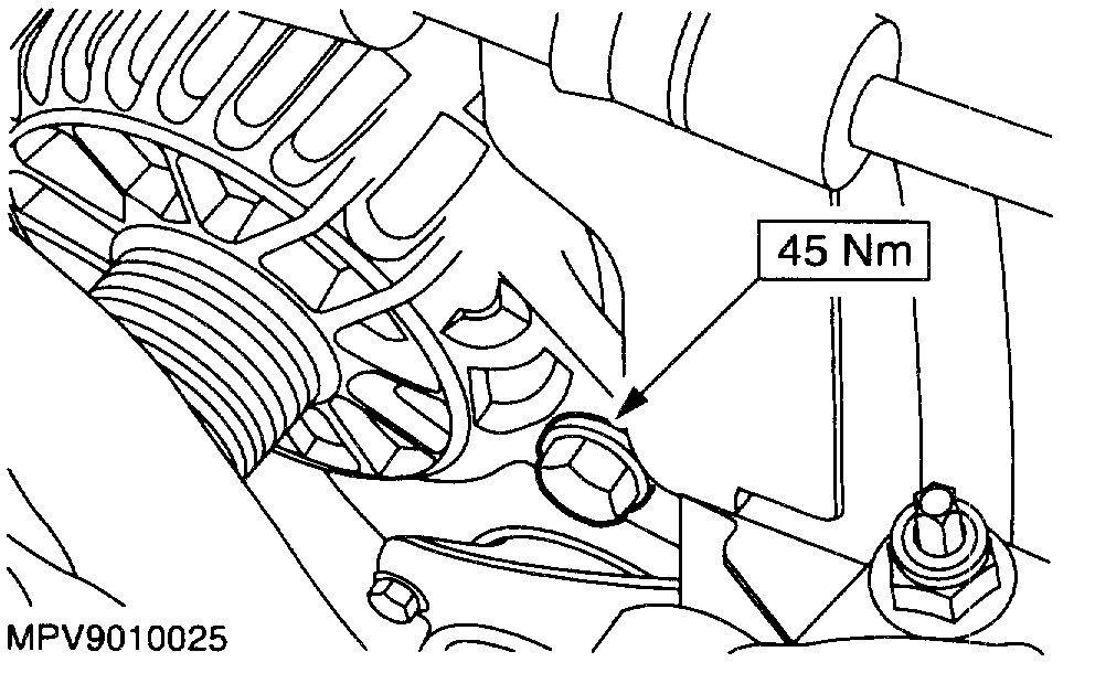

10. Remove the generator lower bolt.
11. Lower the vehicle.
pic 7
12. Remove the generator upper bolt.
pic 8
13. Remove the generator.
CAUTION: There is a very limited amount of space in which to remove the generator. Do not overstress or damage any hoses or cables.
pic 9
pic 10
INSTALLATION
1. To install, reverse the removal procedure.
Let me know of this helps. If you have trouble, I can help.

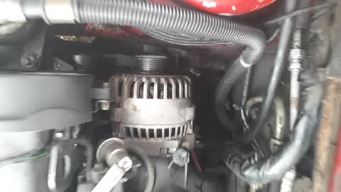

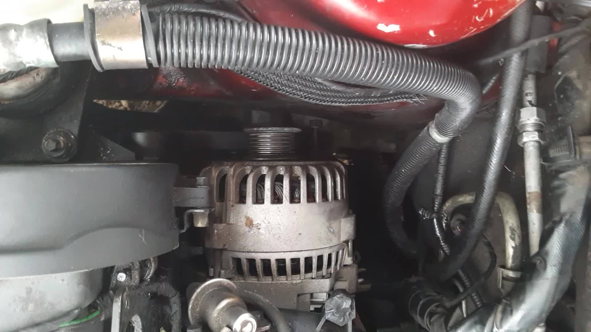

I'm not sure if I'm missing a step or my car is different. I removed the air intake, the alternator is right under it, somewhat. I removed the belt and the upper bolt, which was easy to take out. When I got the lower bolt loosened it only came out half way. The tire wall is blocking it from coming out. I need to raise or lower the engine to do that but not sure how. I can't seem to find anything I need online for completing that task.
Jan 18, 2020 at 12:11 PM
  • CERTIFIED EXPERT
  • 110,175 POSTS
Is there a black bracket mounted to the lower part of the alternator?
Jan 18, 2020 at 5:11 PM
DCOATES35
  • 45 POSTS
I'm not sure but I will check in the morning, I was going to jack the motor up and try it that way. I will check before I do any thing else.
Jan 18, 2020 at 5:24 PM
  • CERTIFIED EXPERT
  • 110,175 POSTS
Let me know. If there is, you may need to remove it. The mount can be seen from under the vehicle. Nothing is ever easy. LOL If you lift the engine, make sure you place the jack in a spot that won't damage anything. I've seen people lift the engine by the oil pan and it wasn't a good thing. LOL
Please let me know if I can help.
Jan 18, 2020 at 5:42 PM
DCOATES35
  • 45 POSTS
Okay, I'm glad you mentioned that. I was looking at areas to use to lift it.
Jan 19, 2020 at 3:00 AM
  • CERTIFIED EXPERT
  • 110,175 POSTS
Not a problem. Also, keep in mind that it is still mounted on the car, so it will only go so far before it starts lifting the vehicle. Please be careful.
Jan 19, 2020 at 1:17 PM
DCOATES35
  • 45 POSTS
Thank you, I was able to change it out. The problem with the voltage dropping is no more. I guess it was caused by the alternator the whole time.
Jan 19, 2020 at 6:24 PM
  • CERTIFIED EXPERT
  • 110,175 POSTS
You are very welcome. What enabled you to get that bolt out from the alternator? Also, I'm glad it's fixed and working right for you.
Take care and feel free to come back any time you have questions.
Jan 19, 2020 at 8:17 PM
DCOATES35
  • 45 POSTS
Well apparently the housing for the bolt is a half moon. The other half is on the alternator and the bolt holds them together. I didn't realize that until it came out. I didn't have to raise or lower the engine. I'm sure I will be back. Have you heard of anyone using CLR to clean out the heater core. I can make that another question if you need me to.
Jan 20, 2020 at 12:11 PM
