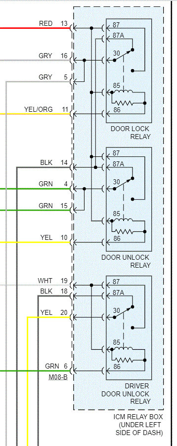

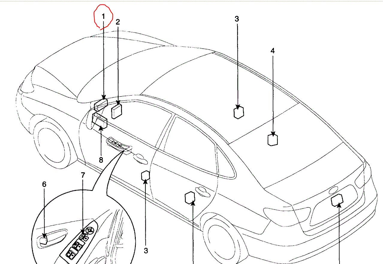

If the actuator, switch, and relay is new, then we need to go to the body control module. Can you tell me if the locks work properly from a different switch in the car? Do they work with the fob?

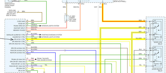

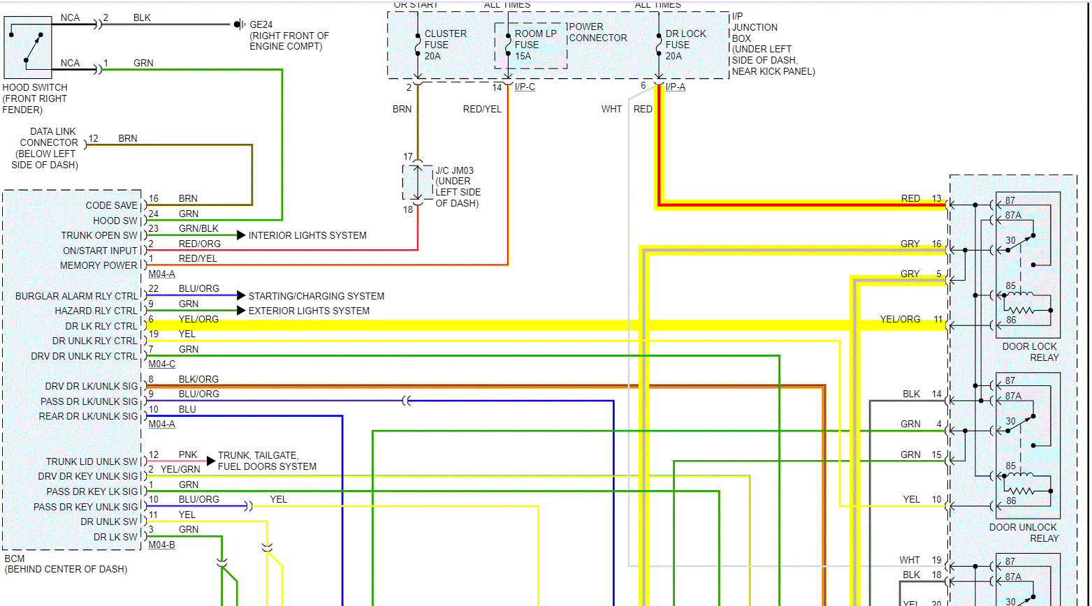

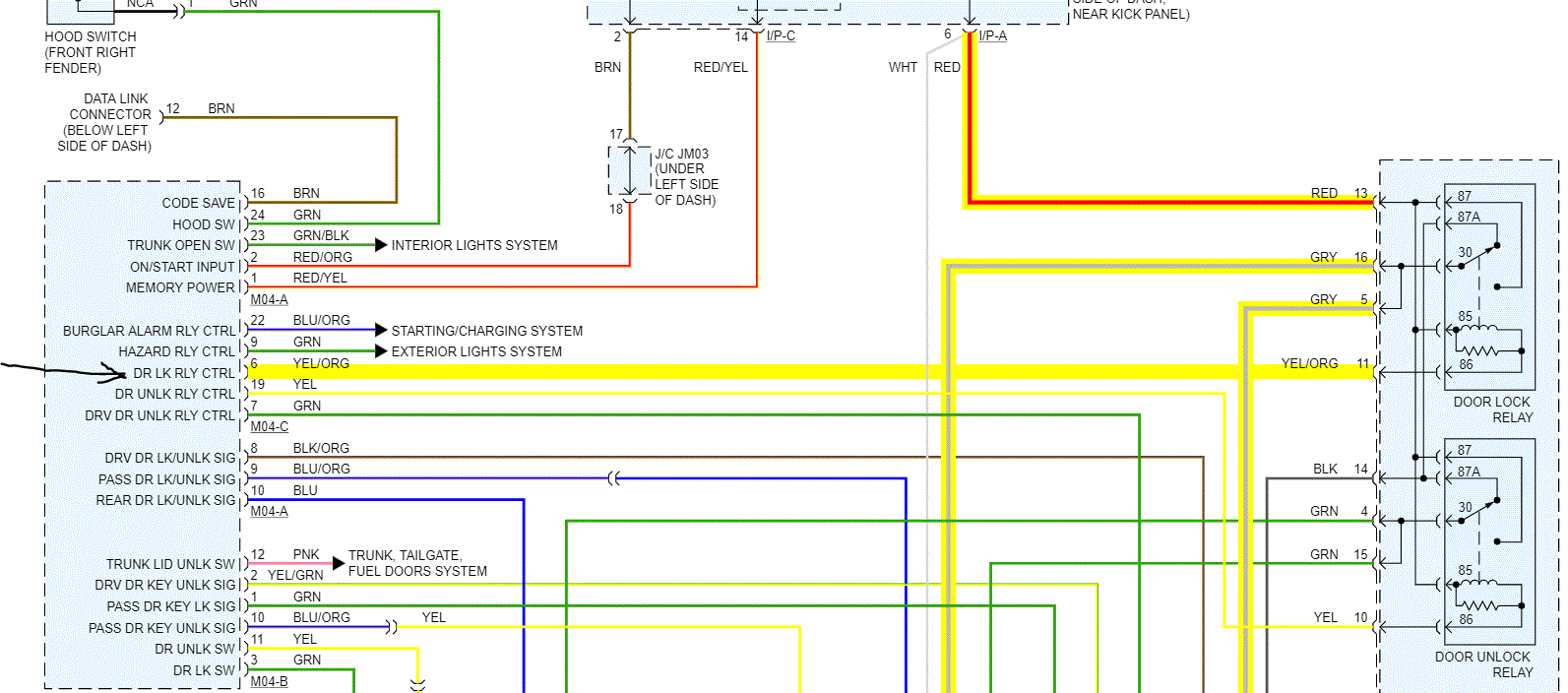

If you look at pic 1, it shows the lock relays. I just want to confirm you got the correct one. Next, pic 2 shows power to the relay from the fuse. Confirm there is power to the lock relay.
Next, if there if there is power, then you need to check the body control module for a signal. See pic 3. You will need a helper when checking to actuate the lock button.

As far as testing for power to the relay, first, confirm the fuse is good and has power both in and out.
If there is, then remove the relay and check for power from the red wire in (I believe it's pin 13). You can use a test light for that.
The body control module can be difficult to work on simply due to a lack of room. If you plan to unplug the connectors to it, make sure the car battery is disconnected first. Also, when you plug it back in, the battery should also be disconnected.

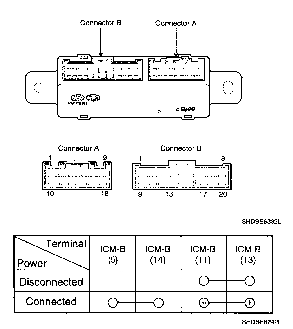

You should be able to get one just about anywhere. Here are directions for testing the circuit. Also, the pics attached correlate with the directions. The last thing at the bottom of the post I will add is link that explains how to test a relay.
_______________________________
2008 Hyundai Elantra L4-2.0L
Component Tests and General Diagnostics
Vehicle Body and Frame Relays and Modules - Body and Frame Power Door Lock Relay Testing and Inspection Component Tests and General Diagnostics
COMPONENT TESTS AND GENERAL DIAGNOSTICS
POWER DOOR LOCK RELAY
INSPECTION
DOOR LOCK
1. Disconnect the negative (-) battery terminal.
2. Remove the ICM relay box.
3. Check for continuity between the terminals.
4. There should be continuity between the No. 5 terminal and No. 14 terminals in the ICM-B when power and ground are connected to the No. 11 terminal and No. 13 terminal in the ICM-B.
5. There should be no continuity between the No. 5 terminal and No. 14 terminal in the I/P-D when power is disconnected.
pic 1

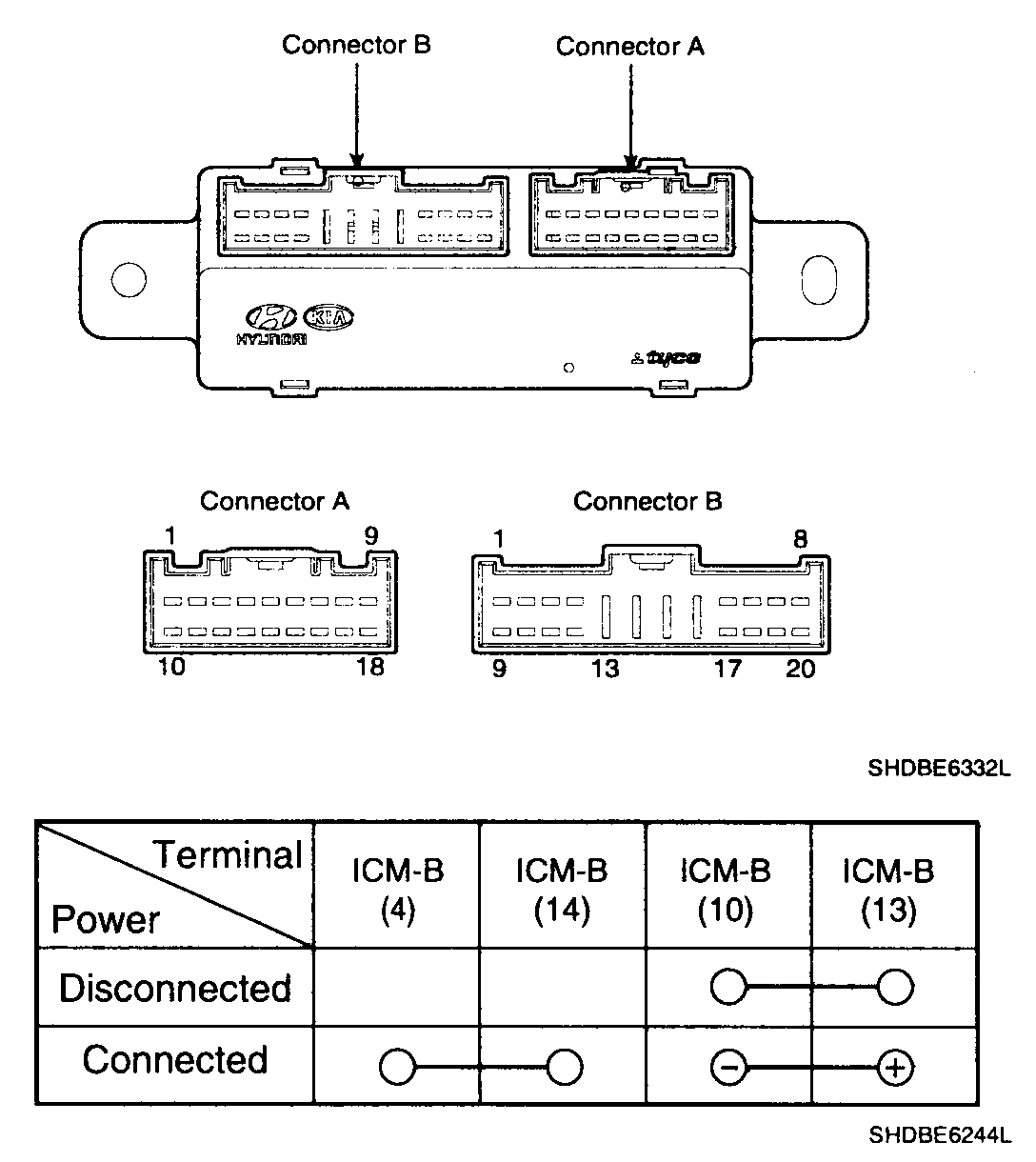

DOOR UNLOCK
4. There should be continuity between the No.4 terminal and No.14 terminal in the ICM-B when power and ground are connected to the No.10 terminal and No.13 terminal in the ICM-B.
5. There should be no continuity between the No.4 terminal and No.14 terminal in the ICM-B when power is disconnected.
pic 2

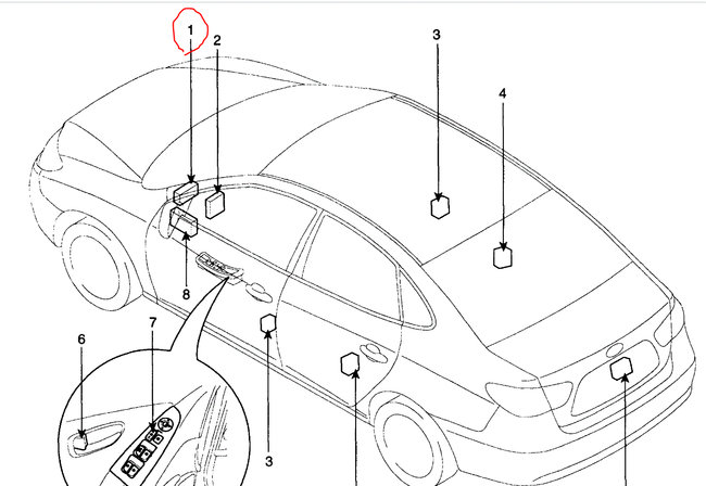

I agree with everything you said. If the new switch was bad, would it do the exact same thing? As far as the ICM relay box, I attached a pic to help you locate it.

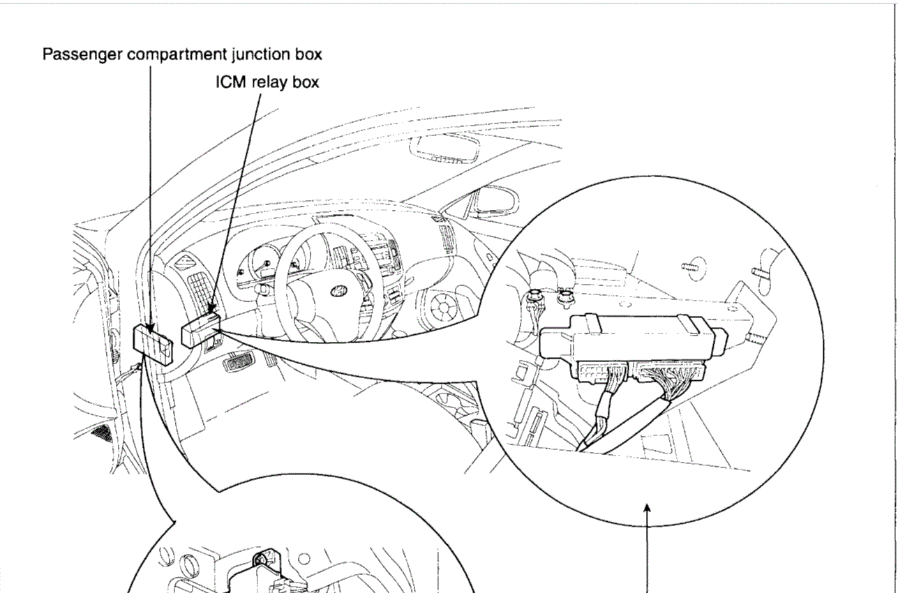

and that ICM is going to have the pronged relay box/plug? sorry, just wrapping my head around things.
Jul 8, 2020 at 2:52 PM
  • 110,241 POSTS
The ICM is an integrated control module. That is replaced as a unit. I believe you are picturing the traditional type relays. This is different.
Jul 8, 2020 at 3:07 PM

So, I am probably getting really annoying. But would clarify that I was looking for a pic that is "live". a color picture of what it looks like in reality. I've been trying to find it online and not seeing anything that specifically says "door lock relay" or something of that nature. But also realized, the pic you provided with Connector A and Connector B...that's the relay right there :) I think your last schematic pic of the boxes as well (with #1 circled) will help. Thank you. I need to go back where I was originally.
Jul 9, 2020 at 4:13 AM
TSHUMP18
  • 28 POSTS
well no, it does make sense, but how do i get to it?
Jul 9, 2020 at 7:35 AM
  • 110,241 POSTS
It's under the dash to the left of the left of the steering column. Take a look at the attached pic. Also, by no means are you being annoying. LOL This is why I'm here.
