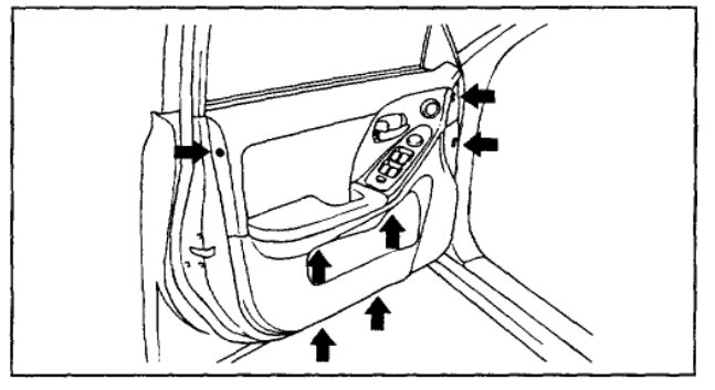

replace door handle cable to latch
2003 HYUNDAI ELANTRA
RRICH8911
Interior problem 4 cyl Two Wheel Drive Automatic

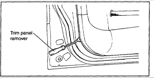

Replacement of cable from door handle to latch. inside driver door handle.
Jan 25, 2009 at 11:30 AM
  • 55,423 POSTS
Hi RICH,

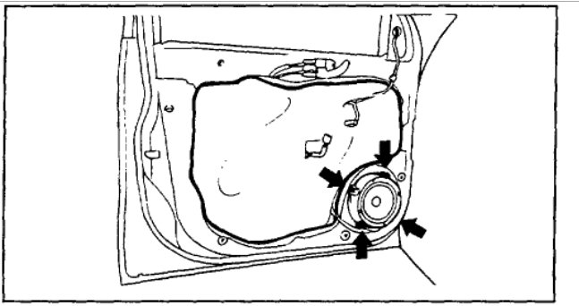

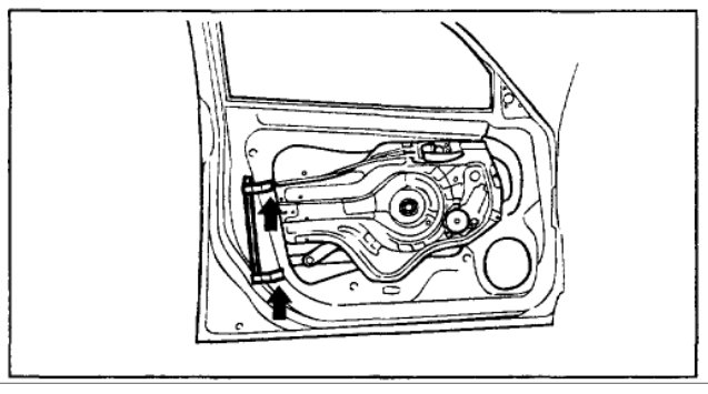

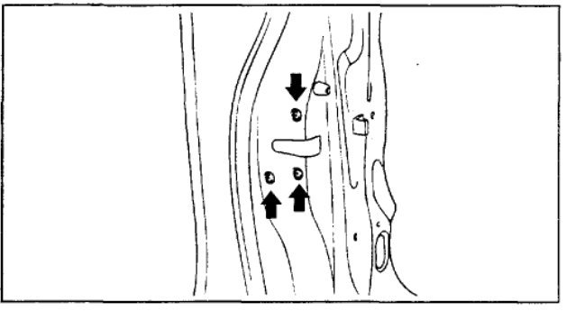

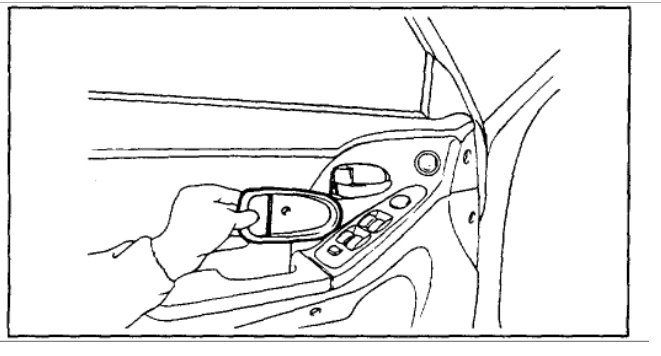

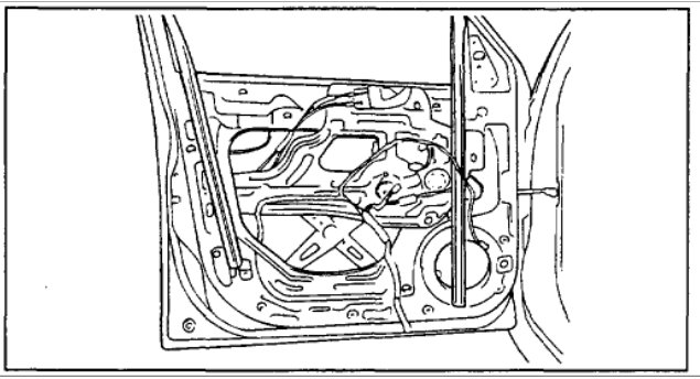

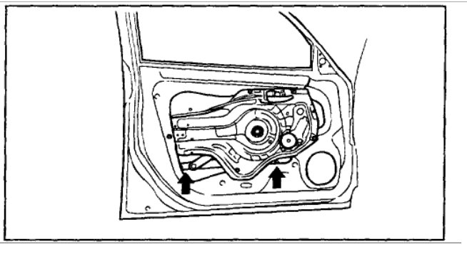

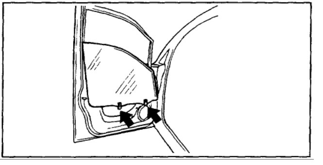

You must start by removing the door panel, here is a guide to help you with that with instrucions in the diagrams below to show you how on your car.
https://www.2carpros.com/articles/door-panel-removal
Then remove the control rods and wires from the latch. Once that is done remove the outer bolts to the latch and it will come out
