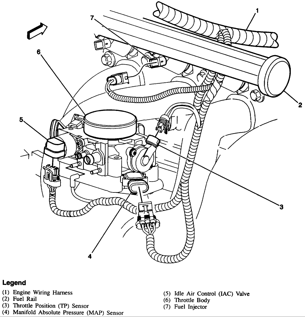

Doing routine maintenance when I decided to clean throttle body. Sprayed carburetor cleaner into throttle body to remove gunk. Now car runs worse than ever. Hesitates and sputters. No codes. What is up?

I have done some research and cant find a MAS. There is an idle control sensor IAC, manifold pressure sensor MAP, and a throttle position sensor TPS. In reality it acts like a vacuum leak, but I do not know.

If you sprayed regular carburetor cleaner into it you may have shot some into the TPS, I have seen that damage the resistor in them. It may have damaged the seal in the IAC as well.

It sounds like that is a good place to start, to replace both the TPS and IAC.
