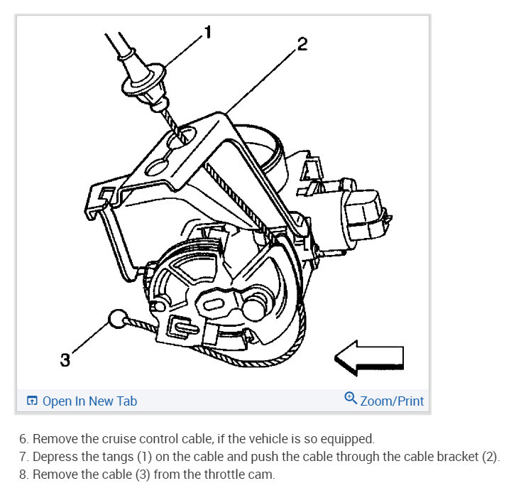

I had my cable break at the throttle. I can see how everything connects to install the new cable. What I can't tell is how to secure the cable at the throttle. I can't find a diagram that shows this. I did get a diagram from the local dealer that shows how the cable runs thru the engine but the connection at the throttle is not shown.

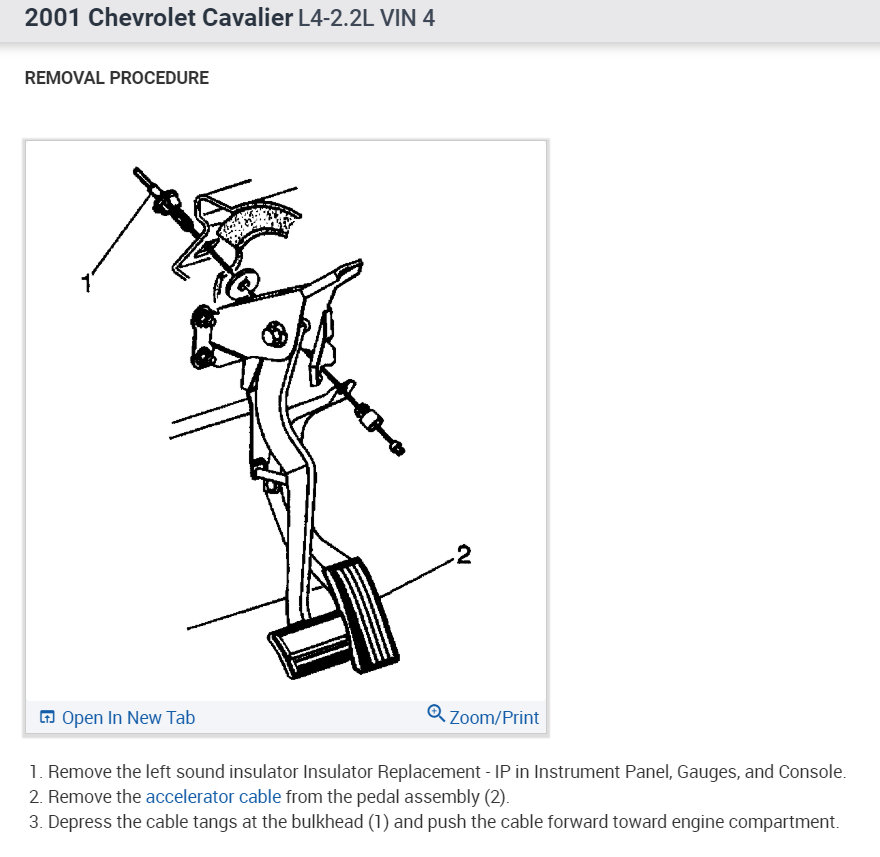

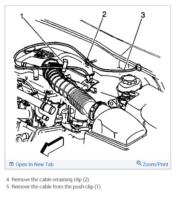

Hello, hope this helps.
7. Release the accelerator control cable lug (3) from the throttle body assembly.
8. Depress the tangs on the accelerator control cable (1) while pulling the accelerator control cable through the accelerator control cable bracket (4).
9. Remove the engine accelerator control cable out of the bracket.
10. Remove the cable from the vehicle
