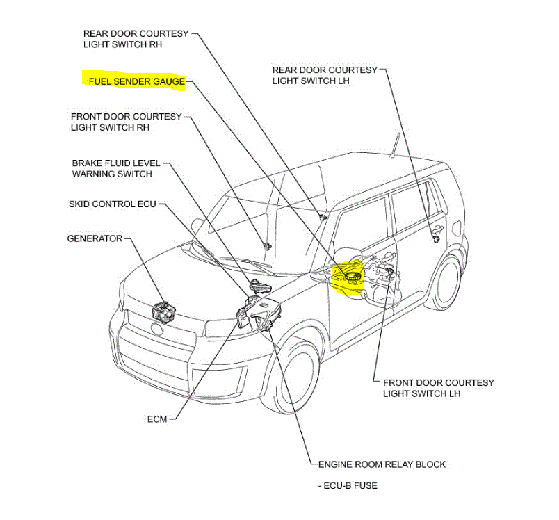

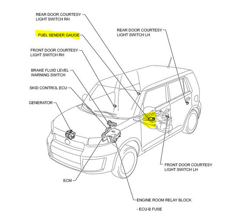

There is only one fuel level sending unit. (See pic below) When you say digital, do you mean there is a digital and an analog fuel level gauge? Let me know.
If that is the case, we need to get our hands on a live data scan tool. I need to know fuel trims, if the oxygen sensors are responding, and if the coolant temperature sensor is working properly.
Let me know. Also, if you haven't changed the air filter in a while, check it. I've even seen mice make nests in the box causing air flow restrictions.

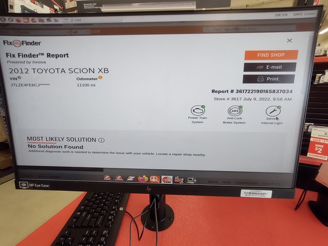

Would an auto parts store have a live data scan tool that they would do those free tests like with a battery check?

Many of them have scan tools to check for codes. I'm not sure if they would have one to provide live data. Try contacting one and see what they say.

Attached is the AutoZone scan showing no issues. It's not a Live Data Scan and suggested I go to a mechanic for that.
