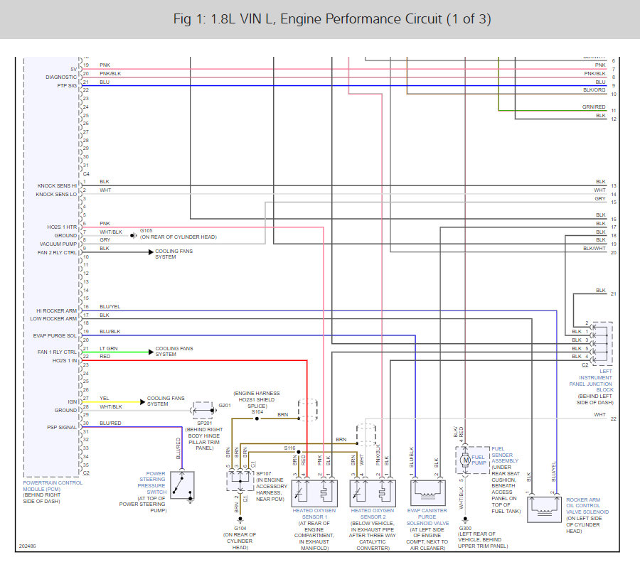

Oxygen sensor Bank 1 sensor 1 heater circuit P0031
2005 PONTIAC VIBE
52,852 MILES • 4 CYL • FWD • AUTOMATIC
MILEAGE MASTER AUTOMOTIVE
Verified all PCM powers and grounds, cleaned and ran all new body, chassis, and pcm grounds, verified operating voltages at 02 sensor and at the PCM under load. Replaced PCM with new dealer unit and reflashed, installed new oxygen sensors, verified all circuit connections, unplugged everything else that shares the heater ciruit wires and through it all we still keep getting code P0031 reoccuring after only one trip and within sixty seconds even though it is supposed to be a two trip fault code. Voltages and fault code occurence is exactly the same with the new computer and oxygen sensors as with the old parts.
Jan 27, 2009 at 12:24 PM
JNOVACK
  • 723 POSTS

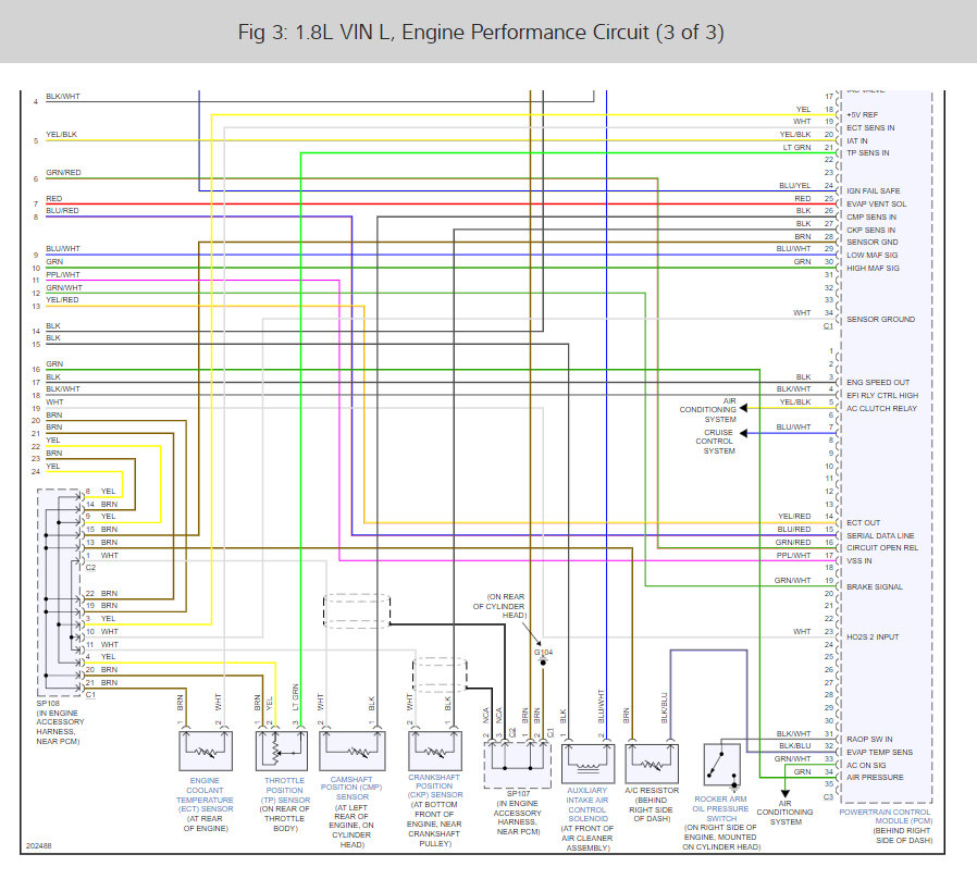

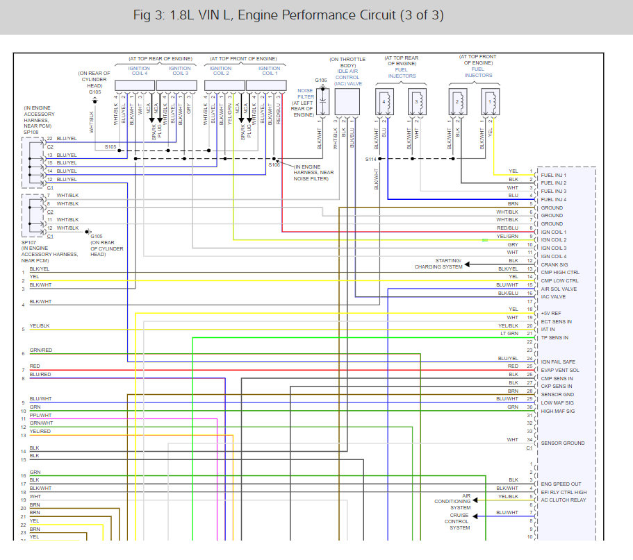

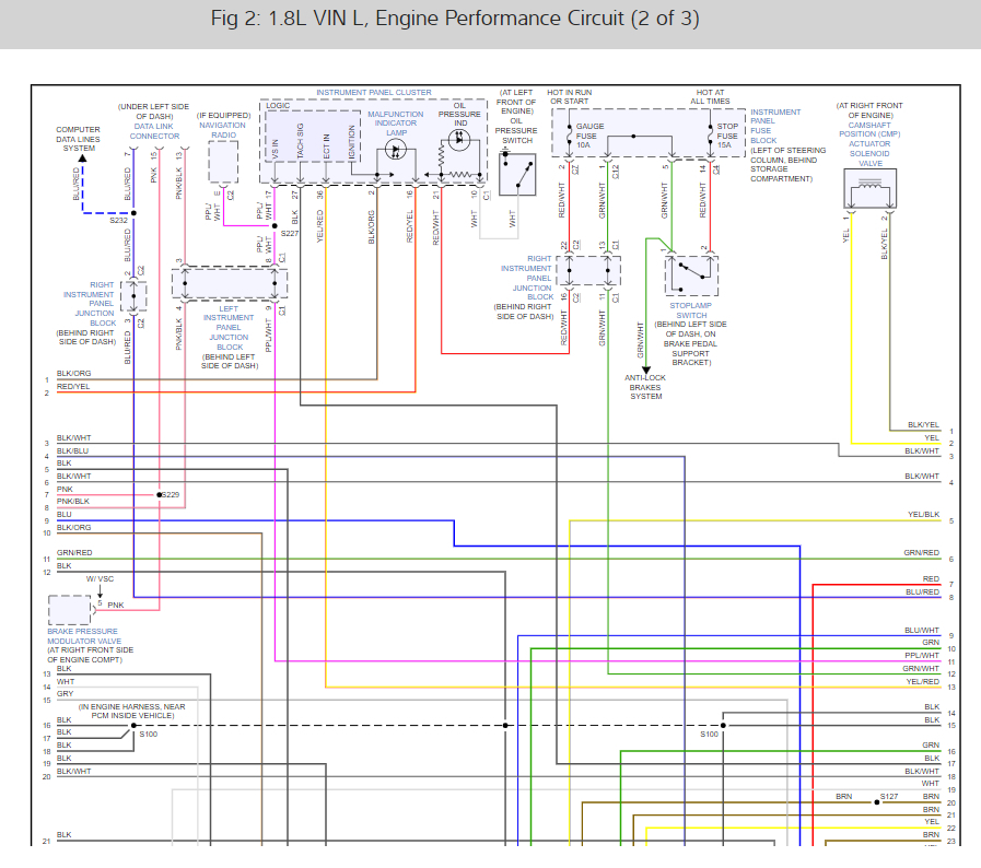

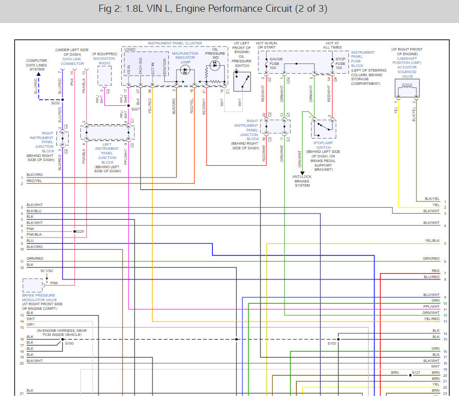

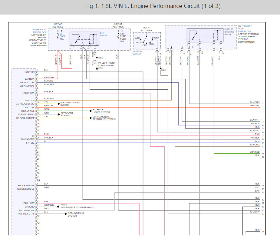

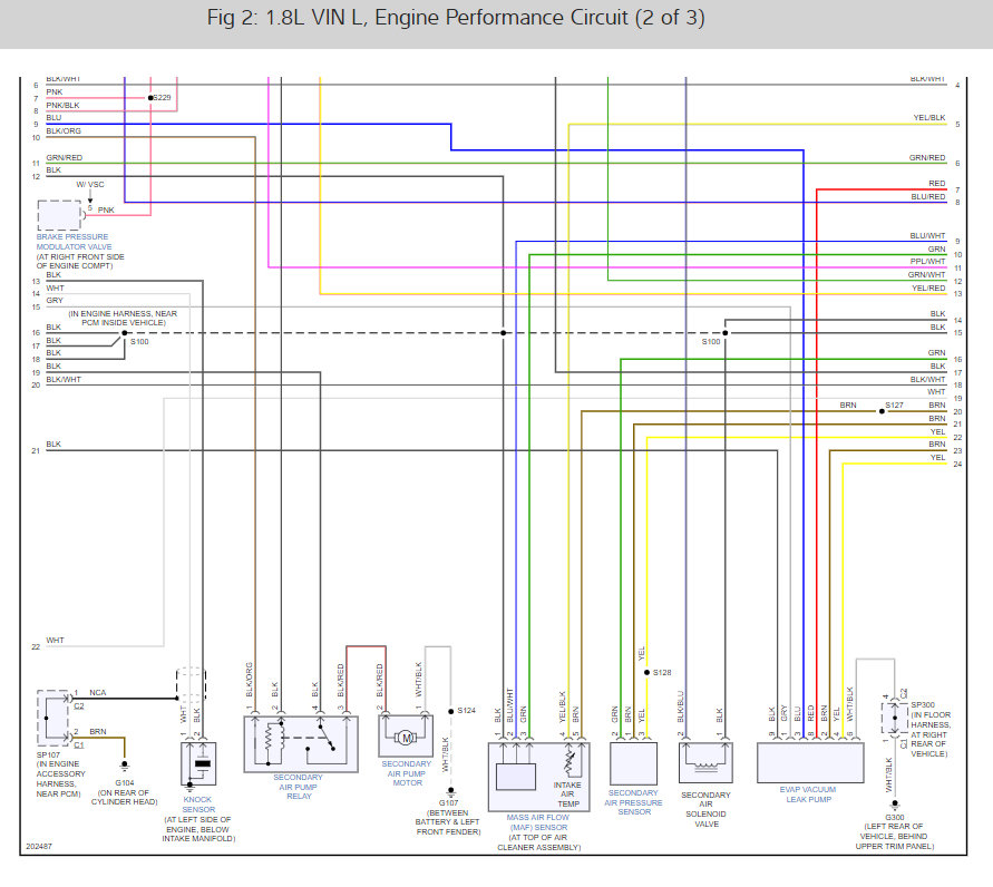

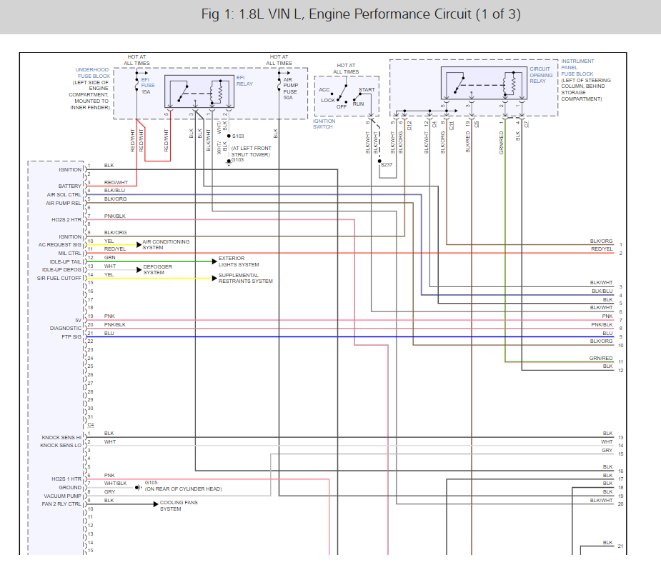

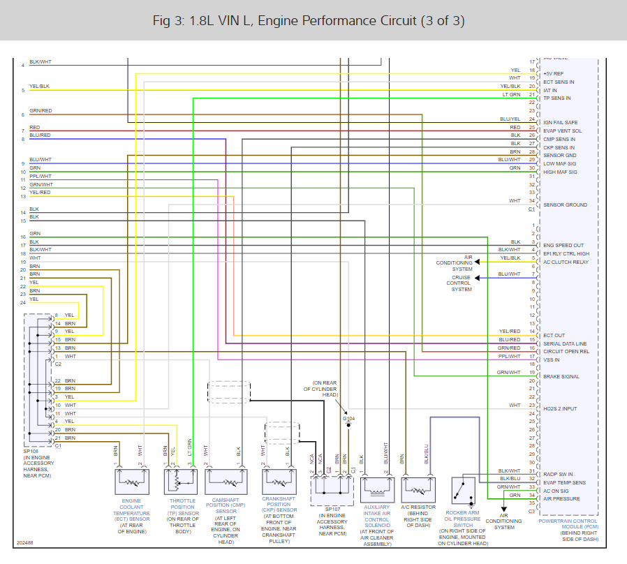

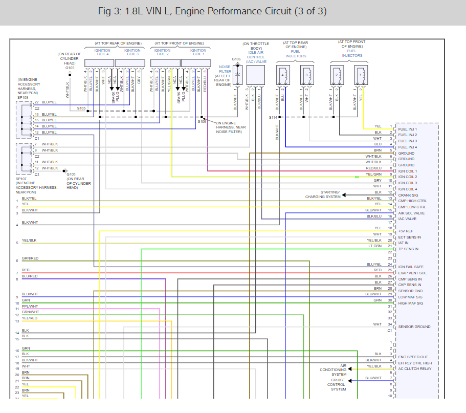

There must be an issue with the wiring. Here is a guide to help check the wiring with engine and sensor wiring diagrams below:
Jan 27, 2009 at 1:13 PM
PCHZLES
Thanks for the guide and wiring diagrams. I checked all connection and found a pin had been pulled from the connector at the sensor, I pushed it back in and it fixed the issue. thanks
