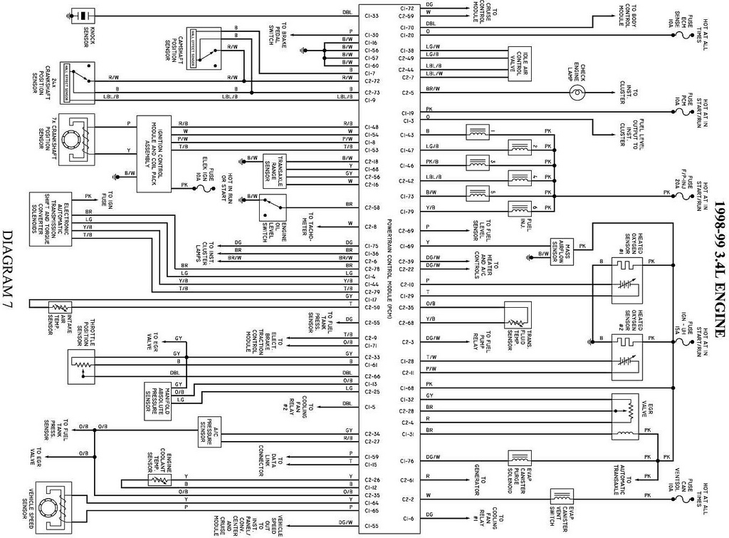

I started checking the Ignition control module just find that the number two cylinder plug is firing a really weak spark but the rest of them fire normally.
My question is. Is this a bad ICM or could this be caused by somthing else?

Okay i tried swapping coils and the problem does not move with the coil it stays on the same cylinder so this rules out a problem with the coils. still is there anyway to know wheater my ignition module is at fault because i dont want to replace it without it being sure it cost's roughly 90$ (alot of dough right now)
I also re did my test to check there is a spark but far weaker then the others, when i unplug the cylinder there is no arc to the coil but when i do it to the others there is. aside from seeing the diference i felt the difrence between the sparks on my arm lol
Could this be caused by the wires coming from the powertrain control module (as i no longer trust connectors on this truck) or would one of those wires being loose just cause it to not work at all

Here is the schematic bigger just click the below link

It could be the module. However because it happened when you were changing the plugs and wires. I would look more into what could have caused it. Maybe the spark plug wire has an internal open. It would help to put a scanner on it to see the misfire graph.

Well I don't think it's the spark plug cables as they are new and also I have been looking for spark at coils not cable ends.
And what machine are you talking about to analyze the for misfires exactly (obd2)? (I have no check engine light) or any light their all off
Oh so the ignition Module is good I got it tested at autozone
I guess im at block one again il try swapping coils again just to make sure.

Yes. You need to hook a scanner up with misfire data capabilities to the obd2 connector. Most accurate would be a tech2 from g.M dealer. This will help you see the counts in a graph to see when miss occurs. The check engine light does not always set if the miss is minor or intermittent.
