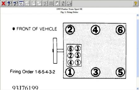

1995 Pontiac Transport Front Wheel Drive Automatic 130k miles
A friend of my husbands changed the spark plugs and wires on our van. Now it runs really bad. Everyone has said that he connected the wires wrong. I need a diagram of the wires and firing order for a 1995 pontiac transport 3.8L engine.

Here you go-Good Luck
https://images.2carpros.com/forum/automotive_pictures/12900_fo_3_2.jpg

Thank you soooo much!
