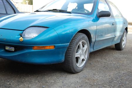

well, I tried the trouble shoot method, the car will not shut off when in drive or neutral, and the car will not start in gear or neutral, only when car in park will she start. I looked at the wires in my steering column (I have tilt) but everything there is clean and there is still quite a bit of give on the length of the wiring harnesses. Someone told be about a blinker or something above the brake pedal on the firewall under the dash but if my hazards work, then it would be functioning properly. hmmmmm, not sure.
https://images.2carpros.com/forum/automotive_pictures/310577_DSC_0545_1.jpg
