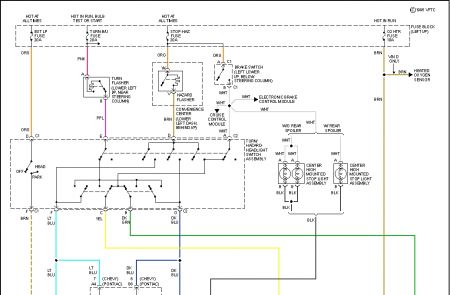

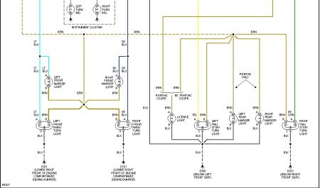

1995 Pontiac sunfire GT. Signals and hazards do not work. We have changed out the signal light switch, bulbs, fuses, flashers, brains, and relay switch. We have also checked the wire for shorts but it is reading fine. Pretty much stuck with a car thats had $1200 put into it, and we cannot move it again because its not road worthy.
(brake lights, headlights, dash lights, and interior lights all work.)
Monday, April 19th, 2010 AT 7:32 PM
BLUELIGHTNIN6
  • 16,542 POSTS
If you have replaced all of that then the only thing left on the signal/hazard circuit is the wiring itself...you will just have to inspect all of the wiring for loose connections, broken wiring or corroded terminals. a wiring diagram of your signal circuit is below to help you out..
