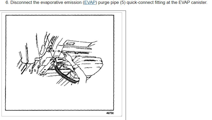

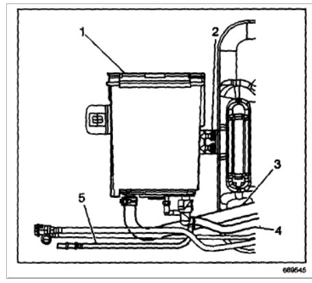

Is there an access panel for the fuel pump under the carpet in my van?
Mar 30, 2009 at 10:24 AM
JAMES W.
  • 2,394 POSTS

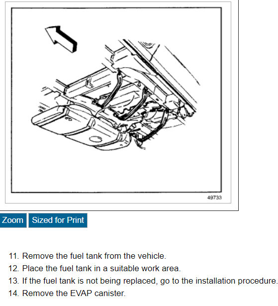

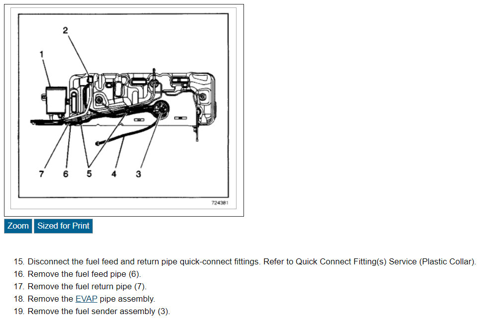

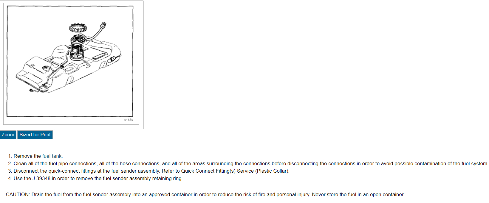

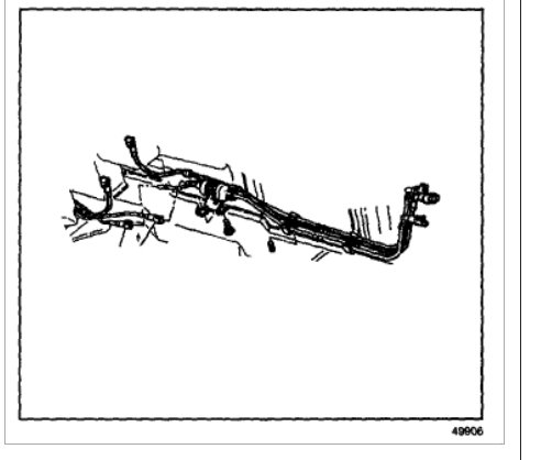

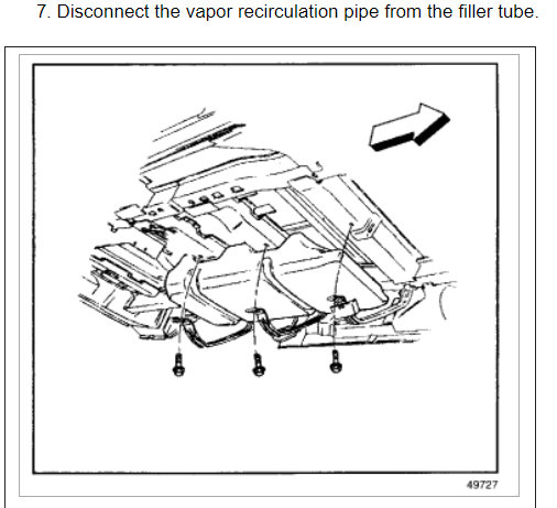

No, you have to drop the fuel tank. An access panel would have been a good idea, but they never did it. I have heard of people "cutting" one in, but I would not recommend it.
Here is a guide to help and diagrams below to get the job done:
https://www.2carpros.com/articles/how-to-replace-an-electric-fuel-pump
Cheers
