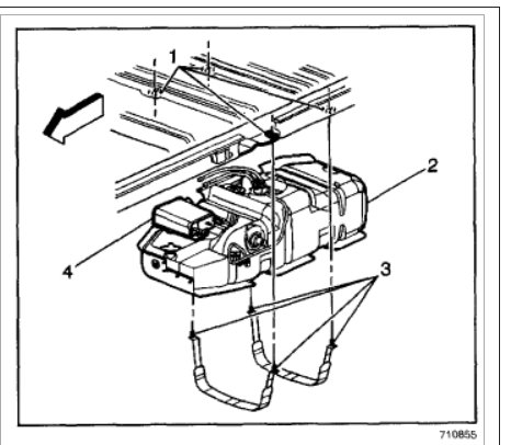

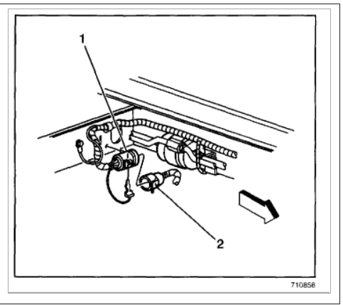

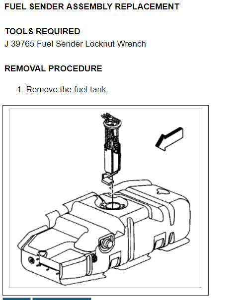

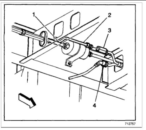

Does the 2004 Pontiac Montana van have an access panel to change the fuel pump?
Aug 14, 2009 at 2:56 PM
DOCFIXIT
  • 18,828 POSTS
You will need to remove the fuel tank here is a guide to help walk you through the steps and diagrams below to show you how to do the job on your car.
https://www.2carpros.com/articles/how-to-replace-an-electric-fuel-pump
Aug 14, 2009 at 3:10 PM
DRIIS
Engine Mechanical problem 6 cyl Front Wheel Drive Automatic 128000 miles

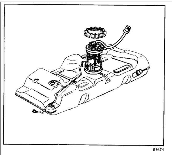

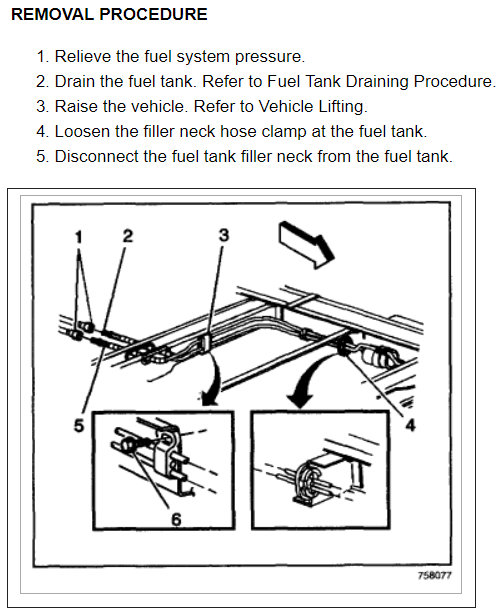

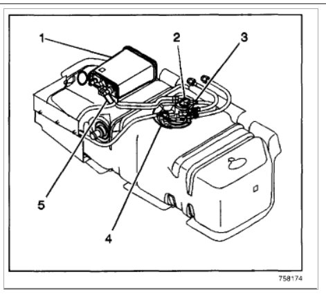

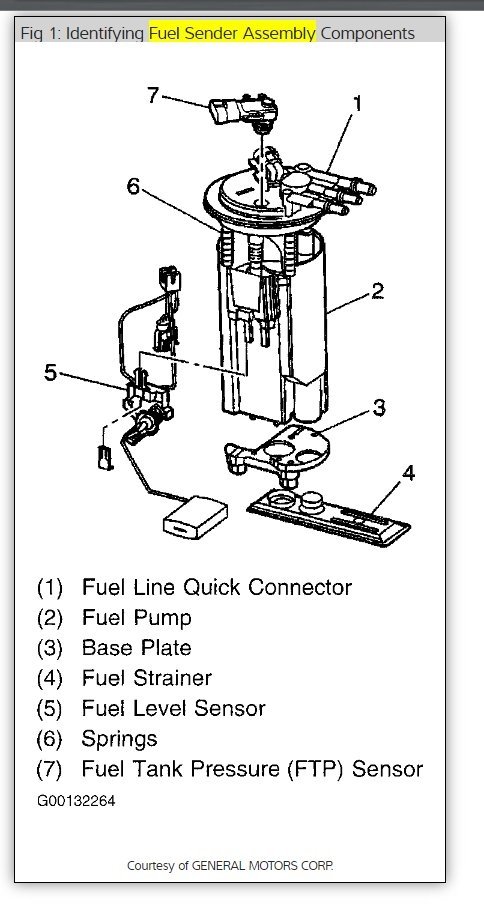

how do I replace a fuel pump in my Montana? Do I need any special tools etc? I was told it is in the fuel tank. My gas gauge has not been registering the correct fuel amt for quite some time. I started it the other day and it was running rough then just quit and will not start. I replaced the fuel filter but still will turn over but won't start. I believe it is the fuel pump.
Jan 7, 2019 at 9:07 PM (Merged)
  • 54,858 POSTS
Yes the pump is in the tank it takes no special tools to change. You will need to lift the car to get started and its best if the tank is low on fuel.
This guide will give you an idea on what you are in from when changing the pump
Here are some diagrams for your car (below)

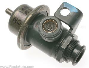

2001 Pontiac Montana Engine Size unknown Front Wheel Drive Automatic 150000 miles
Theres a vacuum part on the right side of the engine that has fuel going through it. I know because it what is causing me my problem. When the fuel pump comes on it is leaking fuel. What is it and how do I change it.
MASTERTECHTIM
  • 4,750 POSTS
it is your fuel pressure regulator and it is simple to replace, all you need is a pair of snap ring pliers. feedback and votes on me are greatly appreciated.
DISISJC
  • 18 POSTS
[quote:3e7d385904="mastertechtim"]it is your fuel pressure regulator and it is simple to replace, all you need is a pair of snap ring pliers. feedback and votes on me are greatly appreciated.[/quote:3e7d385904]
Tim,
Thanks for your reply
I don't believe my part has a snap ring on it unless it is underneith somewhere. It looks like it has a big nut on the bottom.
DISISJC
  • 18 POSTS
I went to Rock and found a picture of the regulator.
https://images.2carpros.com/forum/automotive_pictures/145123_pontaic_montana_1.jpg
Do you thing the end with the o-ring is just pushed into the fuel rail. Its very close around the part. I'm not sure that I will be able to get to the bottom nuts.
MASTERTECHTIM
  • 4,750 POSTS
yes that is exactly it. yours is held in with a torx bolt. just undo the fuel line going to it. twist and pull out regulator. ***try to make sure you clean fuel from the fuel rail and put some lube on o ring of new regulator. the gas will swell the new o ring and make it difficult to get in.
DISISJC
  • 18 POSTS
[quote:8650f2f71f="mastertechtim"]yes that is exactly it. yours is held in with a torx bolt. just undo the fuel line going to it. twist and pull out regulator. ***try to make sure you clean fuel from the fuel rail and put some lube on o ring of new regulator. the gas will swell the new o ring and make it difficult to get in.[/quote:8650f2f71f]
Thanks Tim,
I bought the regulator at Auto Zone and installed--no leaks--
