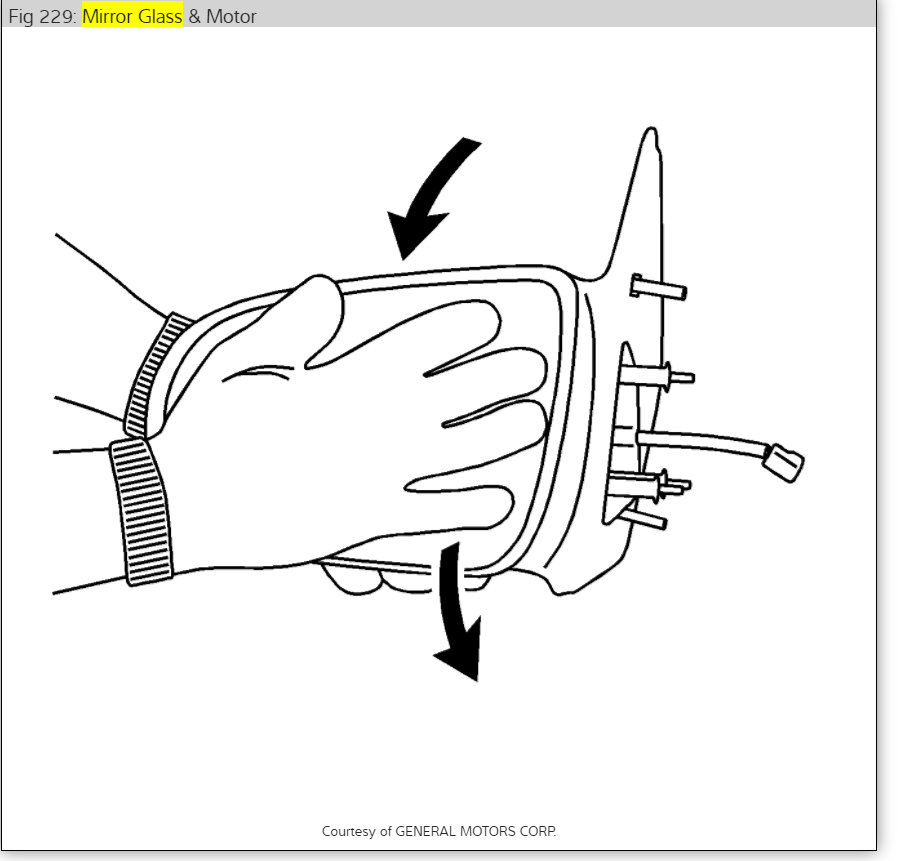

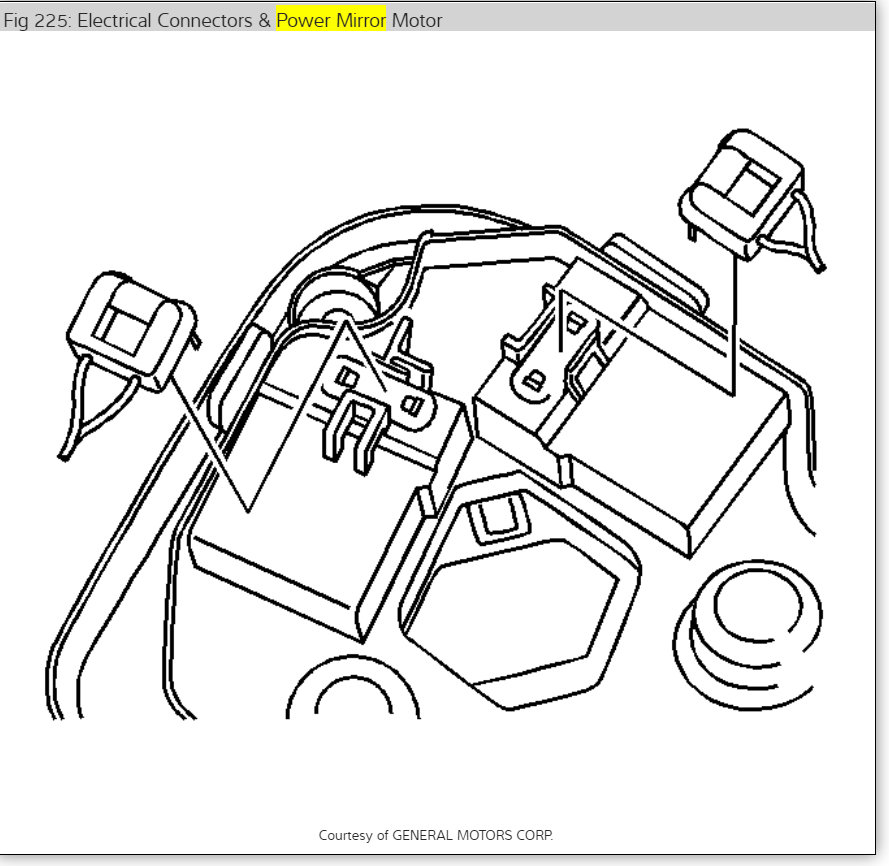

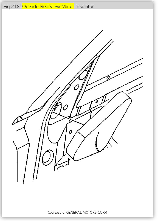

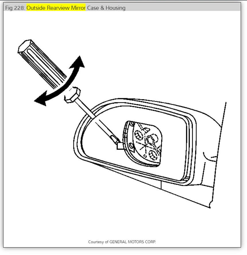

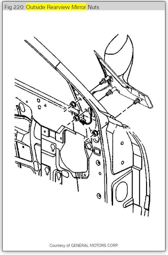

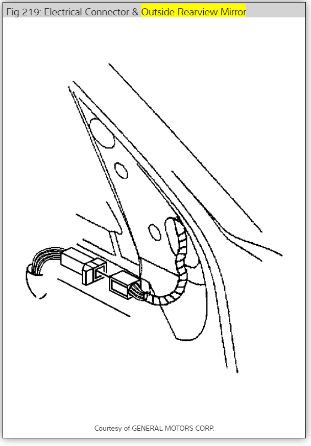

I think you might luck out...Book says remove door panel picture show only the small triangle shaped panel removed. A few pics to help, The one showing the glass removal, I try to push in on the bottom inner corner, this pops the top outer out enough to get your finger in there.
Here are some diagrams that will make it easier on ya (below)

Dang!! Well I didn't get as lucky as we first thought. That triangular piece is attached to the entire door panel. I did not remove the entire door panel but it would have been a whole lot eaisier if I would have. Just thought you might want to know. Thanks for the help the install was pretty easy besides a few scrapes from the door panel since I decided to just pull it back out of the way instead of removing it. Thanks again.

Hey I was wondering how the mirror is assembled. Does the actual mirror simply snap into the part behind it? In merlin's 3rd picture it appears to show a screwdriver behind the mirror to remove it.
My passenger side mirror broke, but the shell of the mirror is fine. It looks like I'm going to have to purchase the entire unit, but I don't want to have it painted so I want to be able to just use the guts of the part I buy.
I was just wondering if it is possible to remove the motor and mirror from a new shell and put it into the shell on my car without too many problems.

Yes the glass with the plastic base just snaps in! You can replace just the glass and leave motor shell and all alone...Most glass shops replace these mirrors for about 40.00...

You have to remove the interior door panel to replace the outside mirror.

Yes, just tilt the mirror all the way in and pull the glass out of the shell, then you can remove the works...
