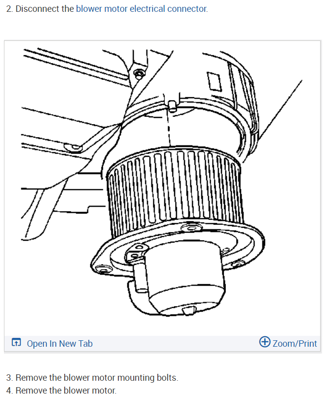

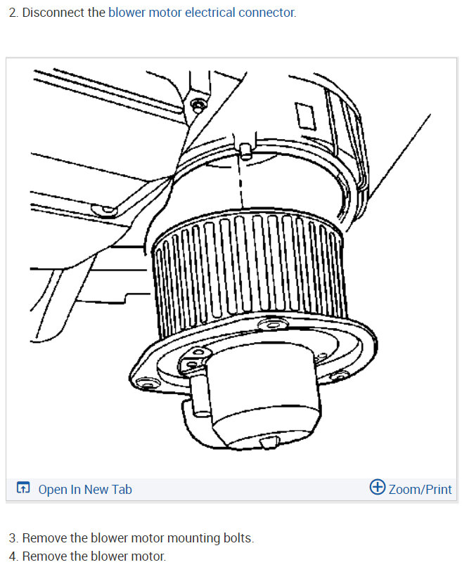

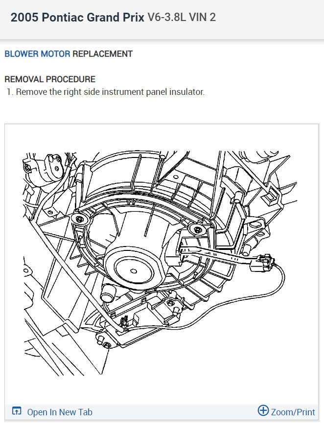

I agree with RASMATAZ, it sounds like the blower motor has gone out here is a guide the help test the blower power and ground and if they are okay I would replace the blower motor which is a common problem .
https://www.2carpros.com/articles/how-to-test-an-automotive-hvac-system-blower-fan-motor-a-detailed
