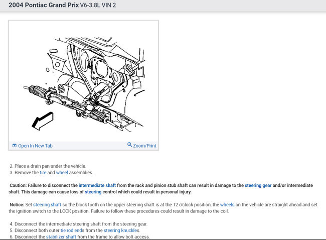

How can I fix the steering on my car. It is very difficult to turn to the left. Turns the the right easily.
Jul 27, 2009 at 1:31 AM
MMPRINCE4000
  • 8,548 POSTS

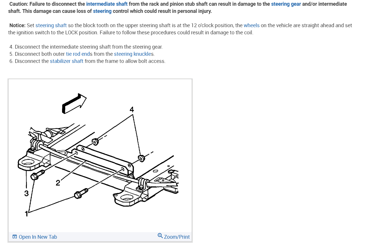

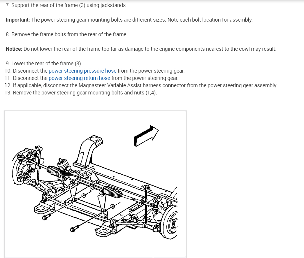

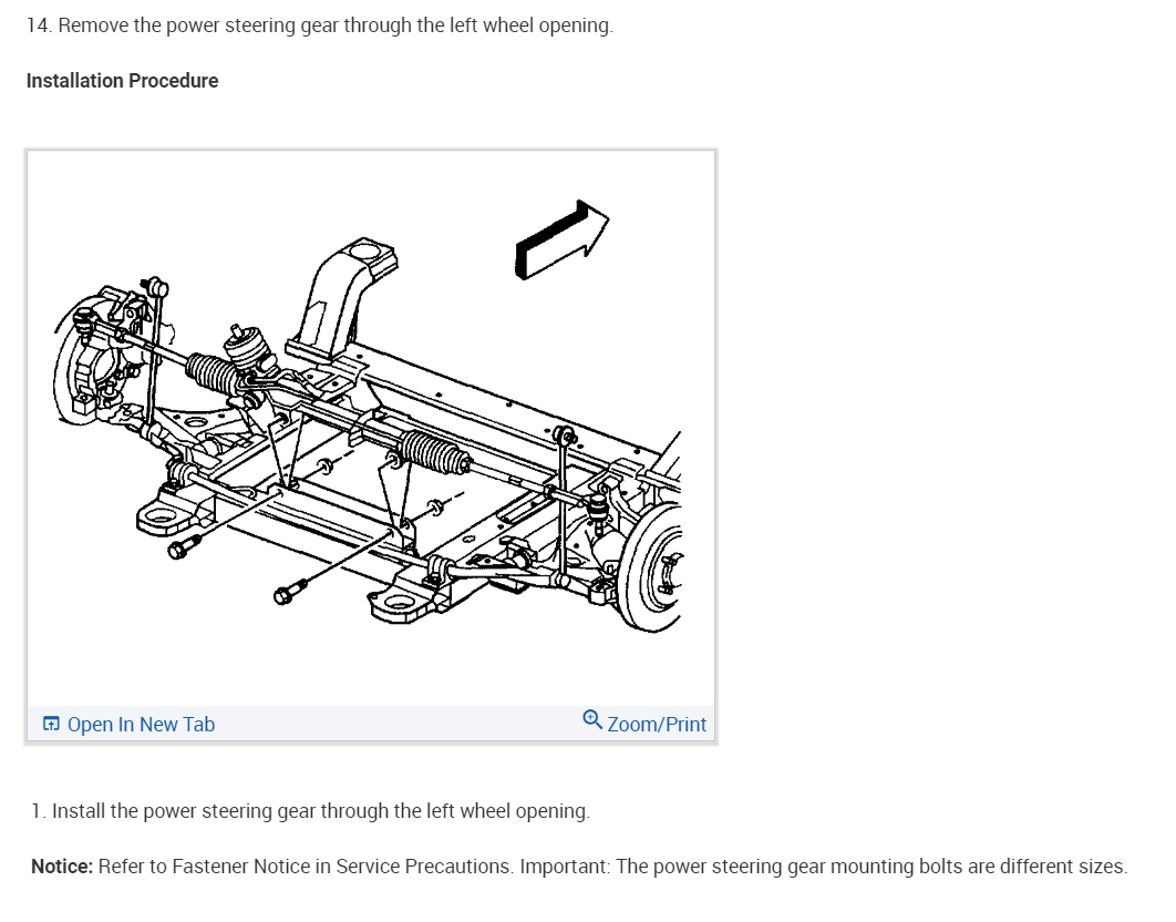

This is typical when the steering rack goes out here is are diagrams and instructions below to help you change it out. Check out the diagrams (Below). Please let us know if you need anything else to get the problem fixed.
