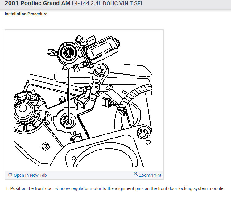

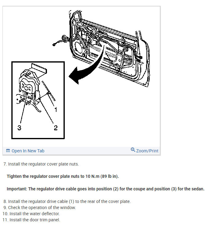

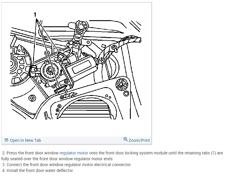

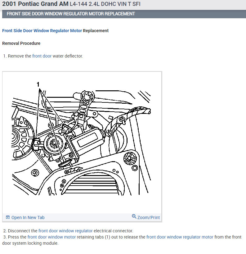

window regulator broke on the passenger side
2001 PONTIAC GRAND AM
80,070 MILES • 6 CYL • 2WD • AUTOMATIC
ALLIIRISH

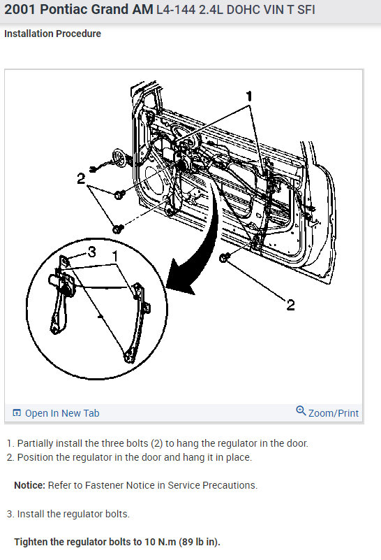

The window regulator broke on the passenger side front window and I need to know if they are bolted on or?
Mar 26, 2008 at 5:26 AM
SQM
  • 6,383 POSTS

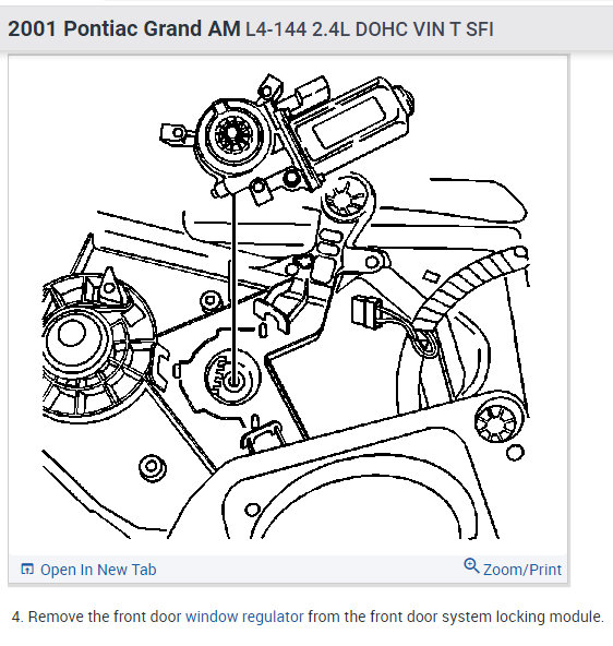

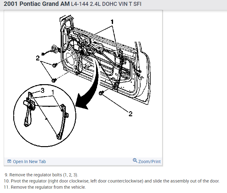

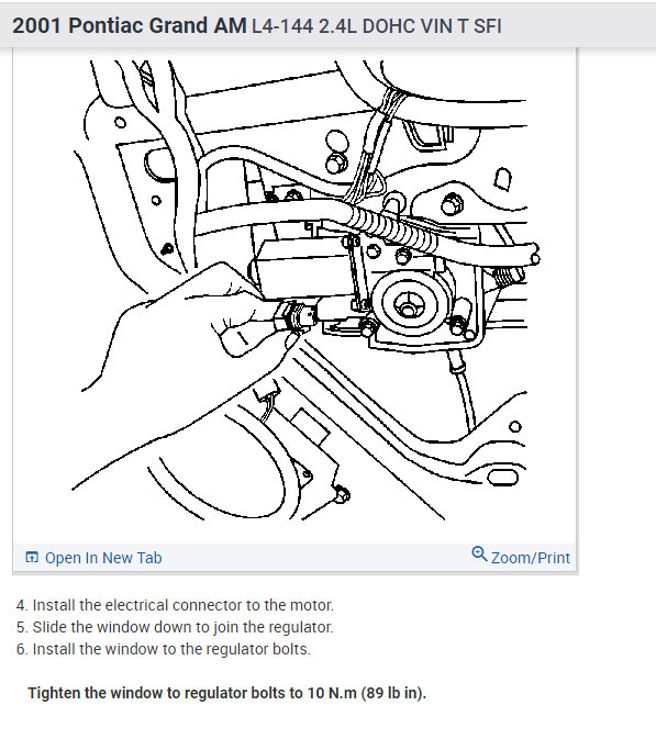

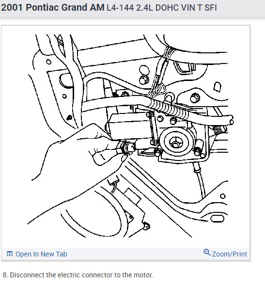

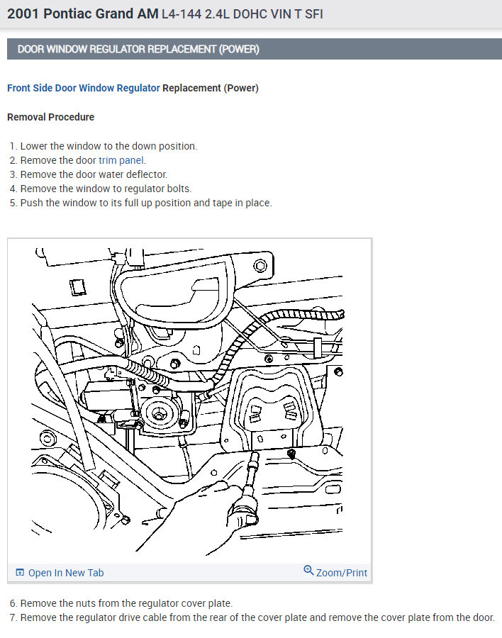

The window regulator moves the window up and down in a channel that guides it. Sometimes the regulator can come off the channel, when that happens you could have a window that goes up and down very slowly or stuck in a position due to too much friction due to being off the track.
In order to access the regulator you will have to remove the inner door panel. The door panel is mounted by few screws and plastic fasteners.
You should be able to take it apart by using simple hand tools.
You might find these articles helpful:
https://www.2carpros.com/articles/how-to-check-and-replace-a-electric-power-window-motor
https://www.2carpros.com/articles/door-panel-removal
I have attached the diagrams for your reference.
