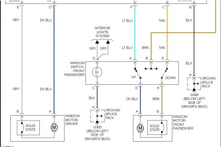

My right side drivers window will not go down. All of the other windows work. Where do I begin looking?

Your talking about the passenger side, front? It won't work from the master switch or the passenger side switch?

ROGERLEE
It works from neither switch

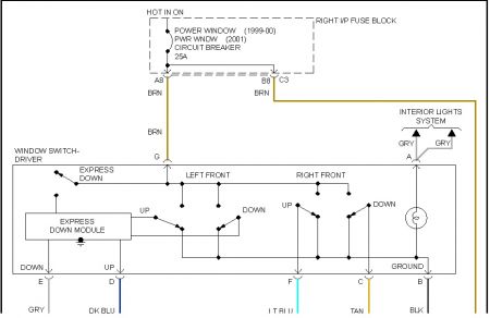

JDL
  • 16,098 POSTS
I'd have to check the wiring circuits. The two wires at the window motor switch between voltage and ground, depending on up or down. Maybe something wrong with the window motor, hard to tell from here.
