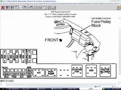

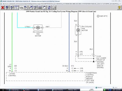

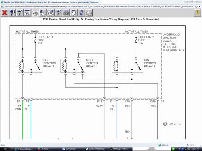

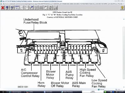

can you help me troubleshoot for diagnostic cooling wire diagram the fuses are good yet the engine still gets hot even in freezing weather with full antifreeze. i need a diagnostic wire diagram for cooling can you help me please.
Feb 15, 2008 at 11:16 AM
MERLIN2021
  • 17,250 POSTS
Do the fans work? Turn a/c on the fan should start, turn off a/c idle car till normal temps are reached, does fan come on? If the fan works check the thermostat, it's probably stuck closed, when it overheats, how hot is the upper radiator hose? If only cold to warm tstat is stuck!
